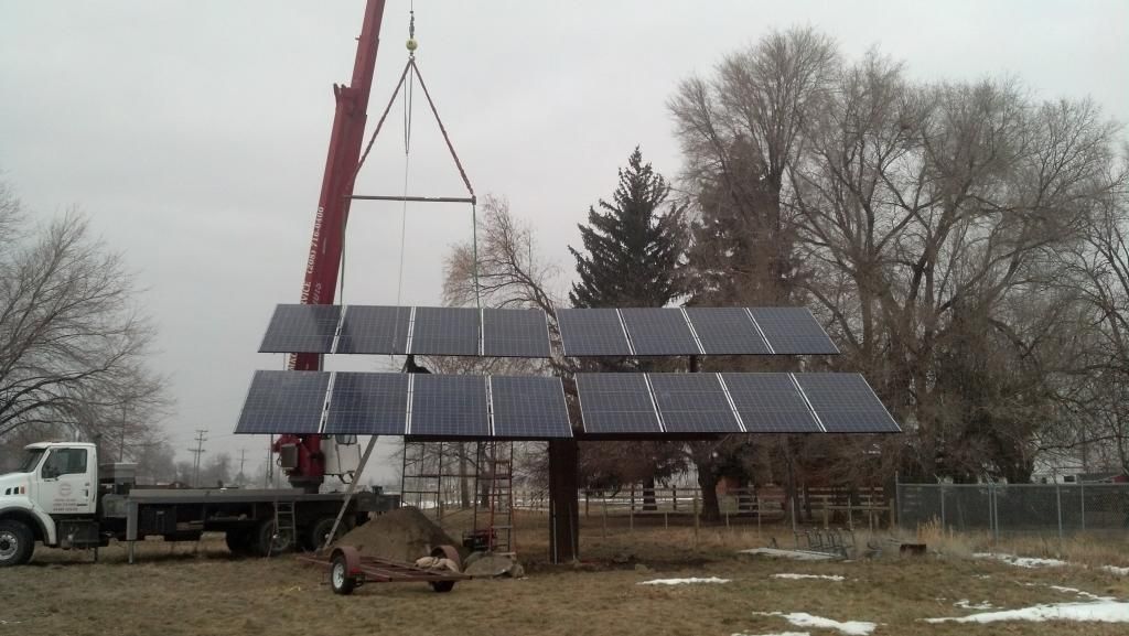

Denali: Good find on All Electronics =D> Good stuff there. to further illustrate the bigger is cheaper thing in PV prices, I sell locally 90 watt multi's for 160.00, so $1.78 per watt. All E sells the 20 watt multi's for 94.00, so 4.70 per watt. Again locally, I sell 255 watter's for 320.00, so $1.25 per watt. So going a bit bigger is much cheaper per watt, but more money overall I guess.
Nizina: Efficiency is one thing, bang for the buck is where the rubber meets the road, and for me and my suppliers multi crys. seems to be the clear winner. I look for a 20 or 25 year factory warranty (in other words any name brand panel, as opposed to Harbor Freight type junk) and then the best pricing per watt. Whether they are 14.8 as opposed to 15.2 % efficient is of little concern. Also frankly, I trust my long time suppliers, and what they buy a boatload of (or several containers anyway) is what I buy from them as I can't beat the pricing elsewhere, and it's always multi crys. I don't keep a real close eye on the research on new panels, until I can get them at a lesser price PER WATT, and my suppliers have them in stock and ready to ship, it's all pie in the sky, make sense?
Idaho mo gas fuel tax rebate: I got reamed out by the state tax commission two years ago, the full anal exam. What started out as an examination of my plane gas turned into an exam of the crane diesel receipts. Like a dumb ass I only had credit card receipts, not the actual paper slip that comes out of the frigging pump, THAT'S what they want to see #-o I learned my lesson, it seems to be better to keep a low profile with those folks! So, I don't mess with it anymore, ain't right but they have the power to make it more hassle then it's worth. I did it for several years, like flyer is doing it (more power to ya) but once audited I was told there was more paperwork involved (quarterly forms, blah blah blah) then I wanted or needed to mess with.
Pic below is 4 of the 3060 watt arrays, all mounted on one 26" dia. pipe, so 12,240 watts @ 378 volts VDC, the grid tie inverter converts it to 240 VAC, by far the biggest I've done yet on one pole. Like the guy with a hammer thinking every problems needs a nail, my solar jobs somehow seem to need a crane. For a guy who owns the Tesla I got to drive a couple weeks ago :shock: Image
