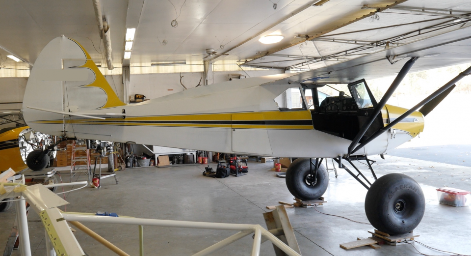

Is your Pacer still apart, and (I assume) down at Steve's?
The before pic looks like it was a pretty darn nice airplane,
what prompted you to tear into it?
Posts: 10612
Re: Show Us Your Before-and-After Mod Pics
hotrod180 wrote:Image
Logistically it was getting harder and harder for Z to fly out here commercial for a week or so once a year to get anything really accomplished on the project. So the decision was made to move it to Minnesota.
Modifications to the airframe included extending the skylight to our long version, weld on float fittings and installing both left and right seaplane doors. With as much fabric that was removed to do those mods it became apparent that re-covering the entire airframe was just as easy as patching what little fabric was left on it. Besides, the fabric was well over 30 years old and it sat outside for years. Once the fabric was off we discovered some corrosion in the window frames that needed replacing and a few other minor issues that were best fixed with the fabric off.
Anyways, that all I can say about it. Z is still keeping me in the loop as far as advice and general BS chat. :D

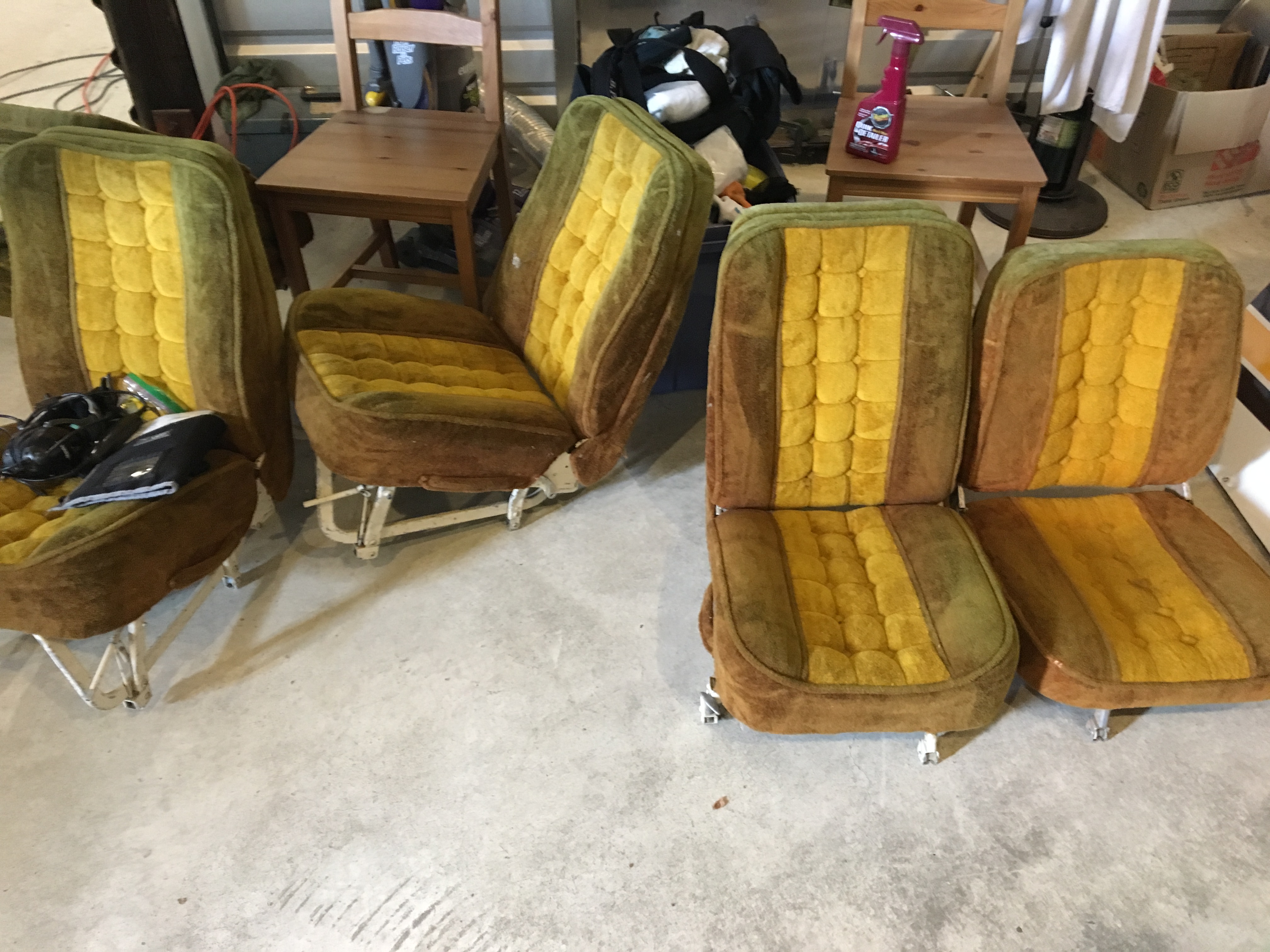

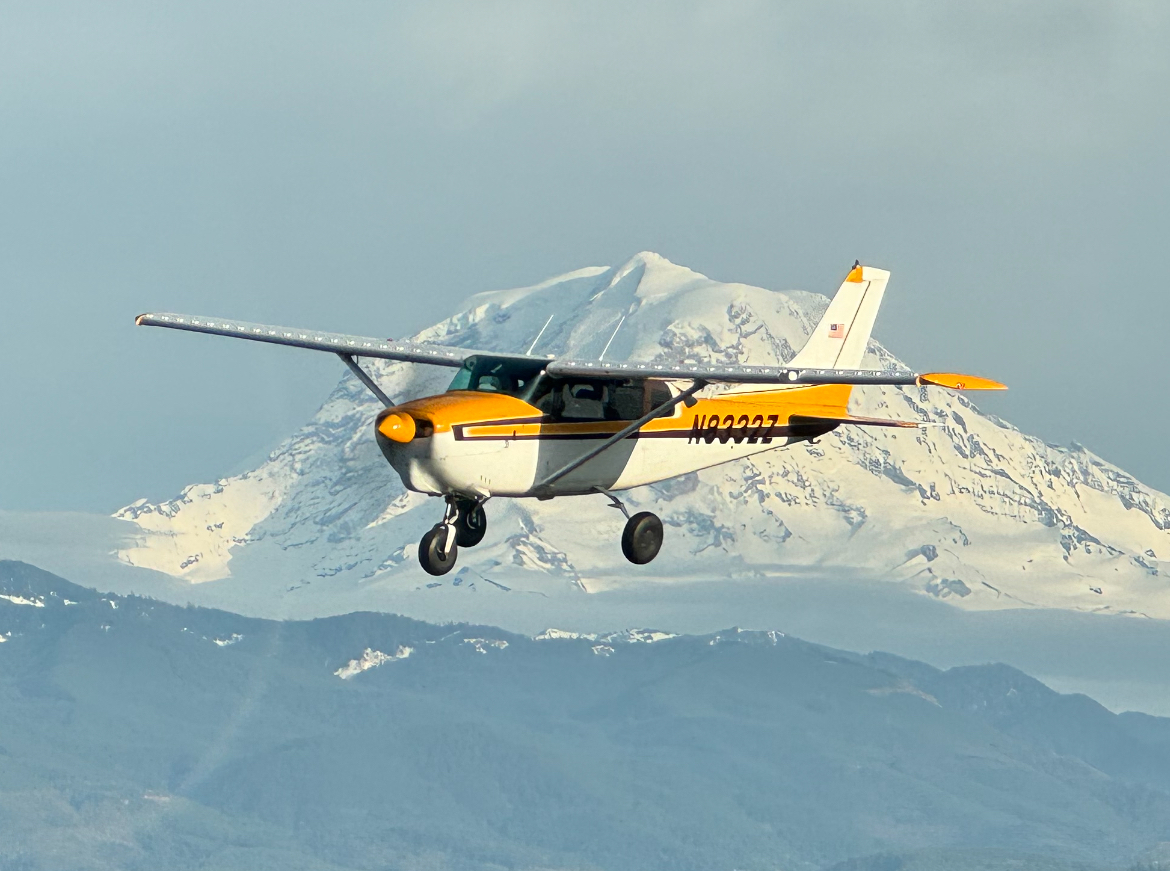

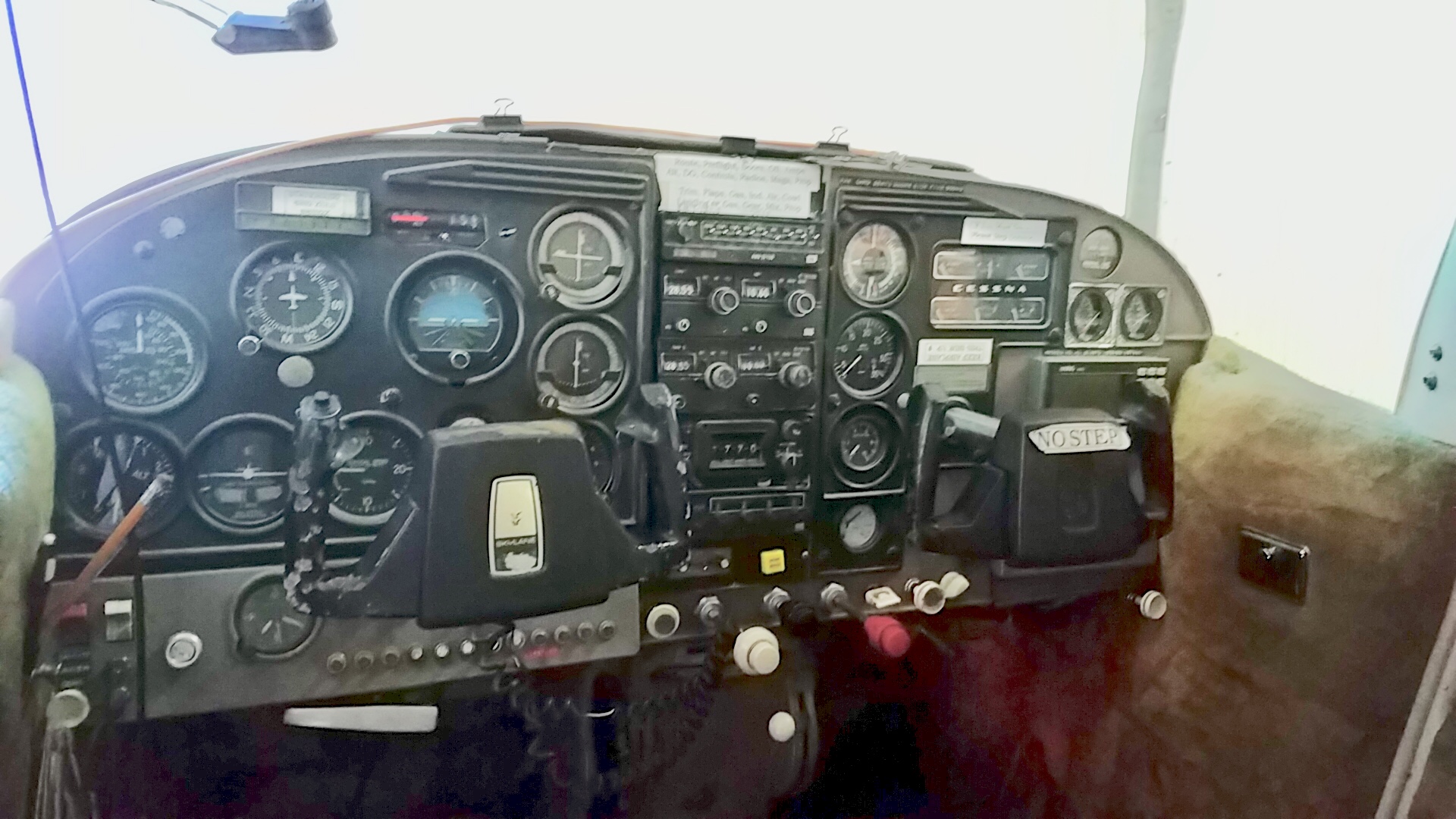

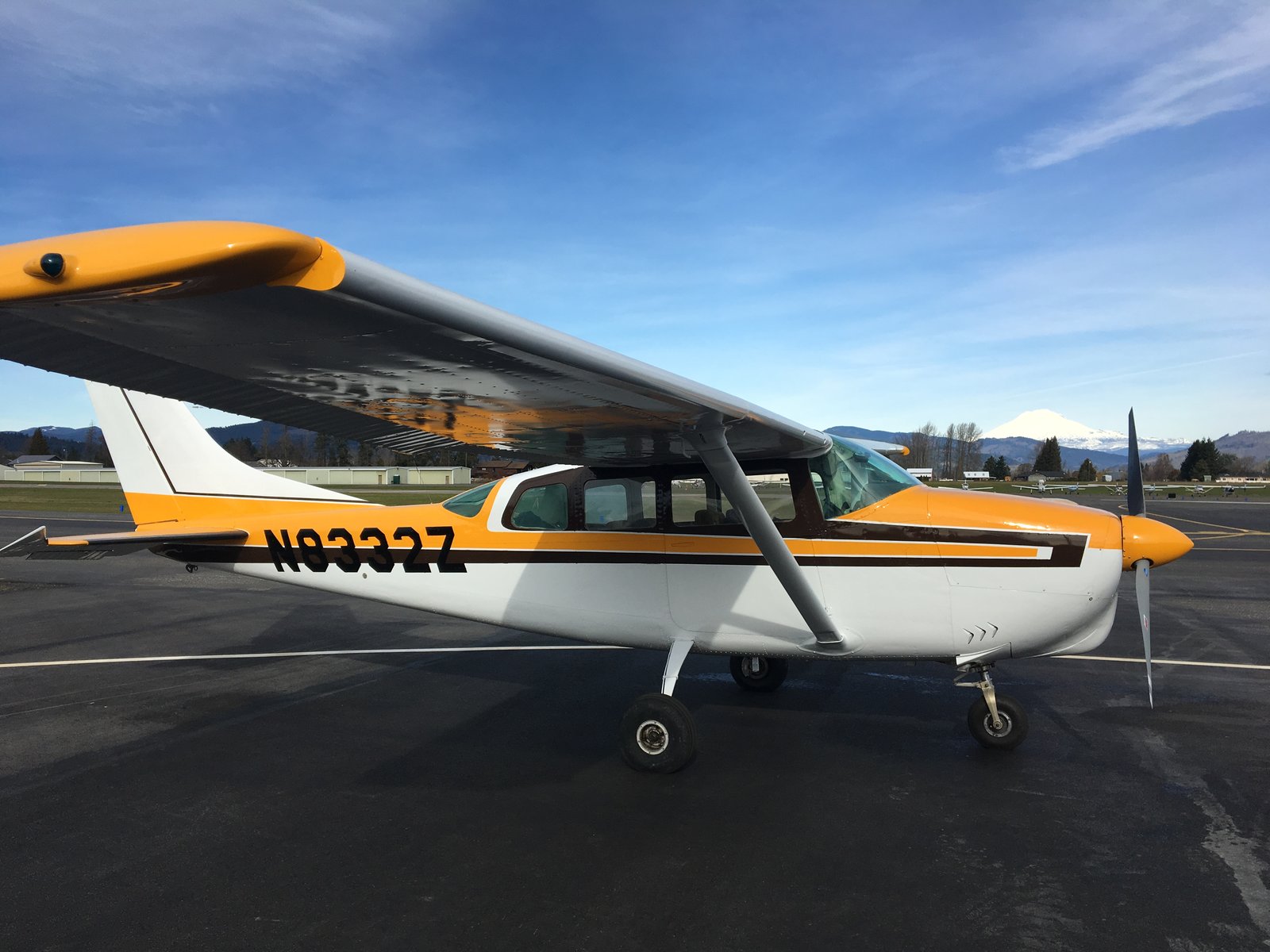

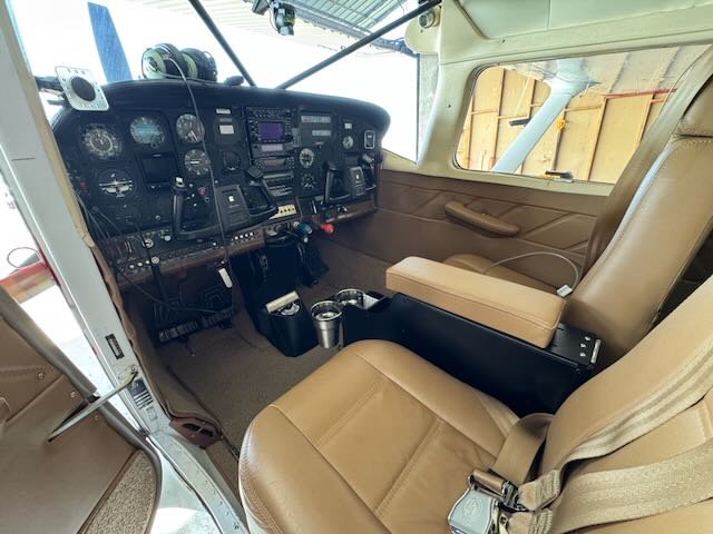

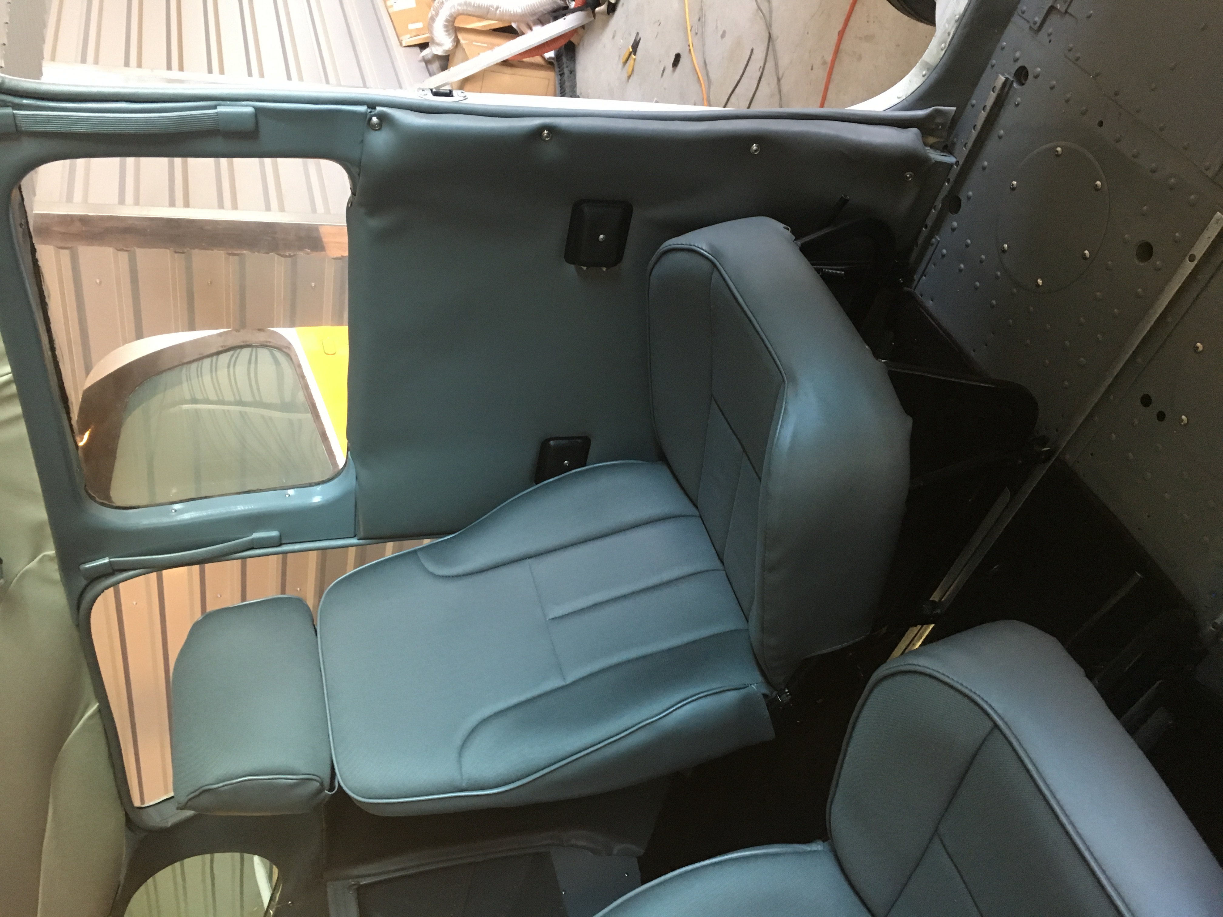

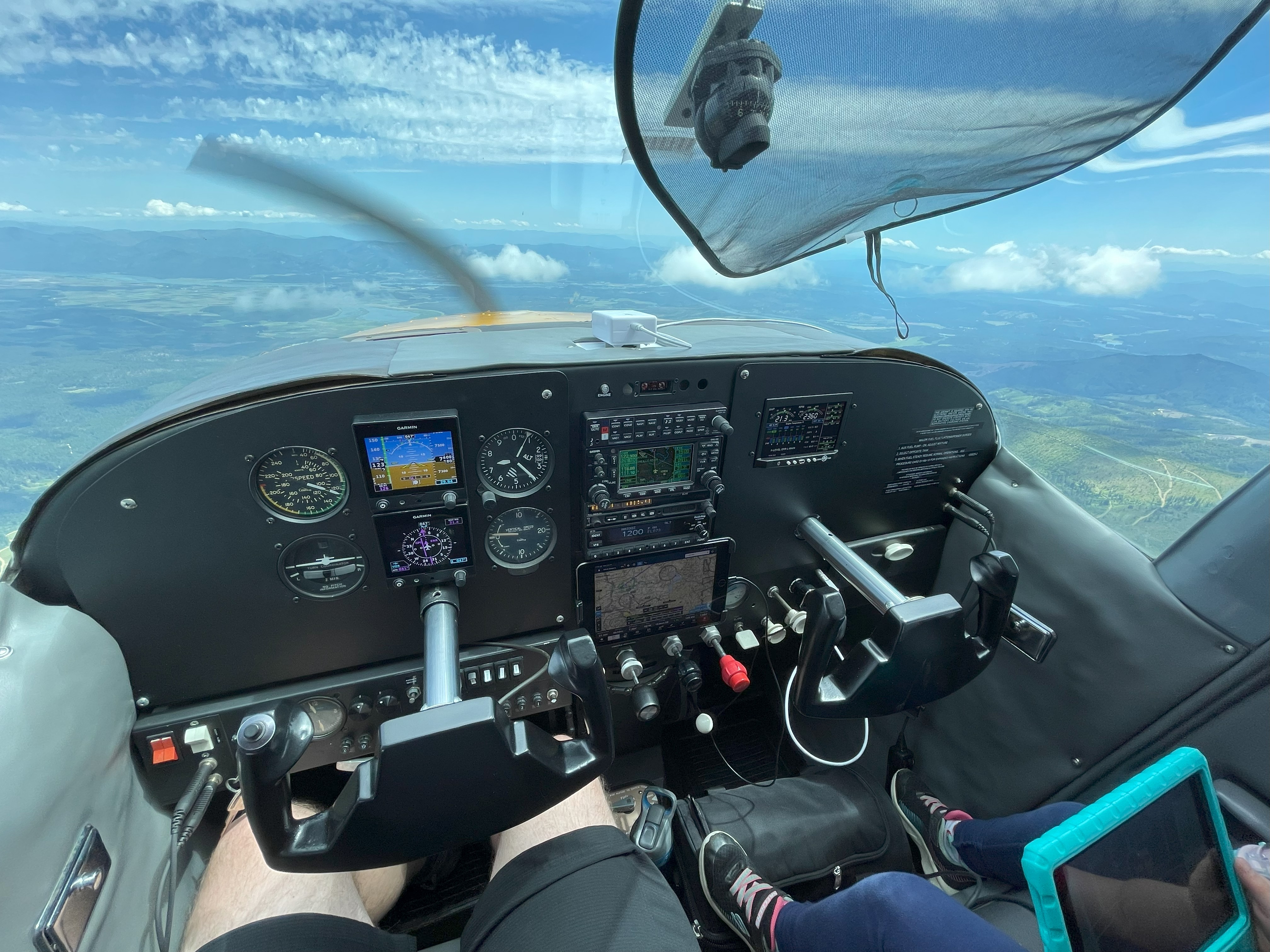

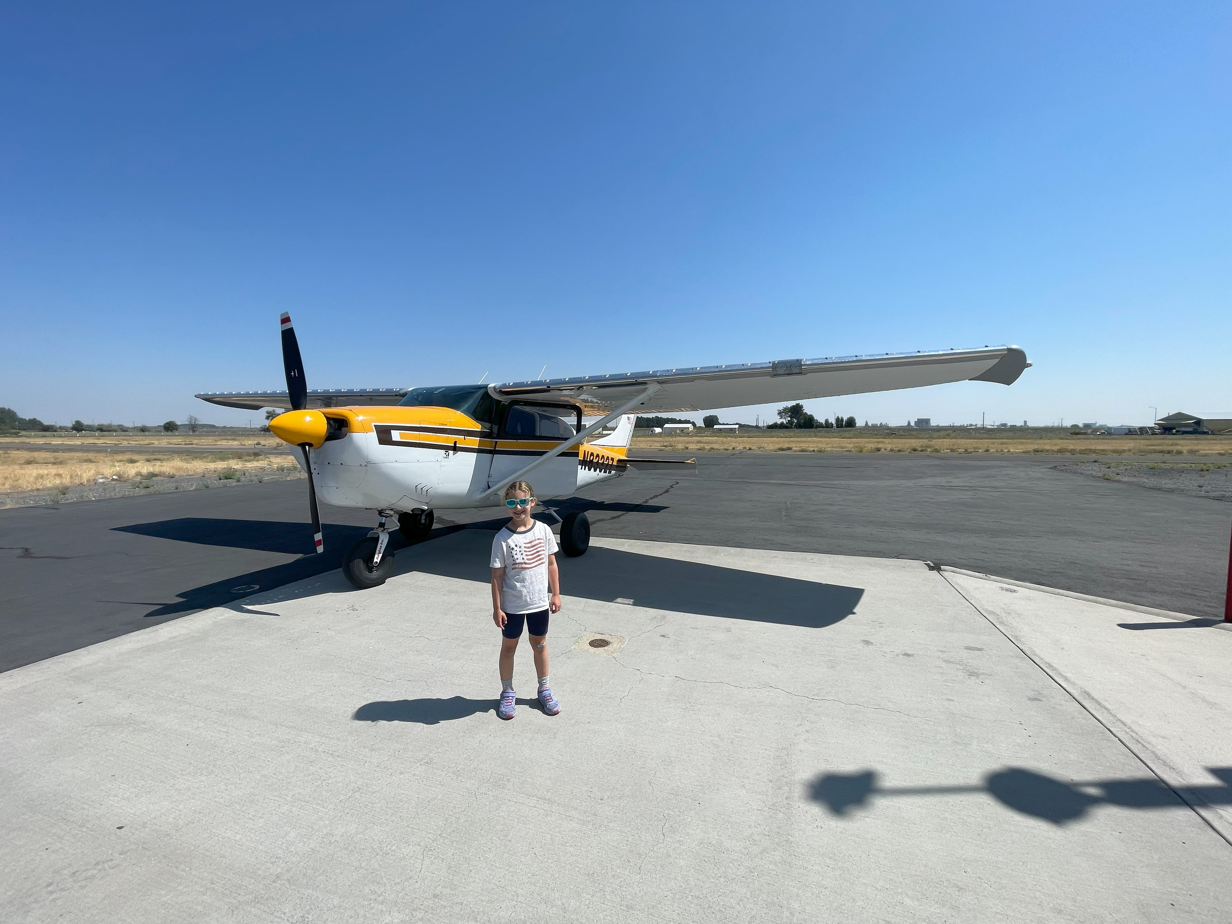

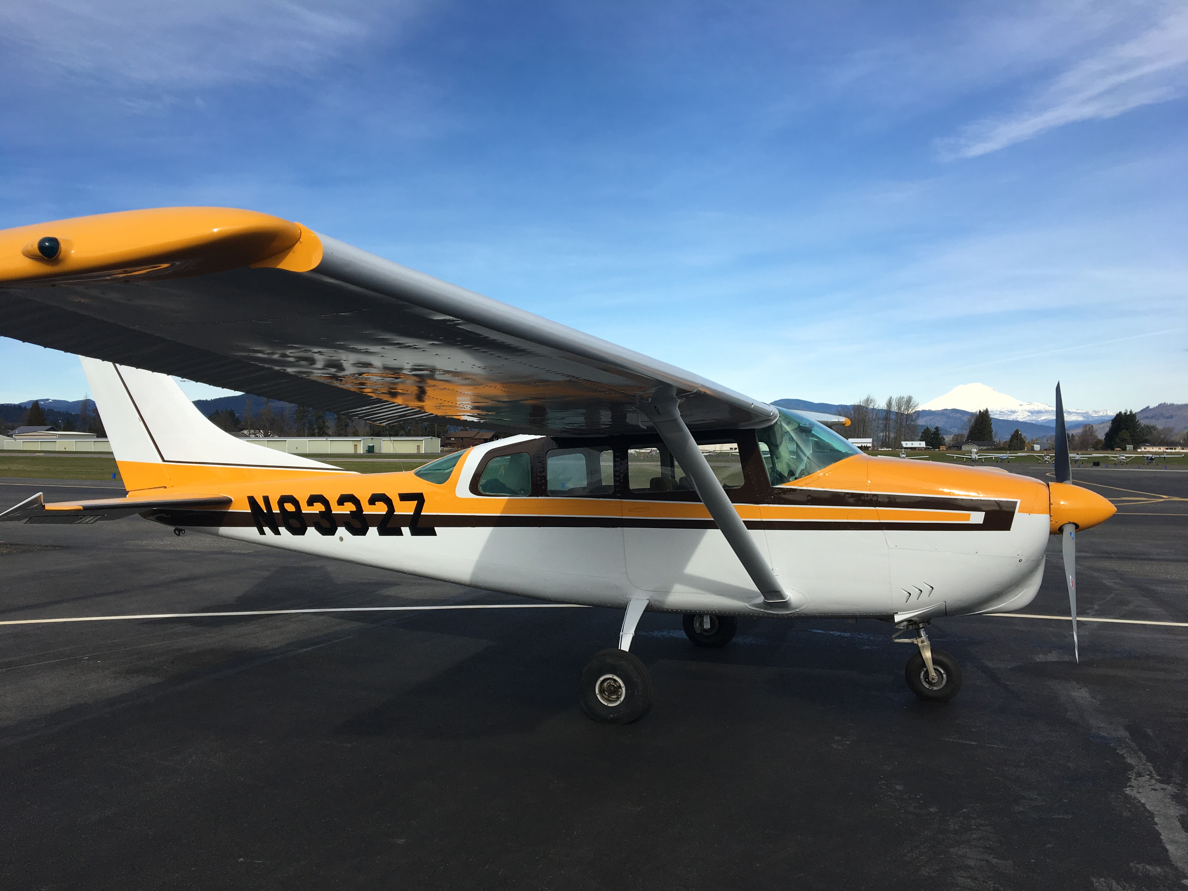

I've come a long way with the Cessna 205 I picked up in 205!
Cessna N8332Z when picked up Jan 2018
Panel 2018
Interior 2018
First panel overhaul left side done July 2018
Rainier in the back, big tires & VG's
Interior post 2018

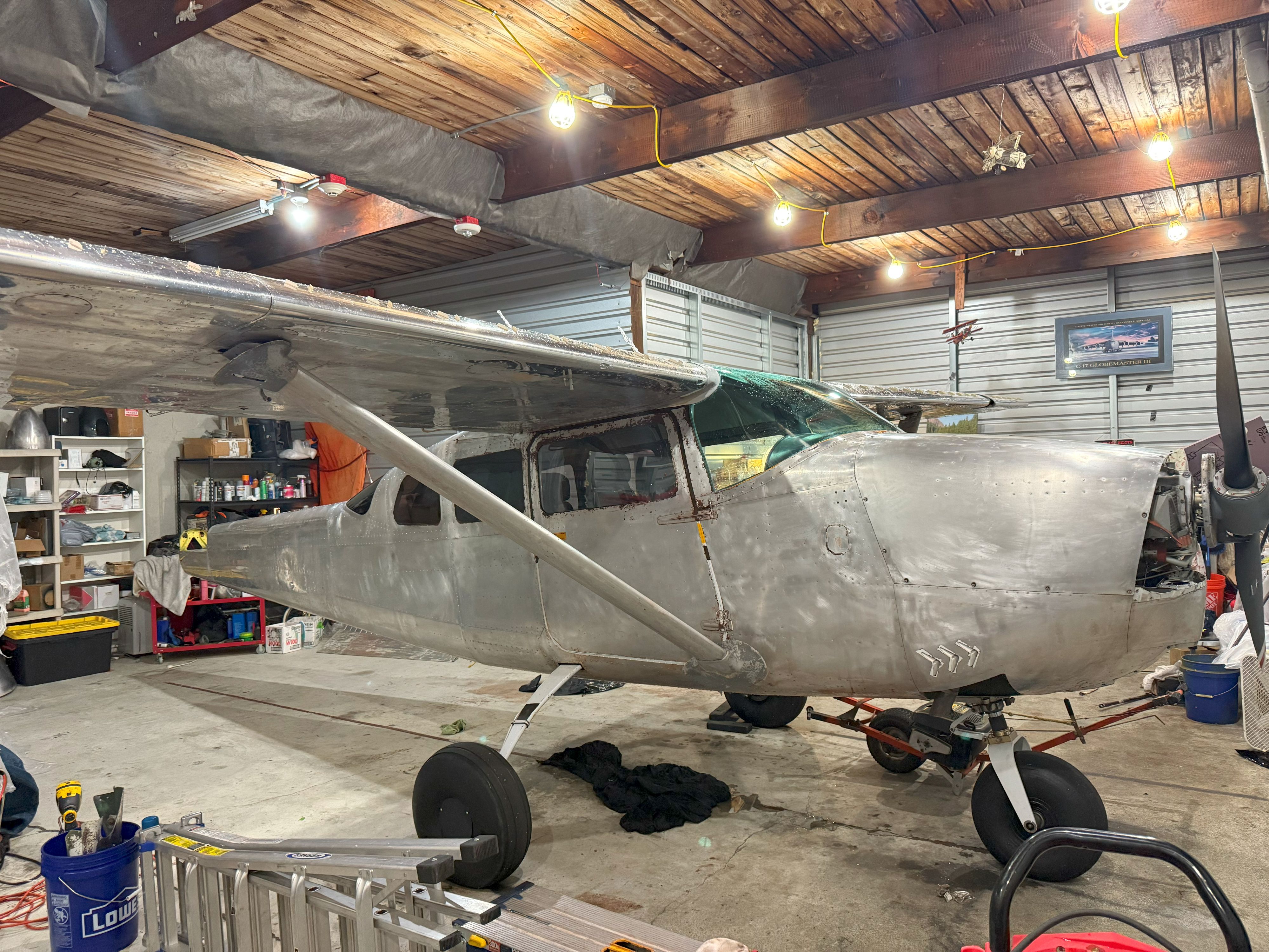

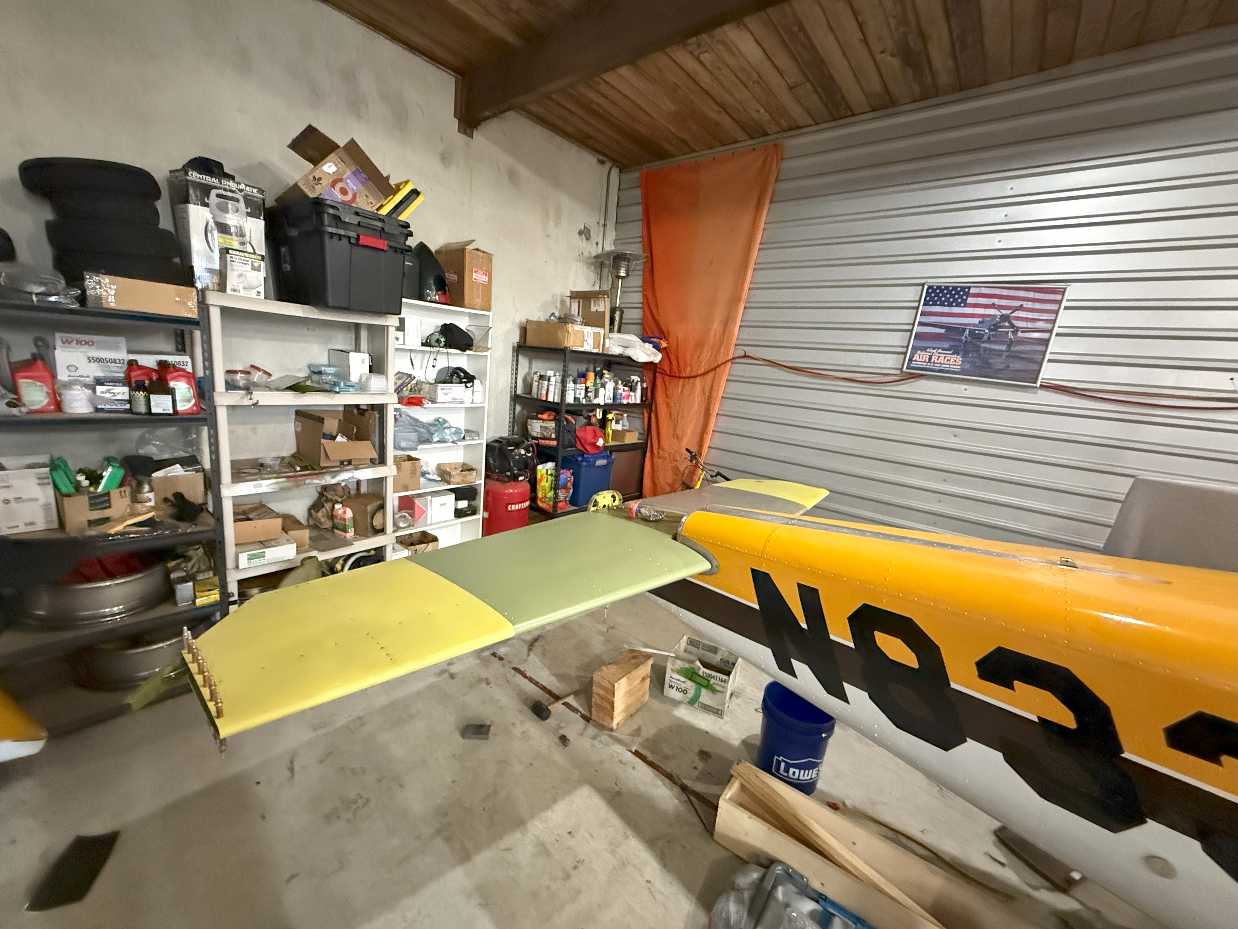

In 2020 I had a prop strike due to sinking into the sand. I rebuilt the engine and redid all the electric along with adding a JPI EDM 900.
in 2024 I added a sportman STOL cuff
in 2025 a rim fell off a shelf and damaged my elevator. I ended up down a rabbit hole and discovered some issues with the stab, so I ended up rebuilding it entirely. That was fun..... Then....I wanted to increase my pain. So I stripped the plane down to bare metal.
Panel 2021
in 2024 I installed the sportsman
stab rebuild
stripped down mostly

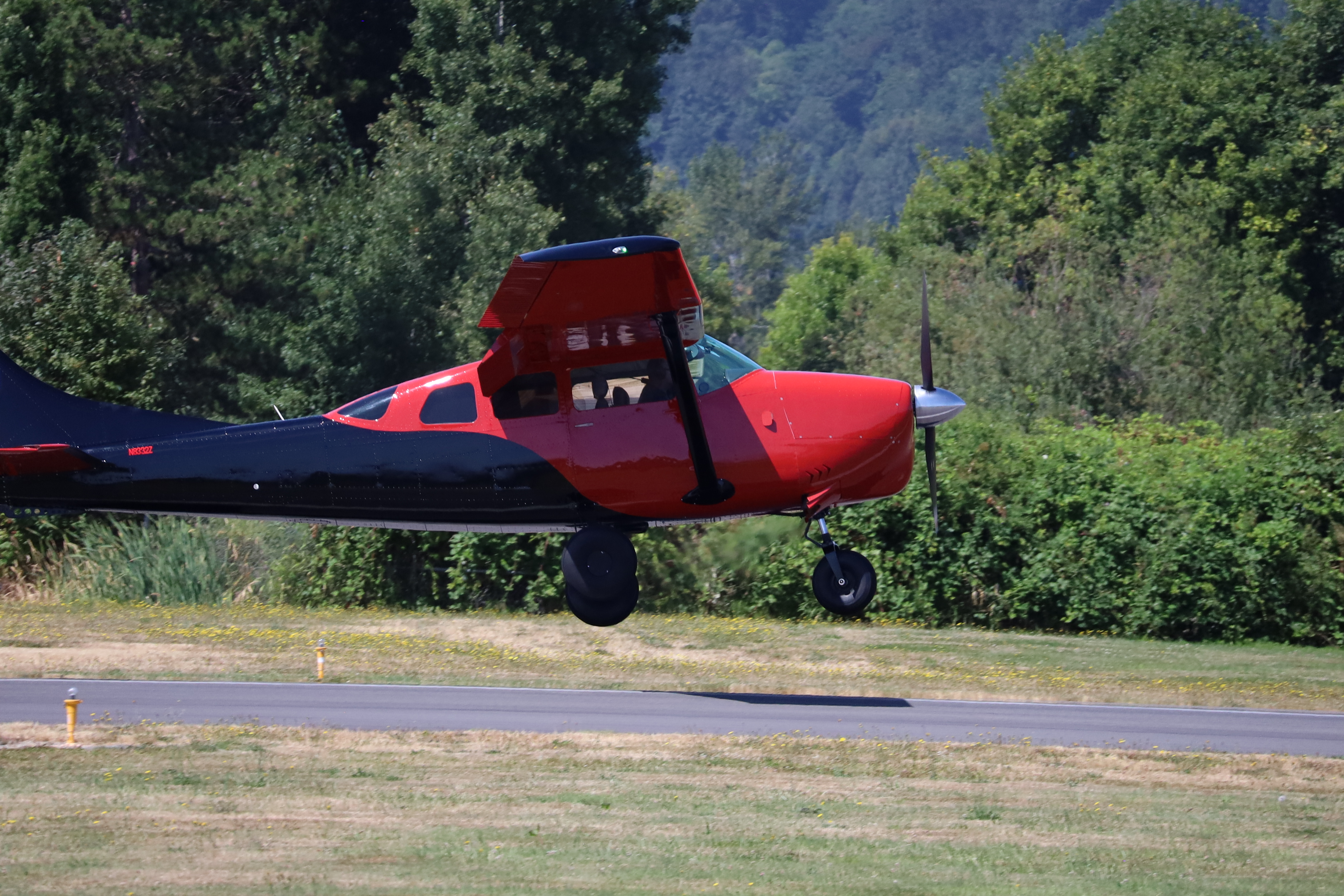

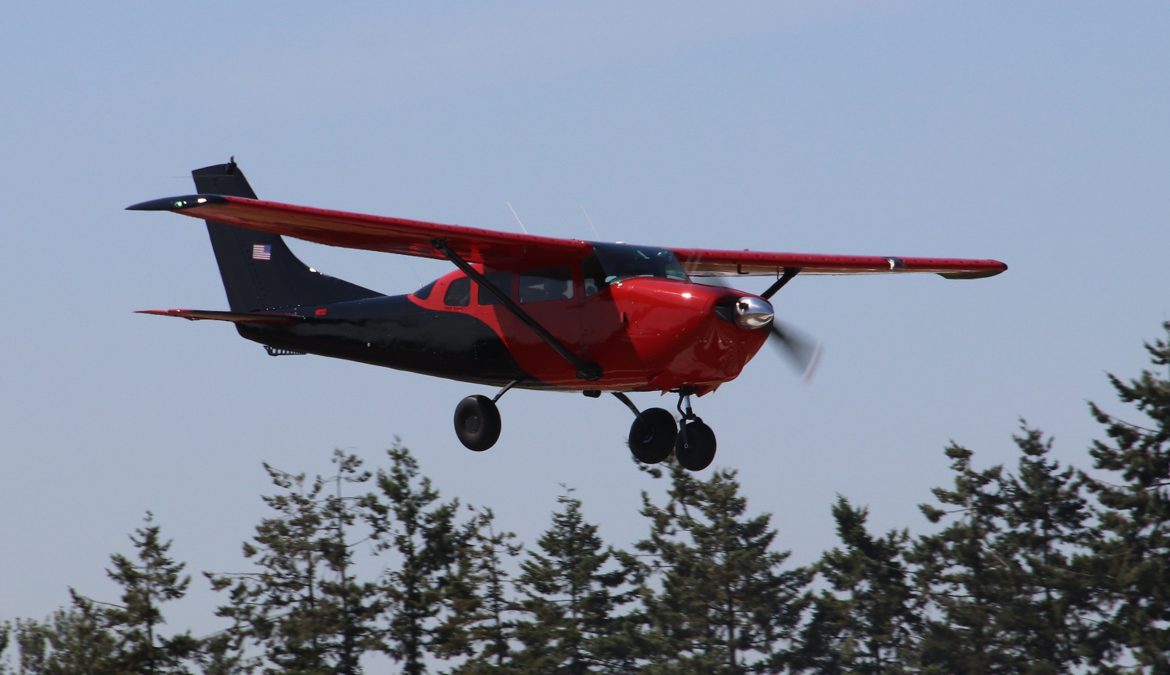

Does this scream Mooney 2.0 ?? haha "Moonboy!" She's red and black! And I love it. New larger N numbers coming when I get the N number change completed!
Painted!
July 2025

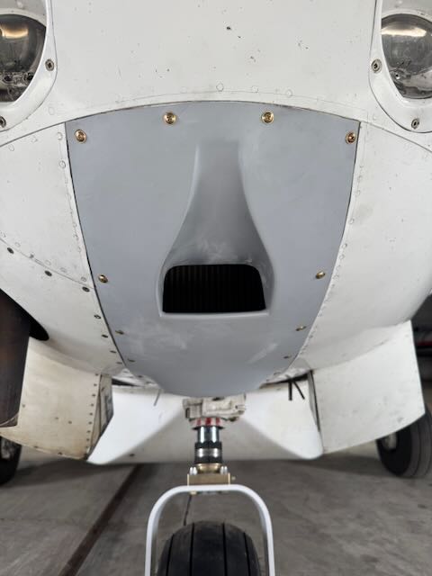

No before pic, but I'm pretty sure everyone know's a cessna cowl looks like. Making progress on fitting this panel to finalize my oil cooler relocation. I'm really excited to see what it does for #5 and #3 CHT. I need to do a little bit of fiberglass work where a couple of the holes had to be elongated, then I'll hit it with paint. Going to paint new Stene strut fairings while the paint is mixed.
That and finally got the Airglass fork and 8.00 installed. Now 18.5" of clearance between the floor and prop tip with the factory recommended 80PSI in the strut at full extension, which comes out to 3" of exposed strut at rest. The plane is definitely more raked, but that may be a good thing for takeoff roll.

Do you have the cowl flap extenders on there ?
low rider offline
Posts: 793
Location: Tahoe
vail
Yeah this plane spent some time in PNG as a missionary bird so it’s got extended cowl flaps, flap switch relocate, flap dump switch, and a couple of other nifty STCs.
CParker offline
Posts: 515
Location: SMN
Aircraft: 1979 TU206G
CParker wrote:Yeah this plane spent some time in PNG as a missionary bird so it’s got extended cowl flaps, flap switch relocate, flap dump switch, and a couple of other nifty STCs.
On the 185 at least, with the factory cargo pod, the cowl flap extensions were part of the kit, and required.

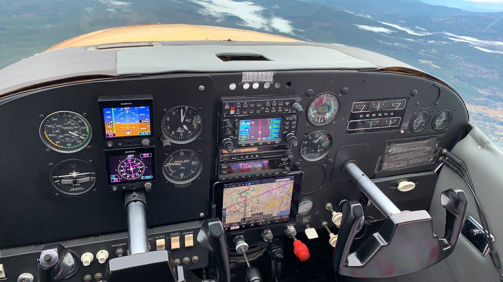

I'd love to see the flap dump switch setup.
Posts: 5219
It's a push button on the left grip of the yoke, gotta zoom in a little bit it's the only pic I have with it in view.
CParker offline
Posts: 515
Location: SMN
you can wire a trim controller on the RH ride of the yoke to be your flaps. not sure the legality. but ive seen it before

That is such a great idea for the oil cooler. How are you getting that approved? I’m excited to hear how it works out.
Your center console looks nice also!
