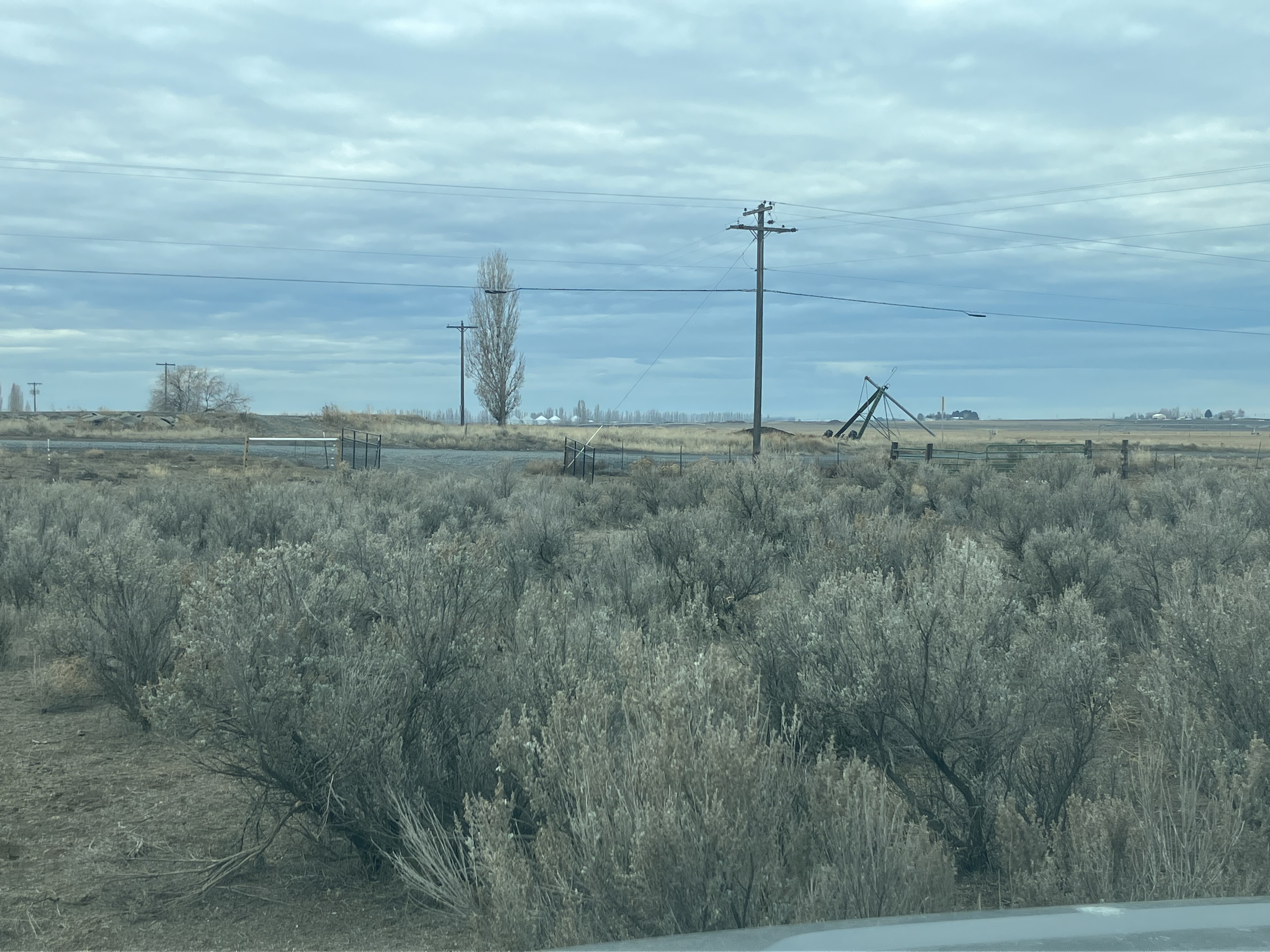

I have 100 acres of dry ground around my house that we just use for range ground for some sheep, and I’d like to grade out a dirt airstrip. It’s overall a half mile east-west and about 1,950 north-south, with fence all around it and a power line on the south and west edges.
Obviously the longest runway would be generally east-west, but that’s the way it’s least flat. There’s probably a 20’ rise as you move from the west edge to mid point, and 15’ of fall from midpoint to the east. North-south it’s flat on the east and west edges, and rolling terrain through the middle.
I think my longest line (red) that’s nearly flat would be 2,070’ from power line to fence, according to google earth. It can likely be graded to within a foot or two elevation difference from end to end. It’s over a half mile to be near any houses close to the extended centerline.
Next best flat-ish possibility (blue) would only gain about 100 more feet of length, with the added disadvantage of a neighbors house only being a couple hundred feet off the extended centerline, 1,200 feet beyond the fence. It’s probably within a 10’ elevation range from end to end.
The longest passable(?) line (green) is about 2,800 feet long and would go right over the rise and fall described earlier. I am concerned that sheep could be really hard to see over the rise if they get on the runway, and the terrain could make for some pretty roller-coastery takeoffs and landings.
Given all that, which line would you favor?
How concerning is the power line at the end of any possible runway? I think it could get very expensive to try to get a line buried. How much useable runway length do you figure is lost to cross over a power line?
According to the county it’s going to be about $2,500 in permits, and though I can do the grading myself, that’s also not free, so I’d like to make a strip I can be happy with on the first try.
Let me know what you think.

It’s 6 nm north to an airport with good long runways, avgas, and IAs.
The wires at the end of the runway would not be ones to go under… terrain slopes up slightly to the road, and with the newly added fiber optic cable below the original wires, there’s not much air between it and the top of the fence. I’ll attach a picture near the end of the red line looking southwest.

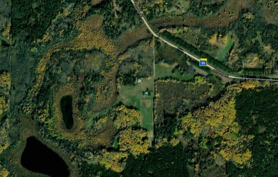

I was flying an O-300 powered 172A in and out of my strip which is around 1600' end to end (usable). My field elevation is 1500' but not the high heat you probably get. Being in north central MN it can get hot and humid with high DA, but it is only a few weeks out of the year.
I only had one area where I could put in my strip due to wetlands (highly protected) and terrain. Mine is similar to yours as far as a rise in the middle.
Not as much as you (10'+/-). The predominate direction for runways in my area is 13/31 meaning the winds are mostly out of the northwest. My strip orientation in Northeast/Southwest which means I deal with nearly 90 degree crosswinds frequently. Both ends of my strip are tall pine trees with the SW end having a hill with century old pines, almost perfectly aligned with the strip, when landing to the NE.
I'm thinking, if you are comfortable and proficient in your plane, all of your choices are do able. Go find a place with similar terrain and practice with the plane in the configuration you normally fly. That's what I did before the first landing on my strip. I had zero problems landing in about 1/3 of a 2000' strip and that was not trying to land as short as possible, just a leisurely average landing. I'm very comfortable with the plane having flown it over 30 years.

Man, I’d have had trouble finding the airstrip in that picture if you hadn’t described its orientation. Maybe my lines aren’t so bad…
I need to pay closer attention to my takeoff distances in the summer. I just wasn’t as focused on that distance as I had been on working to keep landings short.
