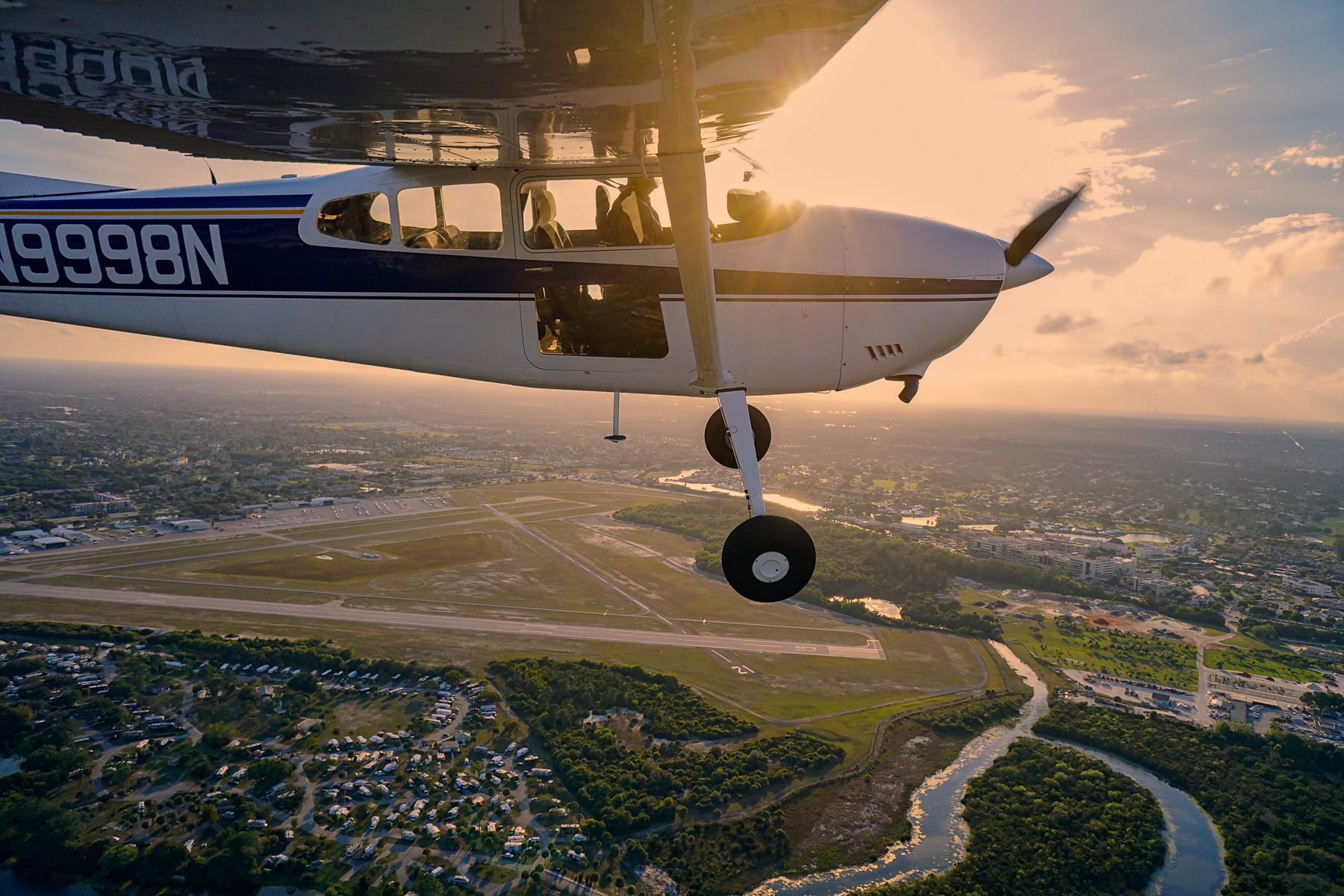

My exhaust fairing easily adds 15-20 knots TAS. Right. Minimal gain I’m sure but it does look ok. Haven’t flown without so don’t know about the temps. Must be removed to get lower cowling off but nice machine screws attach it. I’ll try to find STC paper on it for more information.
Yep, Maple leaf, thanks Limerick!

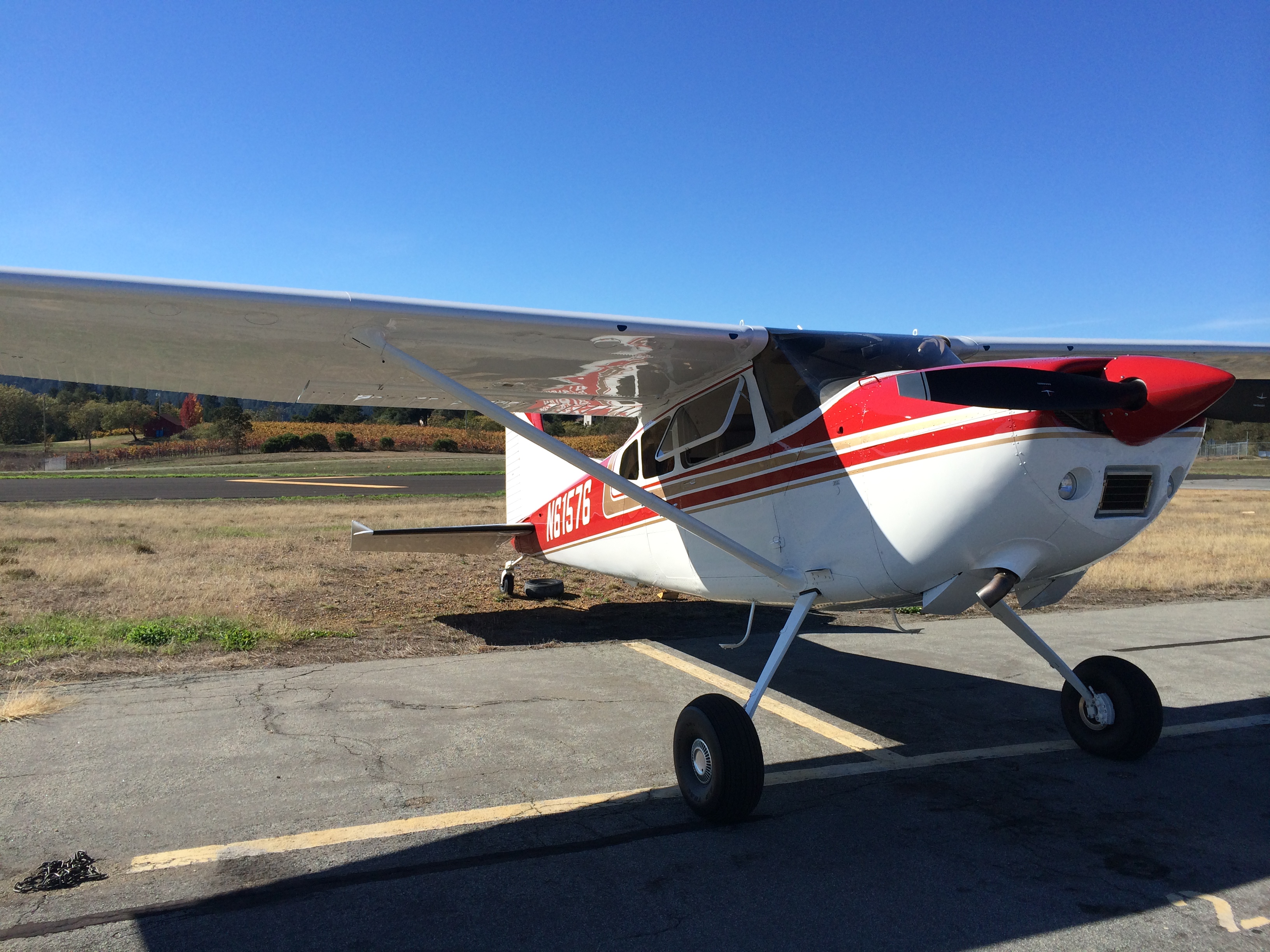

I installed the Maple Leaf exhaust fairing on my C180K approximately 7 years ago to reduce CHT's as I did not want to install the shark fins. SoCal and Arizona flying temps. The fairing took approximately 10-15 degrees off the CHT's. YMMV. No speed increase as far as I could tell. I slip a heavy sock on the exhaust when removing the cowl to not scratch the paint. Easy cowl removal and it was simple to install. I drilled out a few rivets (heads were in the way) to get a nice flush fit. Prior to final install, I used a small airbrush to primer and shot Vestal white JetGlo to match. Highly recommend. Looks good too!
Please note: the fairing does not need to be removed prior to the lower cowl removal. Cowl slides out easily from the exhaust pipe. Cheers!
Maple Leaf Fairing.
