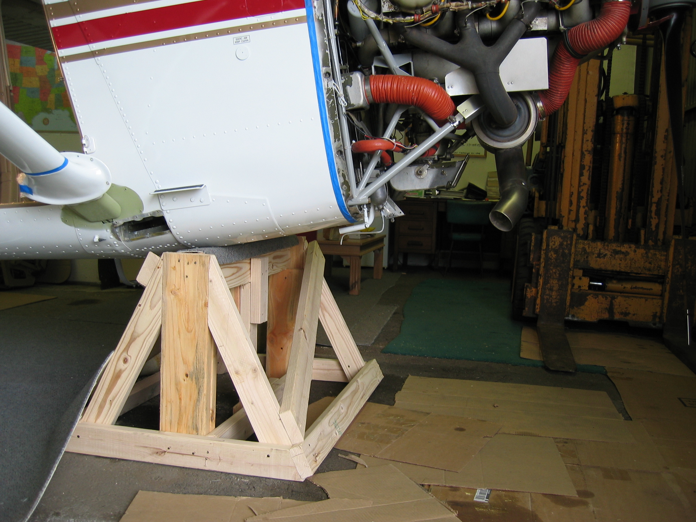

I replaced my landing gear brackets in 2008 due to heavy granular corrosion. 1977 C180. Lifted the plane up with a fork lift using a strap around the engine mount and placed on a wood saw horse I built specifically for the project. All work was done from inside the plane other than the rivets drilled out and replaced on the outside. I used new PPonk gear brackets. I soda blasted the gear legs and painted while I was into the project. I'll look for pictures to post of the project. It was not hard, just took time. The guy across from my hangar built an RV-7 and assisted with the rivets.
Bruce

Re: Skywagon gear leg outer bracket.
MLG project
MLG project
Thx for the Info and Pic. Limeric, glad all went fine.
No, Regular Cessna, but a Kenmore bolt on extension that was in place prior to my ownership. I will add that I needed to trim and cut the ends of the saw horse with a Sawzall to make room to drill out the exterior rivets and for the rivet gun to work.
i located pix of the project and will add soon.

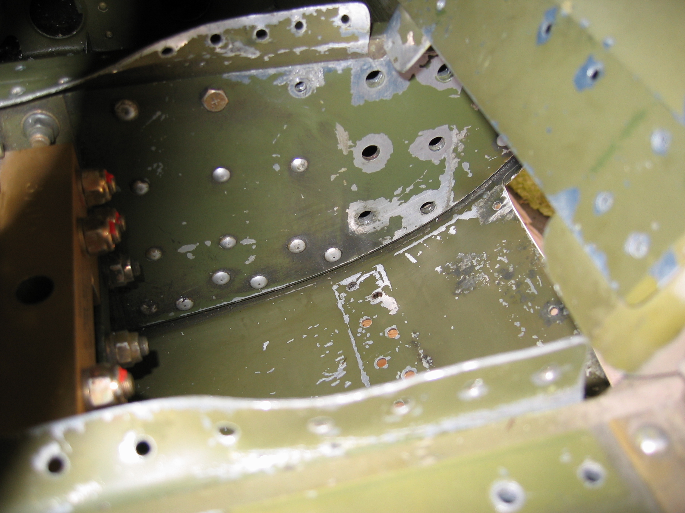

I seem to remember you can't go out the top of the gear box without cutting some angles, which is why I've always gone out the bottom. Anyone remember that? Did you guys cut structure to get the outer bracket out?
I can get the outer bracket out the bottom in around 4 hrs, probably because I've done so many, but the point is that it isn't hard. Reinstallation of the bracket isn't too tough and depending on how fancy you want to get cleaning things up and epoxy priming and chroming the inside of the inspection plates, you can probably get it done in 12-16 hours.
There is ONE rivet on the aft gearbox bulkhead that you have to pull the strut to buck. I usually save that one for last, after it's sitting on the gear again.
carefully and slowly bent up the angle (large crescent wrench) to remove and replace MLG bracket. I added a small angle stiffener after carefully bending down once brackets installed.
limerick wrote:
Wow, well done! If I’d done that it would have surely left those angles with little cracks after it was bent back to its original spot.

limerick wrote:
"Carefully" imparting tons of stress in to a part beyond what it was designed for is no less likely to damage it than imparting the stress like a butcher. It seems like a a lot of work, just to avoid a lot of work.

limerick wrote:
Thanks for the great Pic, I am not a mechanic and wonder if heating the aluminum for bending when doing the job so might help avoid cracks and if so to what temp??
