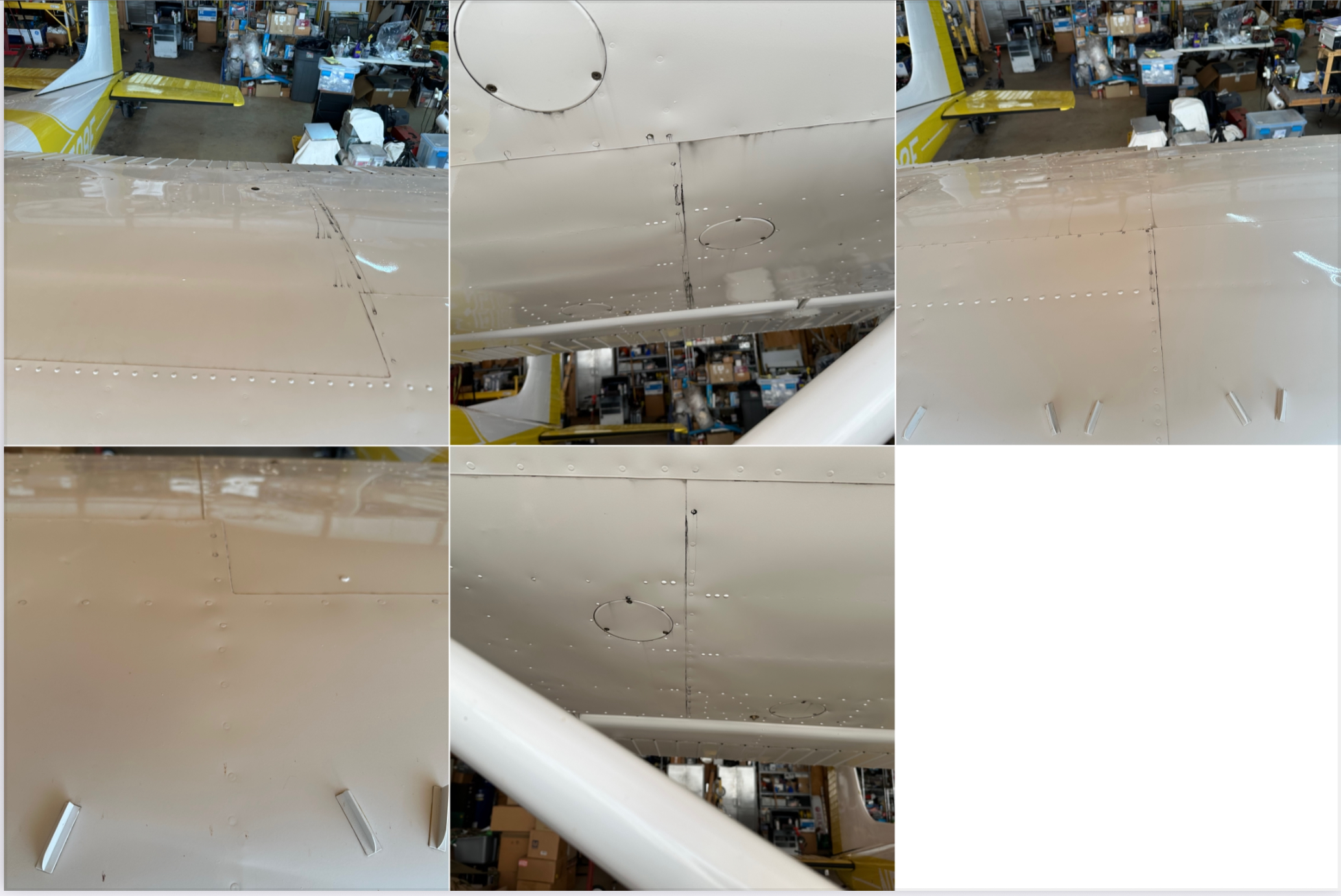

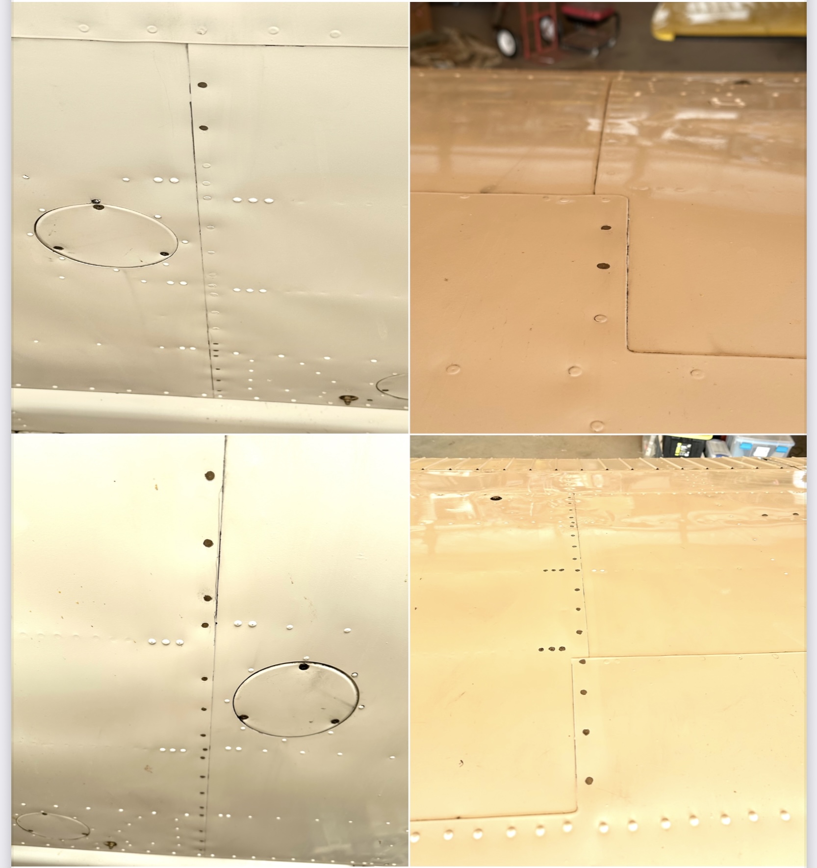

I contacted Del at Mountain Airframes, and sent him before pictures (see below):
He described this as a common problem with anti-corrosion compounds, and related he had dealt with numerous smoking rivets on the Corrosion-X test bed Bonanza. He estimated about 2 days and $2500 if they didn’t have to access the bladder compartment, and about 4X as much if they had to go in there, requiring wing pulls. I set up an appoijntment a couple months down the road and flew up there as scheduled.

Fortunately, the bladder compartments smoking rib flange is pointed outboard, so those rivets are external to the bladder compartment, so no wing pulls needed there. I should also mention I wanted it done with solid rivets, not Cherry Max. Unfortunately, there are a couple stringers on the upper surface of the bladder compartment, that attach to the outboard rib with three rivets each . On the left wing, they were smoking. Del had suggested there is a possible fix for those with pressurized epoxy, but I decided to go with Cherry Max blind rivets there. There is a sheet of aluminum underlying the stringers, so metal bits shouldn’t endanger the bladder below. This fix was suggested by Gray Morris, an airframe guy at Birchwood PABV during my recent trip to Anchorage.
Del pointed out the additional inspection holes which accompany a Flint Aero interal auxiliary “Legacy” fuel tanks installation would make the job a lot quicker, as they improve access. I was given the keys to a crew cab courtesy pickup, and I went off wandering. About 5 hours later. Del called and said it was done. Looks good. Cost was only $920. I’m very happy with their work. It’s an impressive facility, with several people working on multiple aircraft,
Before
After
