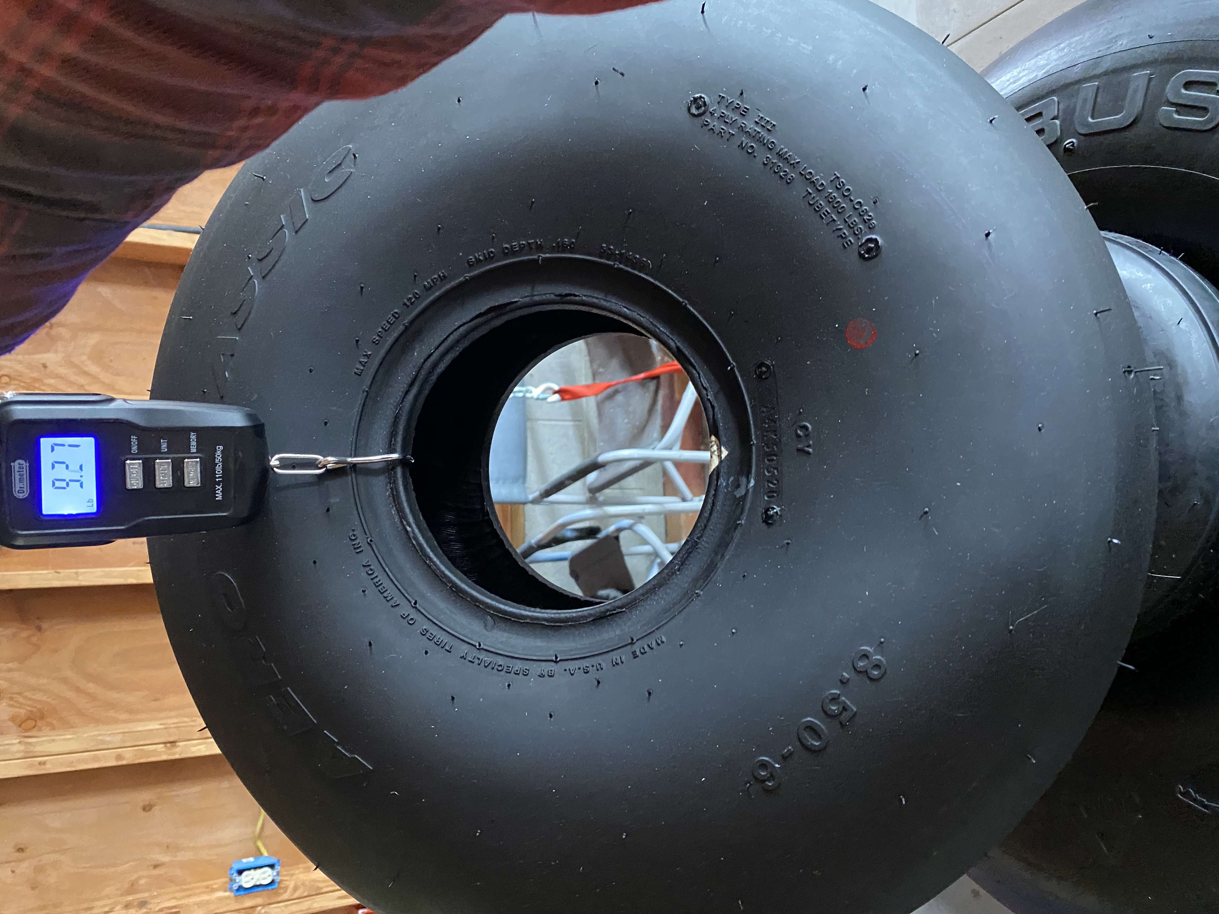

Fish scale says 9.27 lbs for desser 8.50.
