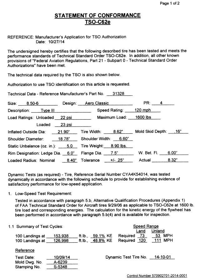

The TSO for the desser 850's states a 1600lbs rating, per tire, so as long as your bird is under 3200lbs you should be good.

My GW is 2950. After 150 hours mine look almost the same as they did when I installed them. Happy so far, but I’m not very smart.

hamer wrote:The TSO for the desser 850's states a 1600lbs rating, per tire, so as long as your bird is under 3200lbs you should be good.
I'm curious if the 3200# weight limit is tied to any reg. By that I mean, even a 185 at 3350 will have less than 3200 on the mains, so why can't I use them on a 185. Is there a reg or AC that relates tire rating to aircraft weight, or did we just decide this on our own via internet expertise?
If a TSO states maximum weight, I don't think you have to go any further. TSO stands for Technical Standard Order.....the standard there being weight rating.

Not arguing whether these are worth a damn or not. I agree, they may not be appropriate for a wagon. They are probably great on a J3/PA11 or supercub, or maybe not...
I'm usually pretty good at finding info as far as certifications and regs for modifications. I can't seem to come up with anything as far as tires, and whether or not these would be legal, or could be made legal on a 185. As far as I know all of the 850 STCs for a 185 call for 6-ply, but maybe I've missed one.
I understand just because it's legal doesn't make it a good idea. How does the weight rating of a tire relate to the gross weight as far as legality goes? Or maybe it doesn't? Does it correlate to "corner weight", as in weight on a particular gear?

I could be wrong, but far as I know, the Kenmore 8.50 STC does not say ply requirement. Maybe that doesn’t include the 185? I’ll have to look.
slow18 offline
Posts: 154
Location: USA
Re: Smooth 8.50 for SkyWagon
I just checked. Includes 180-180K and 185-A185F.
