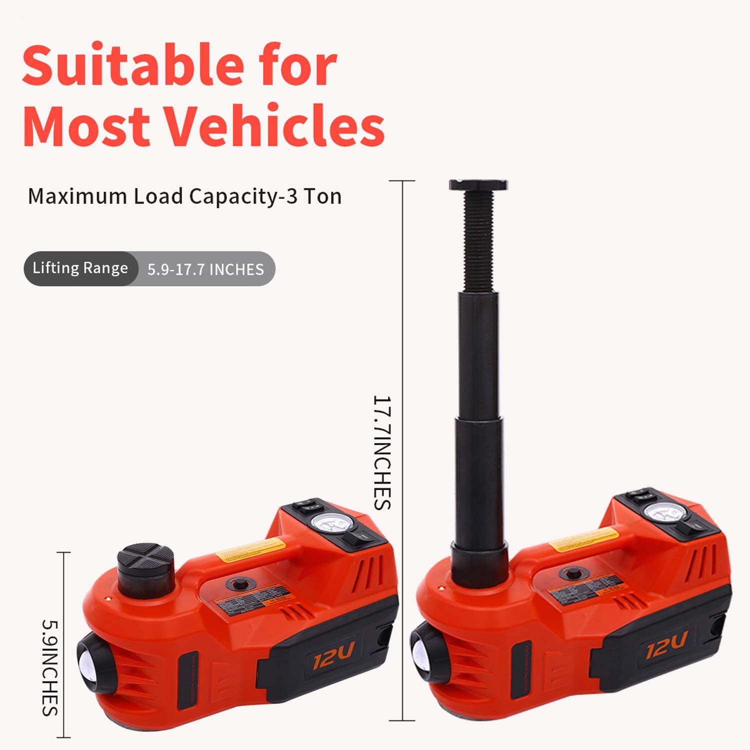

slow18 wrote:Most guys carry a spare tube I’m assuming. My 180 is nose heavy, so I have 30 pounds in the extended baggage which includes an electric jack (uses the earthx jump pack). It’s pretty neat. I’ve practiced with it and works well. Also have a small lightweight inflator that runs off the jump pack too. One charge gives several minutes of air and several ups and downs of the jack. Maybe that’s all silly, but I think it might come in handy solo in the boonies.
Which electric jack do you have?

Re: Smooth 8.50 for SkyWagon

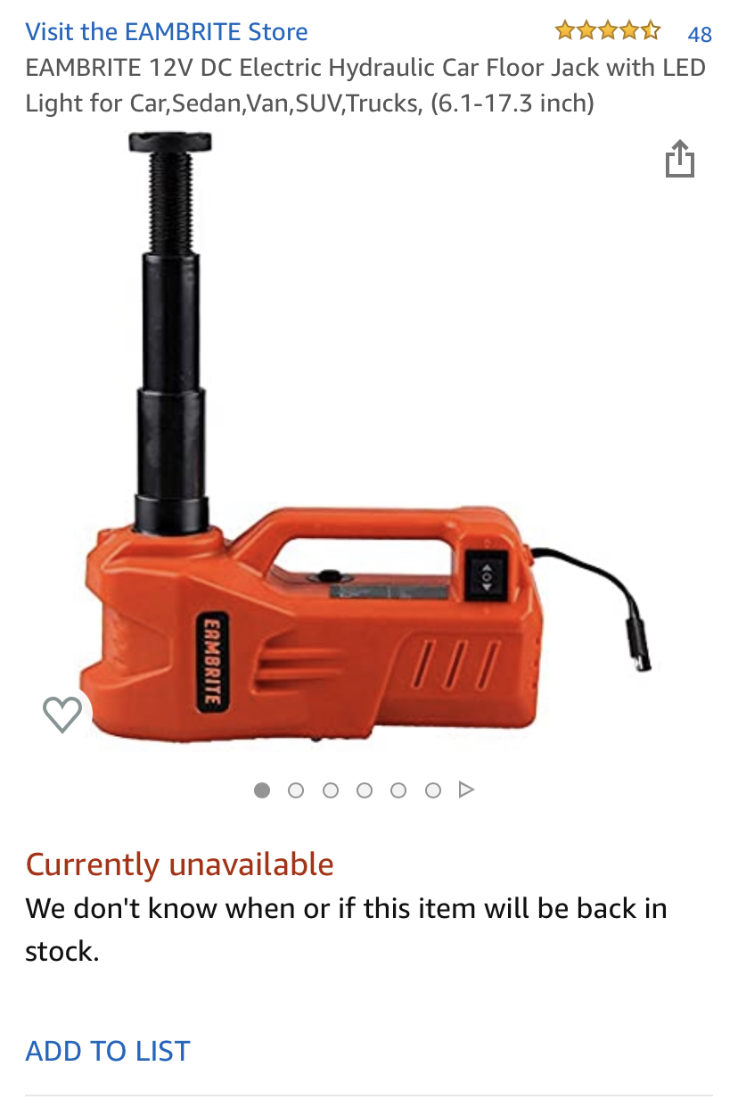

[/quote]Which electric jack do you have?[/quote]
Says no longer available unfortunately. Maybe other options out there now. I paid $85 2 years ago. On the fish scale it weighs under 8 lbs. only reason I considered it was because I need ballast.
To account for the spring gear movement, you need to raise and lower the wheel a couple times with jack to release the toe in tension before doing the final raise. Plenty of battery for this. My jack reaches 18” in height and I use a spring gear jack point block.
I did use it in the field to change a Tailwheel tube and it worked great.

slow18 wrote:Says no longer available unfortunately. Maybe other options out there now. I paid $85 2 years ago. On the fish scale it weighs under 8 lbs. only reason I considered it was because I need ballast.
Found this: https://amzn.to/2G2GO3b
Thanks Zane

That lightweight jack could be a fine alternative to the heavy bottle jack I do carry. Thank you all for the valuable information regarding the boonie flat; I apologize for the thread deviation but it seemed timely.
