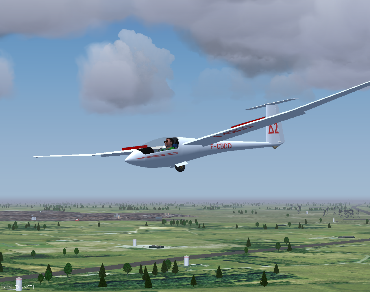

The Mini-Nimbus and Ventus sailplanes had exceptionally powerful speed-limiting "dive brakes" (combination upper surface trailing edge spoiler and lower surface flap) which functioned as both airbrakes and de facto glidepath spoilers. Aircraft would not exceed Vne in a vertical dive. Glide ratio about 2.5 or 3 to 1 at approach speeds. Image
The AS-W20A and AS-W20B sailplane had large flaps and separate spoilers, not speed limiting. You could damage the huge flaps in a dive. But extending both flaps and spoilers gave you 3 to 1 glide angle. Image
Although far far far from being the same type of aircraft as the 180, rest assured that properly sized and located airbrakes/spoilers/dive brakes like the ones used in sailplanes would provide a very useful effect on slow speed STOL operations in a 180. But the Precise Flight product does not look like it was designed to improve STOL ops, it looks like it was to improve descent out of cruise altitude.
It is noteworthy that the spoilers or speed brakes by Precise Flight say that it "doubles" aircraft drag. But they don't mention at what speed this occurs... I guarantee you that it is at high speed and not approach speed :)
