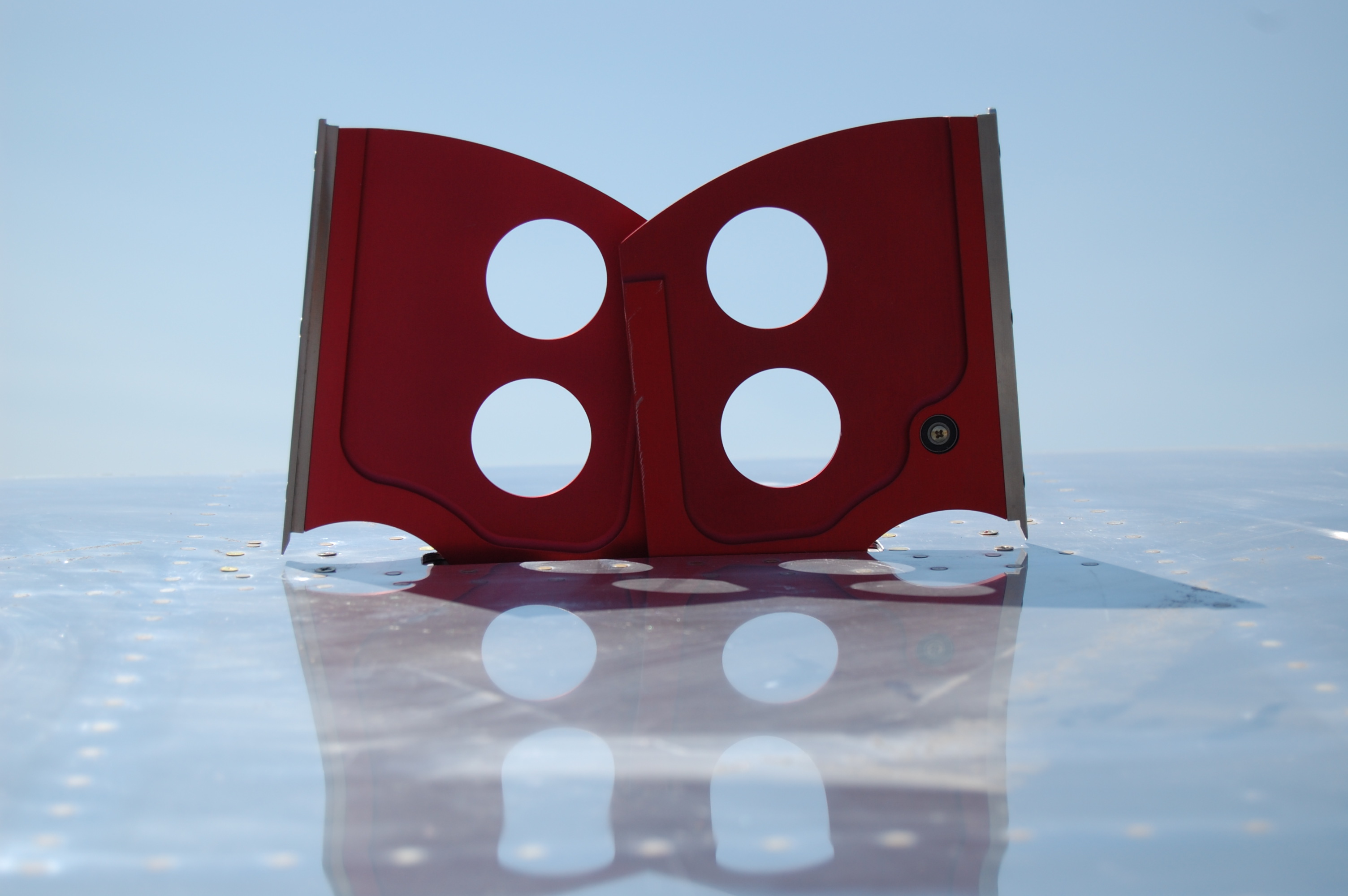

"Pop - Drop - and Land" they say
What's the skinny on these things? $6k + 25-35hrs for installation is mucho coin for something that isn't usually the limiting factor for how short of a strip you can get into.
https://www.preciseflight.com/general-aviation/shop/product/speedbrakes-cessna-180-series/
Posts: 1975
Re: Speed Brakes on a 180
Had set on my S-model Machen Bo with the TIO-540, worked wonderful for keeping a little power on and falling out of the sky getting into some airport where the controller keeps you fast and high for way to long.
Can't imagine where you would use them with a 185 or 206??
M6RV6 offline
Those are for fast descents, not sure they would do anything for landing short? I've seen them on some sky diving planes but that's it.

i don't know why a guy would spend a bunch of cash adding weight and complexity to a plane that is easy so easy to slow down in the first place. Spend that cash on fuel and T-bone steaks and you'll be much happier.
Scolopax offline
Posts: 1696
Location: Nottingham
Ditto. 40 degree flaps will bring a 180 down like a brick anyway. On a turbo 210.....maybe.
I test flew a Mooney Ovation with those speed brakes, and in that airplane, they were marvelous. Slowing a Mooney whilst going downhill is really difficult, but with those things deployed, piece of cake. I can also see that they'd be useful on a 210, because they don't have the massive barn-door flaps of 180s, 185s, 206s, and earlier 172s.
But because those others have barn-door flaps, I'd be hard pressed to see what speed brakes would do that would benefit any of them.
Friend of mind has a 185 and it has a Skyote Gap Flap System. Cant find any info online about it but its a hydraulic speed brake in front of the flap. he says it works great to slow you down

Skydiving Cessna operators swear by these brakes for rapid decents without shock cooling.

One possible advantage of these spoilers is that they might allow you to slow a Cessna down WITHOUT over-using the flaps as speed brakes at high speeds.
Flaps are not automatically OK to be used as speed brakes.They were designed to safely make a lot of drag at APPROACH speeds, and give you that famous Cessna steep glide angle. But I believe they were NEVER designed for people to just yank them out at the top of the white arc every fl;ight, just because they were too !(#*$ lazy to plan thei descent properly.
Of course people have used flaps to slow the Cessnas down from cruise speed for many years, but for many years there have also been issues with wear on the flap tracks, crinkling the trailing edges (fixed with the new flap "bulb" exstrusion), and wear on all the cables and pulleys.
Just because the Cessnas were FAA certified to PERMIT use of the flaps up to 100 MPH doesn't mean it's good the the airplane over time. It means it will not break the airplane any time soon. Meaning soon in 1953 or 1956. The FAA certification also does not include much concern for long-term wear. That is a maintenance issue for the factory, mechanics, and customers to worry about, again circa 1956.
If you told the Cessna engineers and FAA certification people that this same 1953 or 56 Cessna would be out there dogging around 50 and 60 years later, with the original flap tracks and original trailing edges, they would shit in their graves and the white arc would have been at 70 miles an hour, not 100. If you pay for the maintenance on your airplane, or if you give a shit about not wearing it out prematurely, you should operate the airplane in a more conservative manner.r.
EZFlap offline
Posts: 2226
EZFlap wrote:One possible advantage of these spoilers is that they might allow you to slow a Cessna down WITHOUT over-using the flaps as speed brakes at high speeds.
I've had to have two flap skins fixed, one a skin segment and one a whole skin. Both had cracked--fortunately caught the one before it took out the whole skin again. After the first which took out the whole skin, I asked my IA if it was a common problem; he said it was, and it is caused by too high an airspeed on deployment. So I have made it a point not to pull the handle until the IAS is below 85 mph, although Vfe on my airplane is 100 mph. Why the second crack happened is anyone's guess, since it was actually to the newer skin.
I don't think that there's any question that higher speed flap deployment is hard on the airframe, whether it's skins, tracks, rollers, or what have you. Fortunately with Cessnas, they're a draggy enough airframe that slowing them down to a safe flap extension speed isn't all that difficult.
