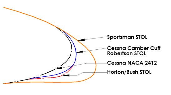

I disagree with Bigrenna, but as he mentioned, there are lots of opinions.
I had a Horton with VGs, removed it, and added the Sportsman and VGs, huge improvement which I noticed on the very first flight.
Before, I was doing approaches at 60mph and the plane felt like was falling from under me, did the change, and got stable 50mph approaches.
Just look at the graph, Horton might improve the old Cessna wing, but its almost the same as the new Cessna leading edge.
Look how big the Sportsman kit is, highly recommend it.
