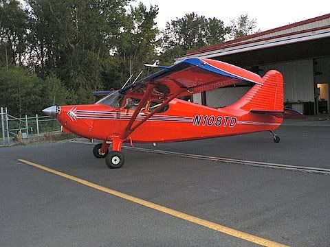

Stinson's are awesome! They're by far the best "bang for the buck" 4 place out there! I'm intimately aquainted with them...having rebuilt some as well as holding an STC for aux fuel for them.
The -3's wing tanks do hold 25 gallons of fuel each. This is the main outward difference. However, the spars are of a different alloy, to obtain the higher gross weight of the -3, and are a bit succeptable to some corrosion, so look them over carefully.
Edo 2425 floats are the only ones shown on the type certificate, however if you want it to really be nice, go with the STC'd 2440's...much better performing float. There was (is?) an STC for 2870's out there... I've seen one, and the guy swore it was great.
Never shy away from a properly done fabric job. The metal Stinsons are ncie, but a bit heavier, and a properly done fabric job will easily last 20 years or much more, so that's really not a concern. (unless it's cotton)
The O-435 Lyc is getting very tough to get parts for and when you do find them, they're expensive (it's also heavy and the prop is pretty expensive) ...if it's got a big engine mod, try to find one with the O-470 or one of the other engines that parts are so very readily available for...you wont be sorry! The original 165 Franklin is a wonderful engine, and the smoothest thing you'll fly behind...nothing at all wrong with them, other than parts availability at times. It's not that there aren't parts out there, it's just tougher and tougher to find them. I certainly wouldn't shy away from one with a good Franklin in it, and the 220 Franklin is a very good engine as well.
Like was said, the performance with the O-470 will make the 180 guys be pretty quiet around you. :wink: That, in itself is almost worth the money.
A good friend of mine, and one who had thousands of hours of backcountry time always said he'd rather have that Stinson around him if he ever had to go into the trees or rocks, than any other airplane. After rebuilding them, I'd have to agree!!
You've hit on my other favorite with the Taylorcraft, and I've got lots of good to say about them as well (I own one)... but a totally different plane, so I'm not going to pollute this thread with that.
I'd be glad to answer any questions you have about them, just shoot me a PM.
