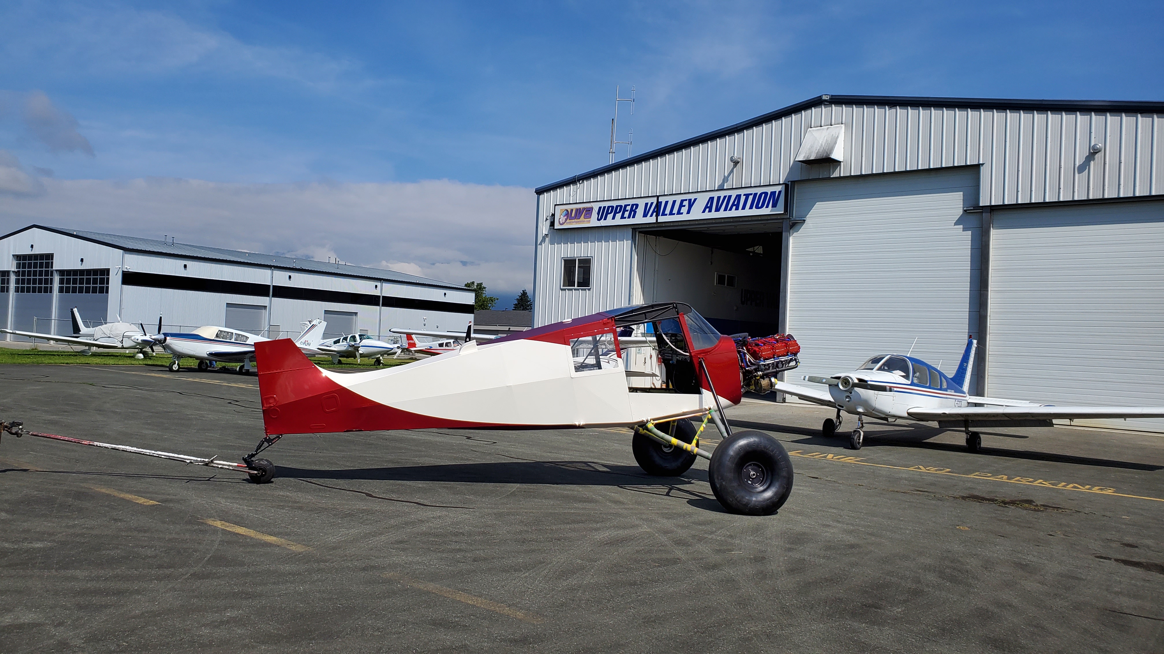

Bushmaster is flying take 3.. my buddy Larry had a terrible hunting season last year. Helicopter ride out for him and his buddies, helicopter ride out for the airplane. Tube in the door post let go from corrosion. Wing went up about 3-4".
Complete rebuild done at EA Structures. (Upper valley aviation only painted it/ where i work)
Twin turbo sequential fuel injected water/ meth injected io540, custom 1 off mt propeller. More garmin glass than my airplane is worth.
Custom tricolor red paint. It took Larry and the team at EA, 6 months. The fuselage is all brand new, longer and wider than original, done by bbi in Ontario. Carbon fiber interior, etc..
First flight was today. 60 percent power and 35 degrees outside at sea level 1800 feet a minute climb.. once they have the fuel charts (efii) calibrated it will be exciting to see how it performs

What is that tailwheel situation? Is that a coil over?
