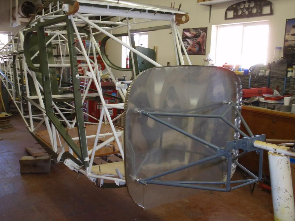

Today's mission was to get the forward interior, boot cowl, firewall, rudder, and vertical stab removed. Mission completed. Needed to get the front end opened up so I can get the busted / bent tubing repaired. The vert / rudder are trashed, so might as well rip them off while at it :D
Left side, if you look you can see the busted tube on this side as well as the one on the top engine mount. The bent tube is easier to see up where the windscreen would be.
Can see the busted tube here on the right side
Busted tube on right side
Busted tube on top left engine mount
Busted tube on left side
Didn't grab a pic before I ripped the rudder off, but this is the vert all smashed up
After the rudder and vert removed....pain in the butt since I couldn't easily get to some stuff due to the damage
Re: Tadpole's Stinson project #2...
Tubing repairs done!
I hired someone to do the welding.
I also got a hangar today at KFLY. It's 5 minutes from my house versus 35min where I'm keeping it now with friends. I'm splitting a T-hangar with a Pitts S1. Time to move all my crap out there. Will be nice to have room to work (versus my garage) and close to home, with all of it in one place. Next up is getting a firewall made or finding a used one, hang the engine, then get the fuselage moved. Then clean up the wiring mess behind the panel before I close all of that up.

From the firewall and new blanket install with some things still left to do before engine hanging.
And this is from today....
Engine on
