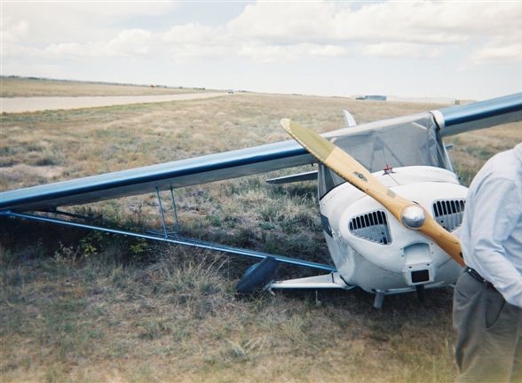

PA1195 wrote:They like to fold up under heavy compression side loads.
Wasn't me! Was sad to see this. Years ago I started working on my tw endorsement in this T-cart. Had the 85hp mod to it. I really liked flying it. A couple years later, someone had this little boo-boo.
T-craft landing gear.jpg (90.7 KiB) Viewed 3137 times

Edit: John knows more but I suspect the diagonal strut failure is due to a combination of internal and external corrosion and flex due to loads over time. Corrosion thins the material and flex eventually weakens it and allows for separation typically at the lower end where corrosion is greatest. Link: http://dc65stc.blogspot.com/2010/07/faa ... sheet.html
There's a safety cable at the top over the bungees to limit their extension and hold if they fail. It's common to add a brace between the diagonal strut and rear gear leg to minimize flex of the diagonal under side loads. Mine has Atlee Dodge installed Piper-type lower gear leg braces added for ski operation where twisting torque from skis is common. There's also a potential option for a safety cable along the diagonal strut should it decide to separate under landing stress.

One common failure for Taylorcraft gear is via repeated excessive side load compression. The diagonal strut on this plane has the mid-span reinforcement but the lower end is susceptible to internal corrosion and requires frequent inspection for debris and trueness.
