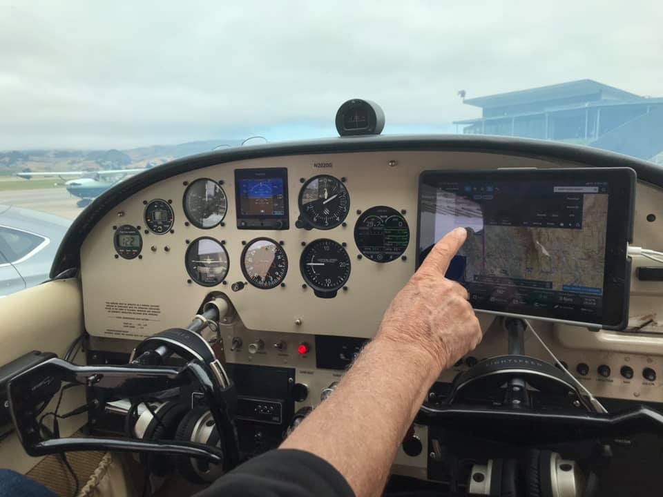

Thanks Bart. Exactly the input I needed. I think dry is the best plan also. They don’t move but a tiny bit anyway. BTW...I love everything about the way my panel came out! Cheers!
BirdyinBOI offline
Posts: 166
Location: Boise
Re: Teflon Yoke Bushings Early model Cessna
Your panel looks great, Phil! All that work is worth it in the end isn't it ?!?!
I just finished mine up too!

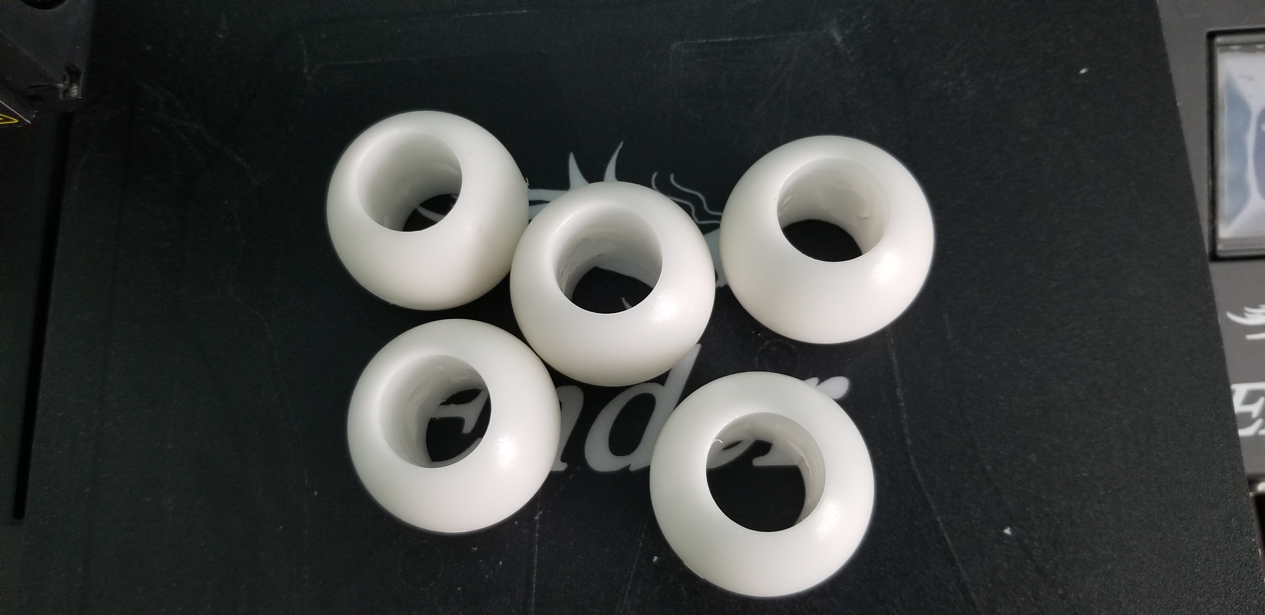

Machined some balls today. Will have a fitment report by tomorrow night.

All balls that were machined have been sent to Forum users - hopefully we get some updates on how they fit and like them.
Some things I noted were that the measurements provided above (0.770) did not reflect any of the aircraft I climbed into with a pair of calipers. I went into about 14 different cessna's and all of them reflected a yoke size no greater than 0.760. All balls sent out were drilled at 0.758 to ensure they didnt give too much slop in the controls. For the forum users that got their balls from me, if they end up being too tight or loose, Ill ask that you send them back to me and take a set of calipers to your specific yokes and ill drill them / replace accordingly.
