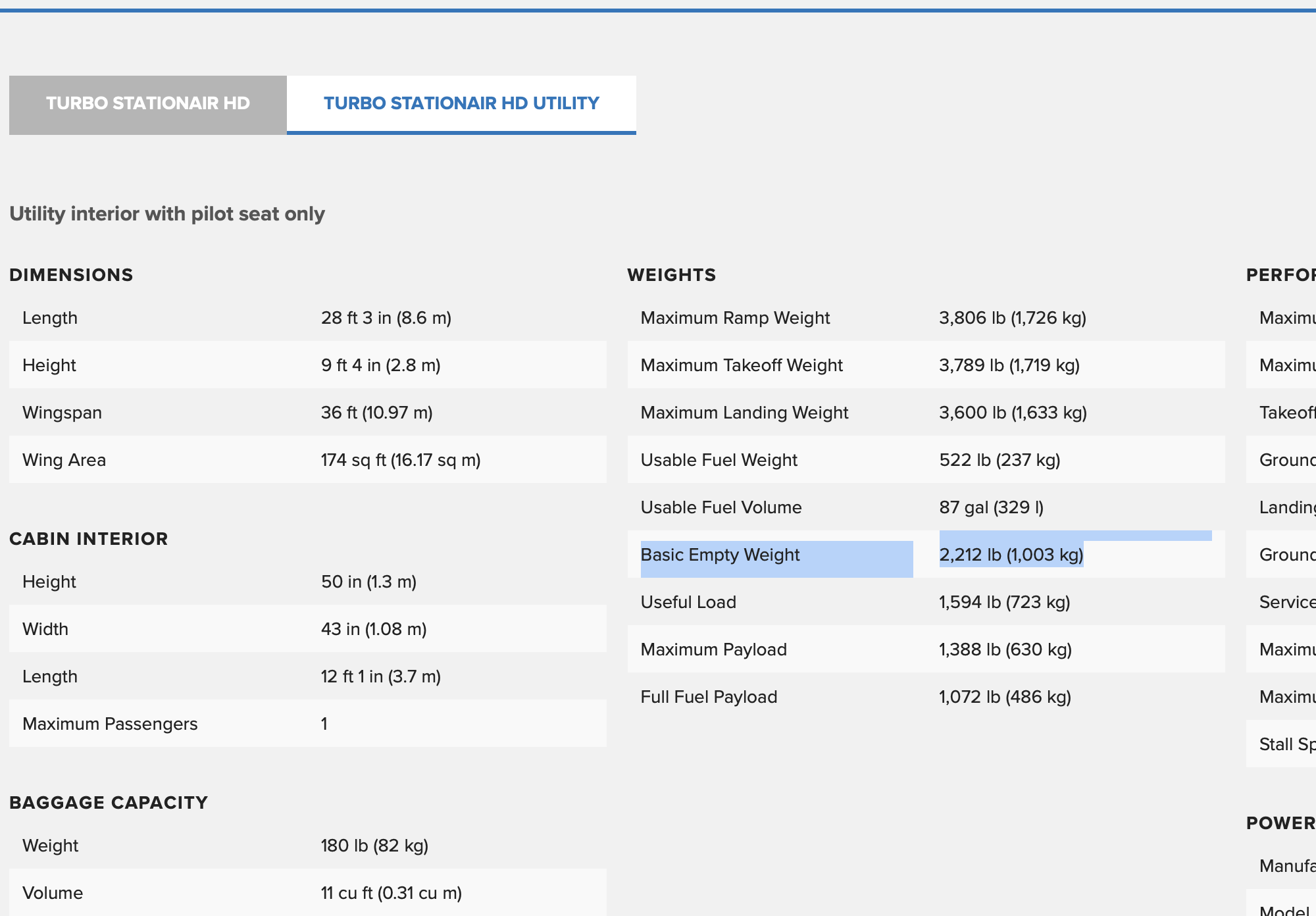

You're right - I labeled it "Gross" but I meant empty weight.
The new T206H claims to weigh 2,212 empty - do you think that's a real number?

I would not believe any marketing material. Go to Van Bortel, they have a multitude of H's for sale. Check out those empty weights.
