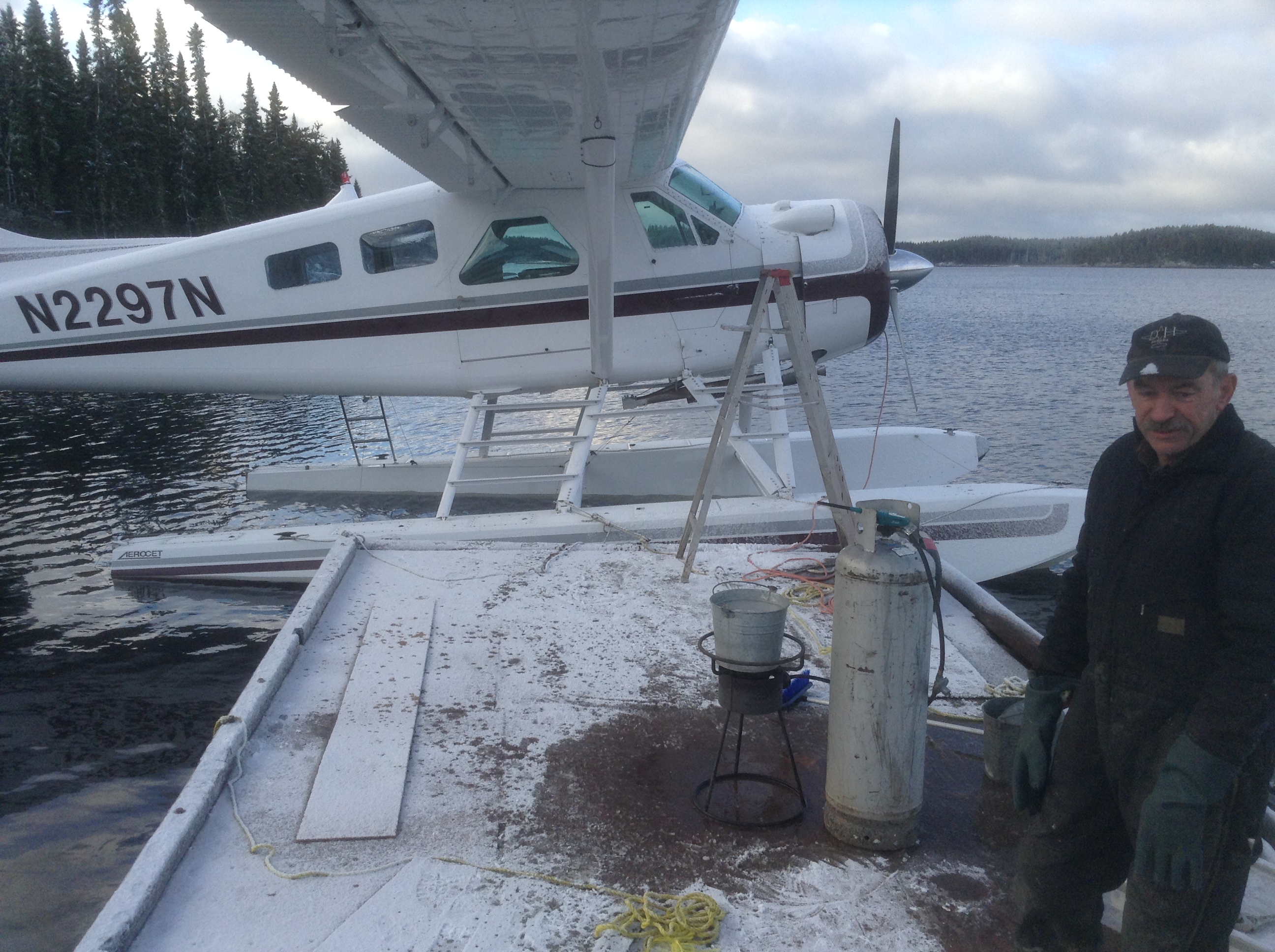

Maybe switch to a Beaver they are quite a bit cooler.

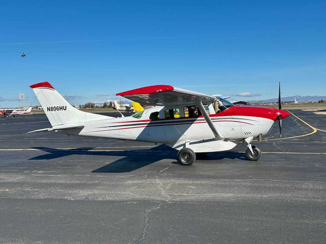

Bump on this topic: just finished our first (very extensive) annual on our new to us 01 T206. New W&B with stock landing gear/tires and rear bench (35.2 lbs) & two middle seats (28.6 each) removed is 2203.6 empty wt and 1396.4 useful=3600 lbs. BTW; weighed removed seats independently to verify that book #s were indeed correct. They are substantial.
Our 01 might be slightly lighter: G500 avionics, lighter new carpet and no wheel pants/brackets with stock tires/wheels.
She's going to be a fun machine. Next stop; get set up for LOP.
