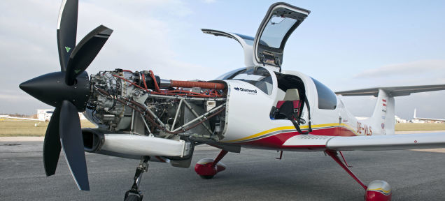

Diamond is planning to make a "tundra" version of this according to the article. Hmm...
http://flightclub.jalopnik.com/crazy-au ... thardigree
