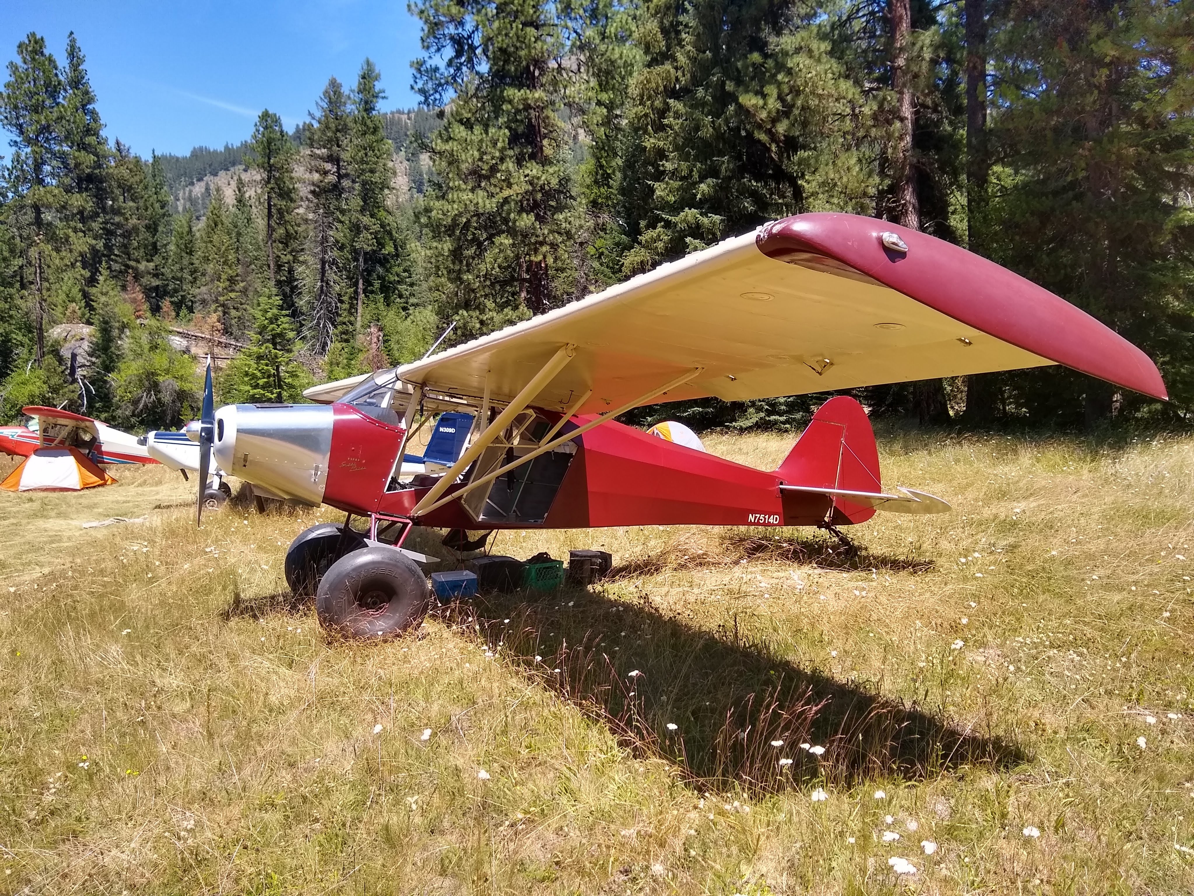

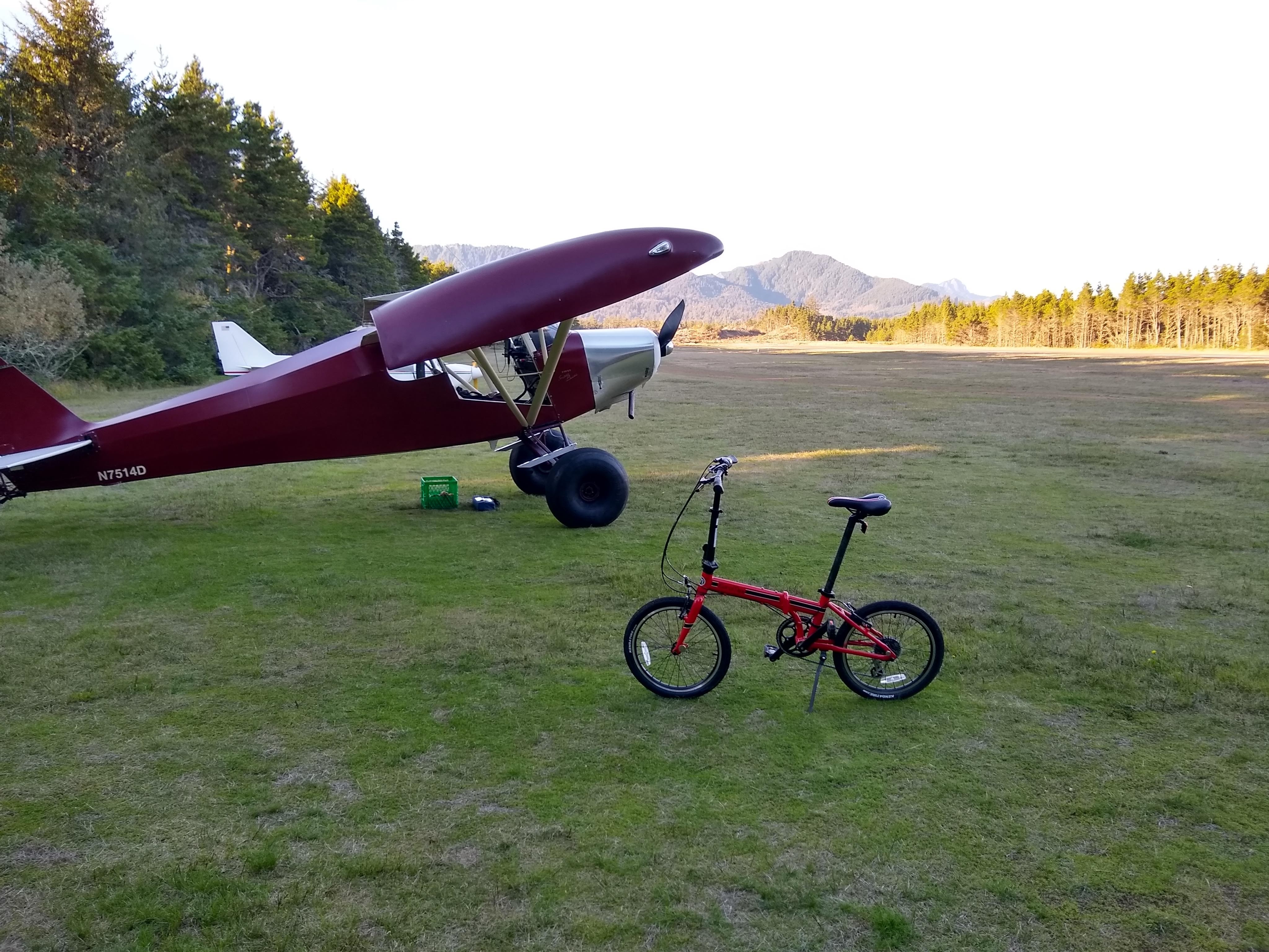

My 57 PA22- bushmaster, PA18 tail, Dakota Tanks, PA16 instrument panel, Dakota Tanks, 0-320-160 (Sutton exhaust, electronic ignition), one-time stick STC, Trimmer left door, Sullivan tips, 29's BW, 82" prop. Almost fits the bill all I need is Trimmer PA18 gear, MT prop, glass panel---then it's perfect.
My Bushmaster at Red's Horse Ranch

Hey, you're THAT guy! My partner and I have discussed your bird a few times while planning our Pacer mods. Very cool.

My certified Bushmaster also has seaplane doors both sides. I'm in the process of switching out my Demmer tips for Sullivan carbon fiber tips. I'm curious if I will notice any performance difference or than not banging my head on the old droop tips. I'm thinking about Trimmer's extended PA18 gear, maybe next winter. I'm also eyeing cutting my already small panel to two 4" Dynon or Garmin glass multi gauges. Brian threw out the idea of field approval on Keller flaps. I like it but, Bushmaster flaps (depending on the option you choose) are longer than Cub's. The data may not work with the FAA. I wonder if anyone has tried yet?

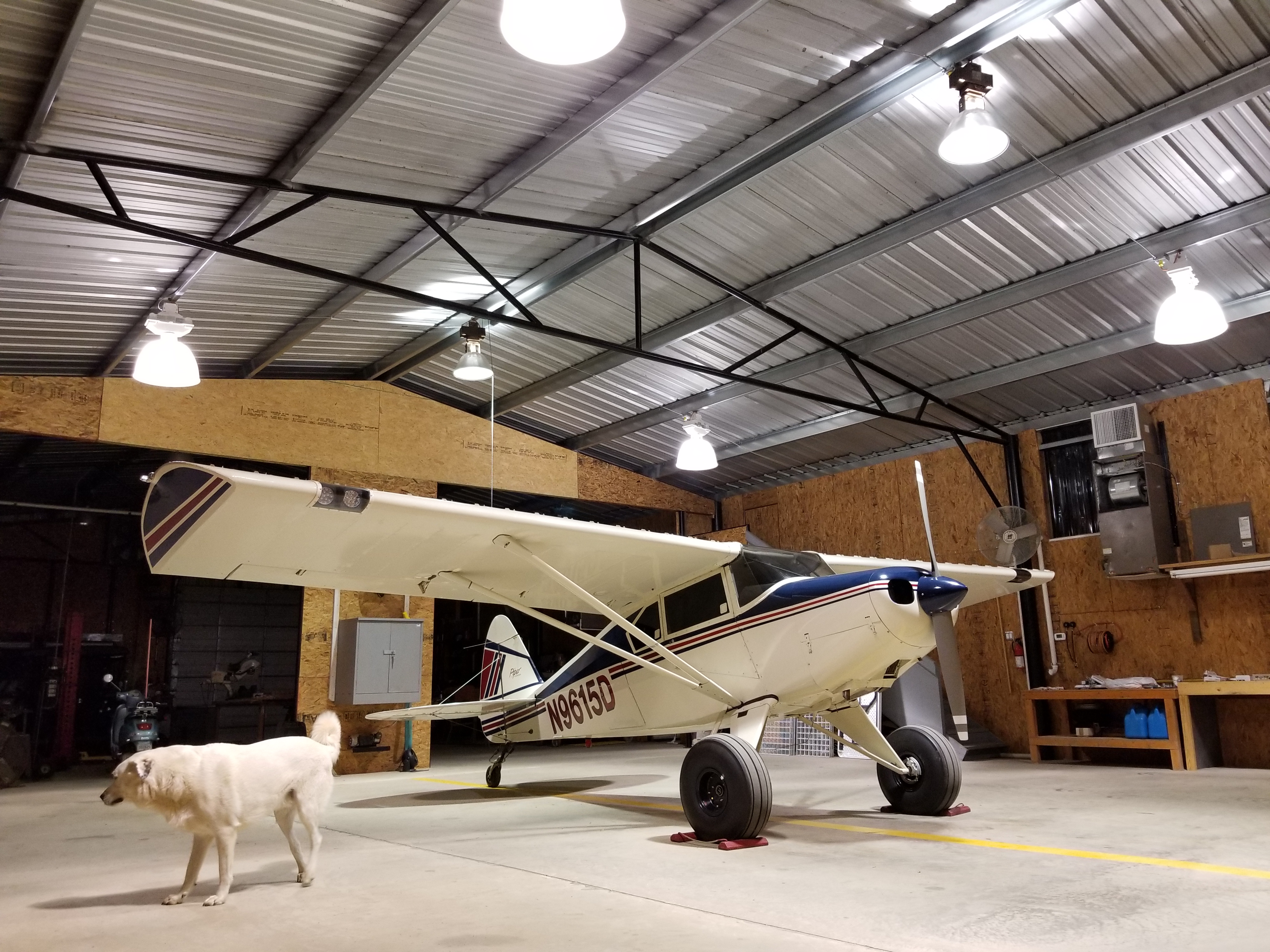

I would add a rudder trim to this. Already have the kit too :)
