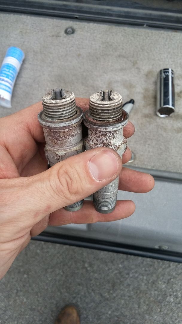

Tested it today on the #4 bottom and #2 top plugs.
The first 2-3 threads from the ground strap are totally useless for grounding. Totally covered in deposits. After that, I saw a 0.9 ohm resistance from the ground strap. I saw the exact same number at the bottom of the copper gasket. Saw the same numbers on both plugs and both ground straps on each. I got my resistance values from the thread face opposite the ground strap since that's the part that would be in contact with the head threads.
The same resistance means there's not really any propensity for one path to be taken over the other.
So it looks like it's a toss up. Probably goes both ways randomly or something like that.

There's no way that's even close to being as opinionated, polarized or unfounded as a statement in this forum needs to be in order to be considered fact... :wink:
On a serious note...clean those plugs!

Hammer wrote:On a serious note...clean those plugs!
Did better than clean them!
Re: UREM38E @ $24.45 versus REM38E @ $29.95
Cam good. Still, I like new. The threads go through hell and are harder to maintain.
But, I agree there is a path to GND from threads. It's just harder to keep it that way compared to a nice shinny copper gasket.
