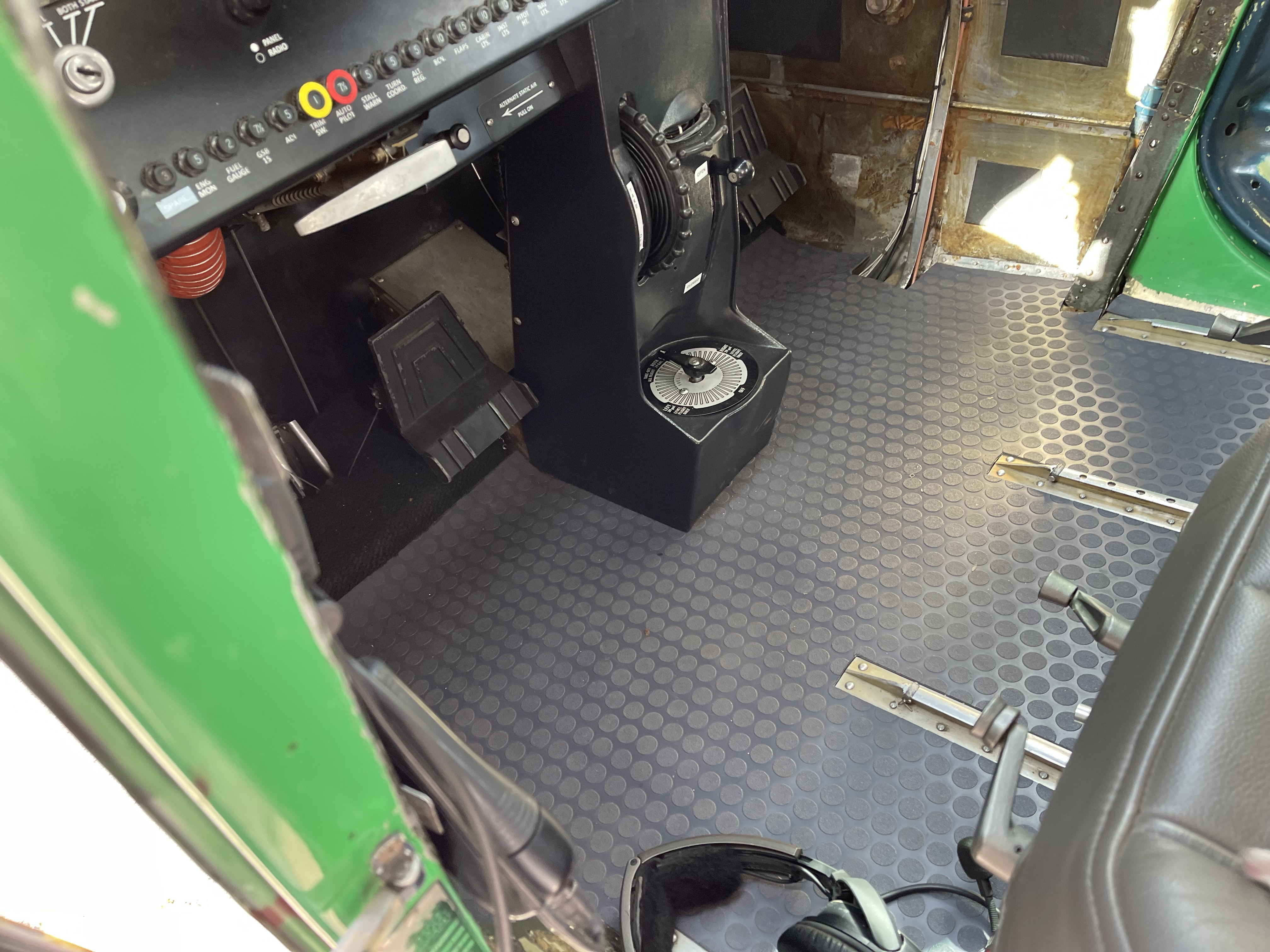

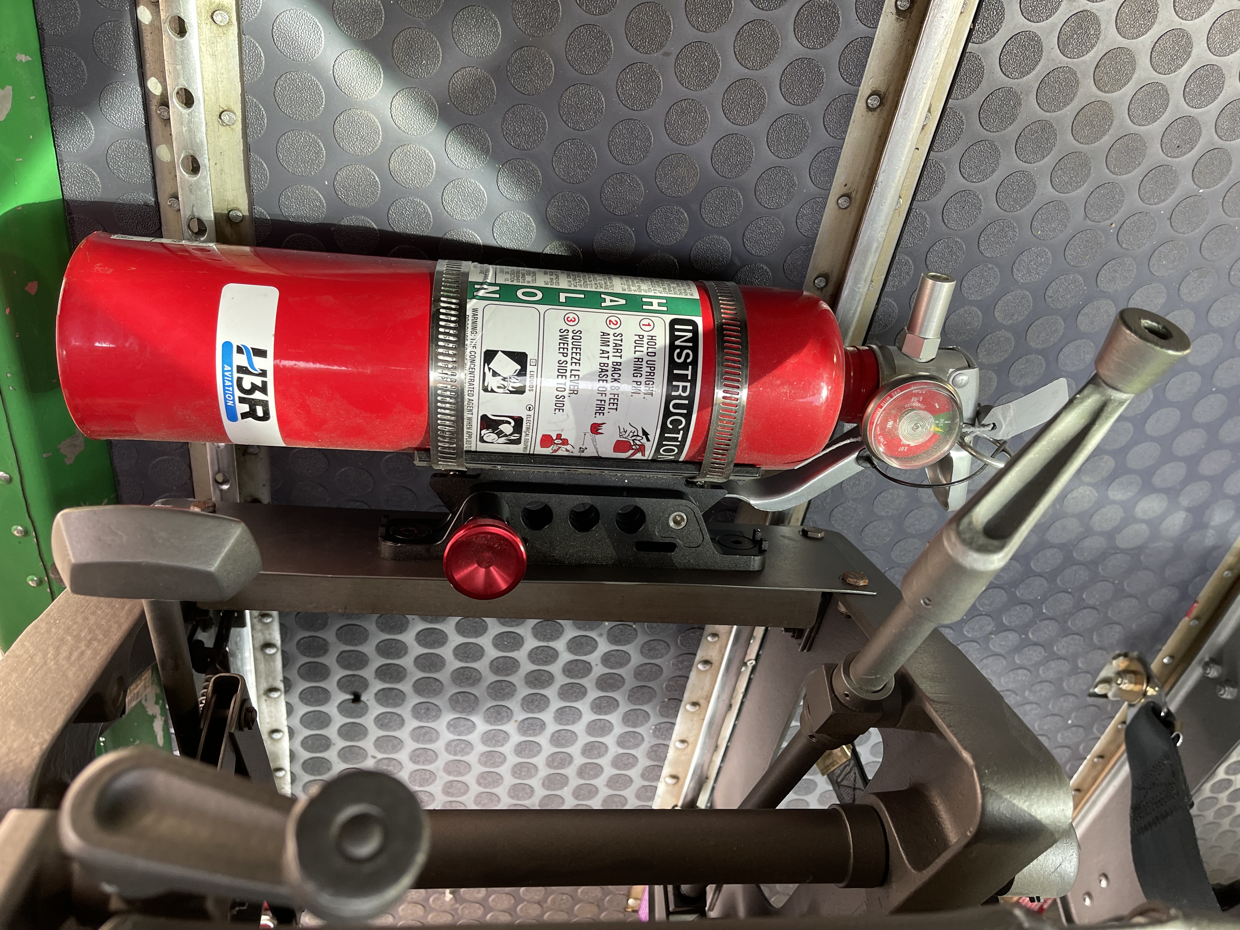

I'd suggest giving SCS Interiors a look. Reason I didn't go with them was because they offer a finished product, and my flooring was going to need numerous custom accommodations for Atlee seat tracks, brownline anchor points, etc. If you want to go a little lighter you might take a look at Aerofloor Dot from Aircraft Interior Products. I ended up going with Lonseal LonCoin, which is easily the ruggedest of the three options listed here. It has been great and has withstood plenty of abuse. Cuts well with shears.
Weights as follows: SCS Interiors 70 oz / sq meter. Aeroflor DOT 36 oz / sq meter. Lonseal 129 oz / sq meter. You said you aren't concerned with weight, but this might give an idea of how they compare as far as substance.

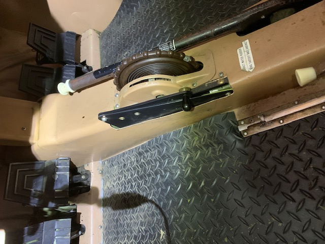

Rubber flooring for Cessna
180 Rubber Floor.jpg (95.35 KiB) Viewed 2657 times
The attached photo shows my solution for Cessna floor covering. It is 1/8" rubber with a diamond plate imprint. It is stiff enough so as not to curl under your feet and requires no attachment to the floor, it just lays in place. Pull it out and hose off, let it dry, and lay it back in. I found this material at Alaska Rubber and Rigging on Van Horn in Fairbanks back in '95. So, it will be 30 years old this year with over 4000 hours on it. Looks pretty much the same as when I put it in.

^^^ Lonseal has something very similar to the above, FYI. It includes a burn cert, in case that is a concern for you.
