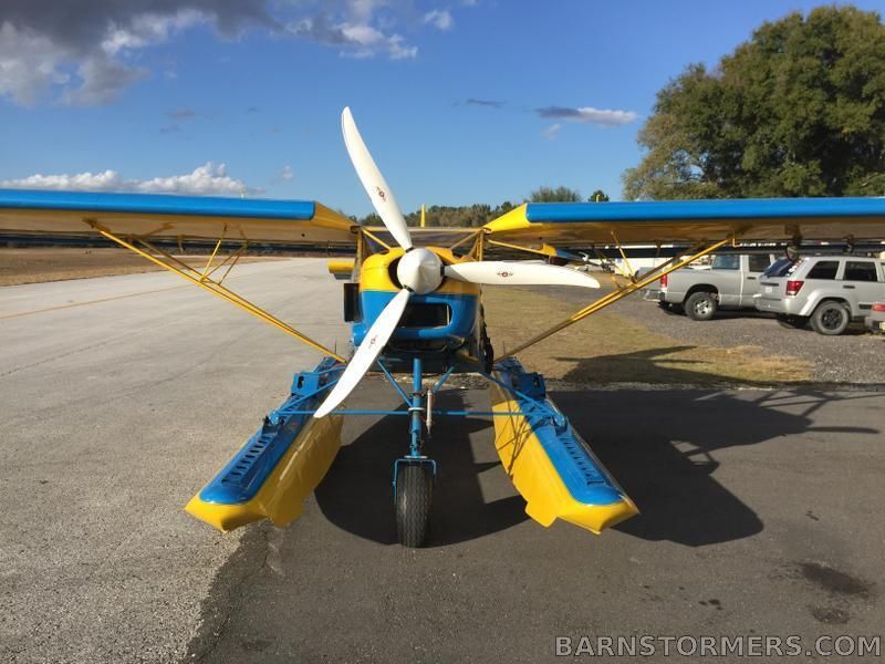

I know I'm asking for the best of both worlds in one package. I'm thinking the CH-701 on their own design Zenith floats might work, as it retains the mono spring gear and single full size nose wheel.
Looking for feedback.
This one is presently on Barnstormers with the turbo Rotax 914 asking $62K.

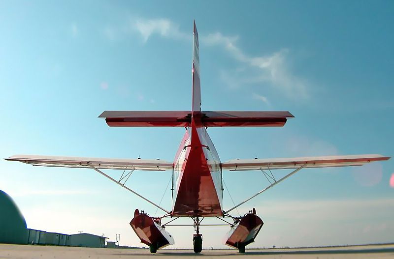

This one was just built and is for sale at Cloverdale, CA. (O60) It made it's first flight, on land, and my buddy down there said it flys nice. None of those guys are float rated, so it hasn't been on water yet. If I get a chance I'm gonna head over the hill to get it wet.

That red and white one is friggin' cool looking! Want one....
Edit: wonder how much spray that nosewheel setup throws all over the place?

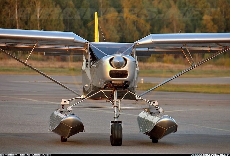

What happens to the front wheel when the Zenith on floats hits the pond?? does it fold back or something?

Battson wrote:What happens to the front wheel when the Zenith on floats hits the pond?? does it fold back or something?
Looking closely at the pics, appears there is an extension/retraction cylinder mounted along front strut.

That's just the shock strut. The nose gear is the stock nose gear installed on that airplane.
The nose tire does get in the water a bit during the initial takeoff run, and at the very end of the landing run, but keeping the nose up during both those evolutions keeps the nose tire out of the water for the most part.
But, with those airplanes, the weak link "off airport" would be the main wheels, and suspension, I'd think.

Well, there are hoses hooked to each end of the cylinder and they are not on the floatless planes...

I've seen a video on the gear retraction. It extends to clear a collar then folds back. Couldn't find that video but found another not as good.

That would make sense to me. Otherwise the nose wheel is the lowest point of the whole float set-up, if not retractable.
I know most float aircraft get a high nose angle in the initial part of the take-off run run, but even when it's on the step it's closer to level although still on an angle, and that nose wheel is still the lowest point, as pictured when on the tarmac.
Still looks like it must drag in the water some, when it's retracted.
ANYWAY - my point was going to be, if it folded back (which it does apparently) then that hinge and drive mechanism would be a serious weak point for anything I would consider an off-field landing - where unexpected potholes or rocks etc are encountered from time to time.

Interesting. My bad. I could swear I've seen one of those things some years ago that landed with the nose gear fixed.
In any case, that retraction mechanism looks like a pretty serious weak point in the nose gear. But, if it collapsed, looks like the floats would prevent a prop strike on land.....
I still doubt this setup would stand much "off airport" use.
