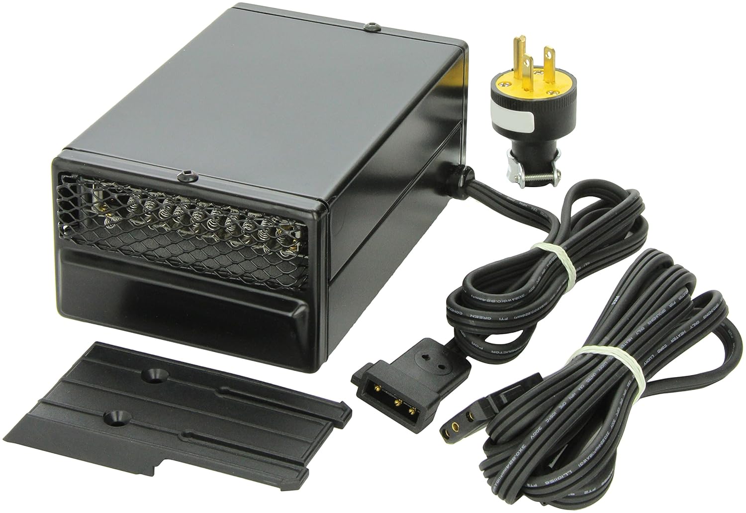

A ZeroStart Little Buddy arrived today. These came up on a SC forum thread. These are made in the USA and appear to be very good quality. It will be used to heat the wife's Suburban and will have back up duty pre-heating the planes engine compartment. At 900 watts, this is a great little heater for that! They are on Amazon for about $90.
http://www.amazon.com/Zerostart-260-.../dp/B000NM73ZA
I'm already thinking about getting another one to keep with the plane. Don't confuse this one with the propane fired little Buddy which is totaly different.

Yup, that's the good kind. Consider getting two for the plane- one for the engine compartment and one for the cabin/ under the panel.

Just bear in mind that those things get HOTTER than hell. Don't put them on or under anything that MIGHT be combustible or melt. When using these things, I put them in the UPPER portion of the engine compartment, NOT in the bottom. Those heating elements get red hot. Dripping gas or oil on them would be a bad idea. Often, it's possible to perch one of these on top of an exhaust manifold.

FWIW, I had one exactly like pictured, which I mounted under the passenger seat. It lasted less than one season, before the heating element burned out. When I took it apart, thinking that perhaps I could repair it, I was really disappointed with the quality of the stuff inside--great sturdy box, not so great parts. I suppose that they could have improved it since then (that was a good 8 years ago).

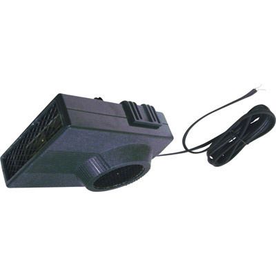

I replaced it with a Kats interior heater, which is cheaper and plastic, but I made the mistake of mounting it upside down. Turned out that its design is such that upside down, the bearings on the fan fail. Upright, they last forever and ever. So my second Kats is mounted the way Kats says it should be, and it has worked fine for about 3 years now, if I recall. I also have a Kats in my car, and it's now in the 3rd car and is about 12 years old. Cost is about $75-$80, at any auto parts store (often has to be ordered). This pic is upside down, as it's designed that the intake should face down.
