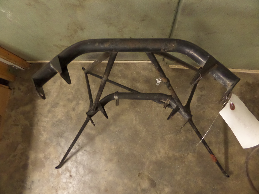

Mapleflt wrote:I agree with you Zzz, building a motor serious consideration. It could be done over a period of time while still operating the original engine until its ready. Anyone know the engine mount differences between the 0-300 and IO-360. I know a I0-360 can swing a fixed pitch prop but can it be configured as an "0-360" not I0-360, I'm a HUGE Conti fan as you can tell !!!
No, there is not currently an option for a Conti O-360. I've been kicking around this idea for a couple years. My prediction, based on real data, if that a O300 fitted with IO360 cylinders and maintaining the O300 carburetor will produce ~190hp @2800rpm. It would be a fun STC to pursue but I doubt it would ever make any money.
The IO360 uses different engine mount isolators than the O300.
O300 engine mount for C172:
IO360 mount for Cessna T41:
Best pics I have, sorry.
