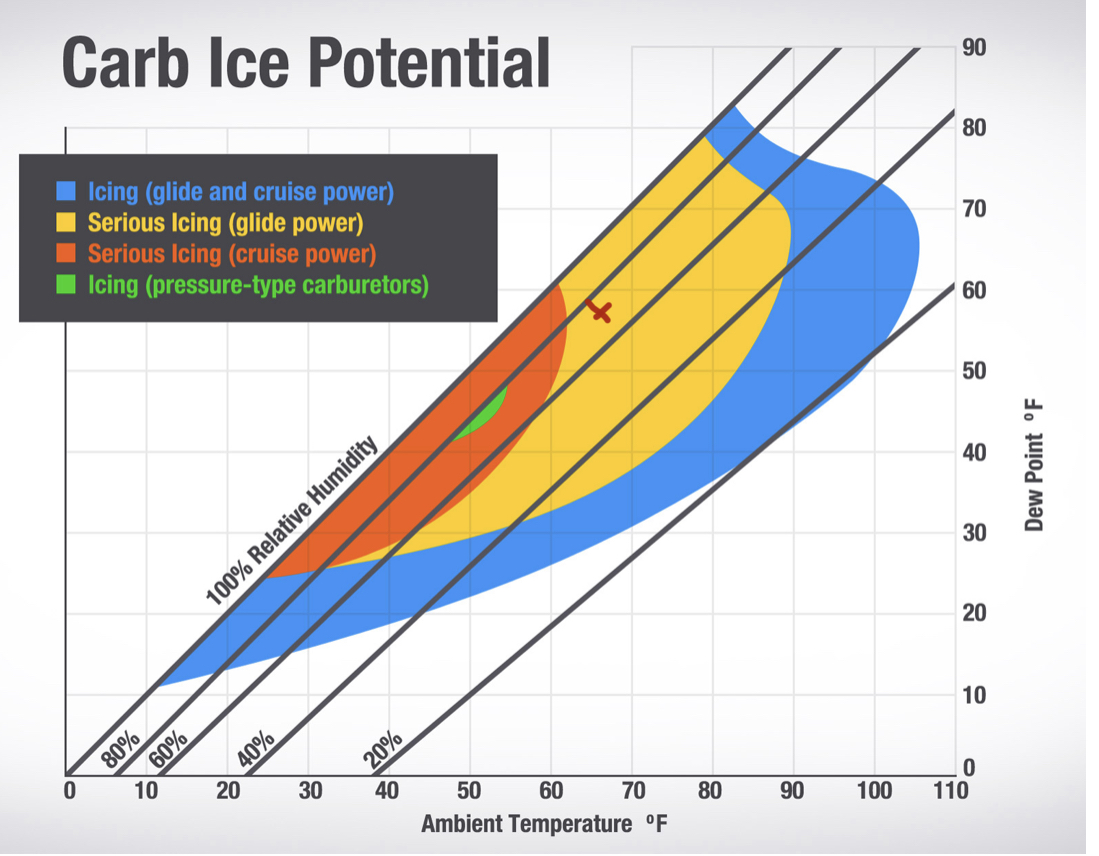

Just a friendly reminder that icing season is upon us. I had a little scare on Friday night. Departed 30 min before sunset for a short 50 min flight home, temp was around 65F on the ground and 75F at 3000ft. Dew point was 57F. Humidity near 70%. As I reached 3000ft and leveled off for cruise the engine started to stumble. I was over no mans land, about 15-20 miles from the airport I just departed. Did an immediate 180 and limped back to the airport, just made it with the limited power and altitude I had.
Never in the process did I think it could have been icing. I guess I'm used to thinking it's a descent issue only, but with the right conditions and a temperature inversion, it can happen on climb out.
The next day I pulled all the plugs, did an extended run-up and circled over the field at 3000ft for 10 minutes before I departed. The engine purred like a kitten. My only explanation is that it had to be icing. Per this chart conditions were perfect for icing. I will never forget to try carb heat in that situation again!

I have had a carb temp sensor since I bought my C180. The O-470 has a reputation for carb icing. I upgraded to the O-520 shortly thereafter and I am not sure if there less risk with this engine. The graph you posted is awesome. I am proactive with the carb heat when I feel there is increased risk for development. The combination of the sensor and being mindful of the high risk conditions where it can occur has made me fortunate never to have encountered it in my C180. When I do apply carb heat - it is on full. The carb heat is really only available for prevention of icing. The only time I run partial carb heat is for more even EGT running LOP. I think I am going to add flying over rough terrain as another potential location for application of carb heat in high risk conditions. Sounds like time moved very slowly for those moments limping back home - very scary.
