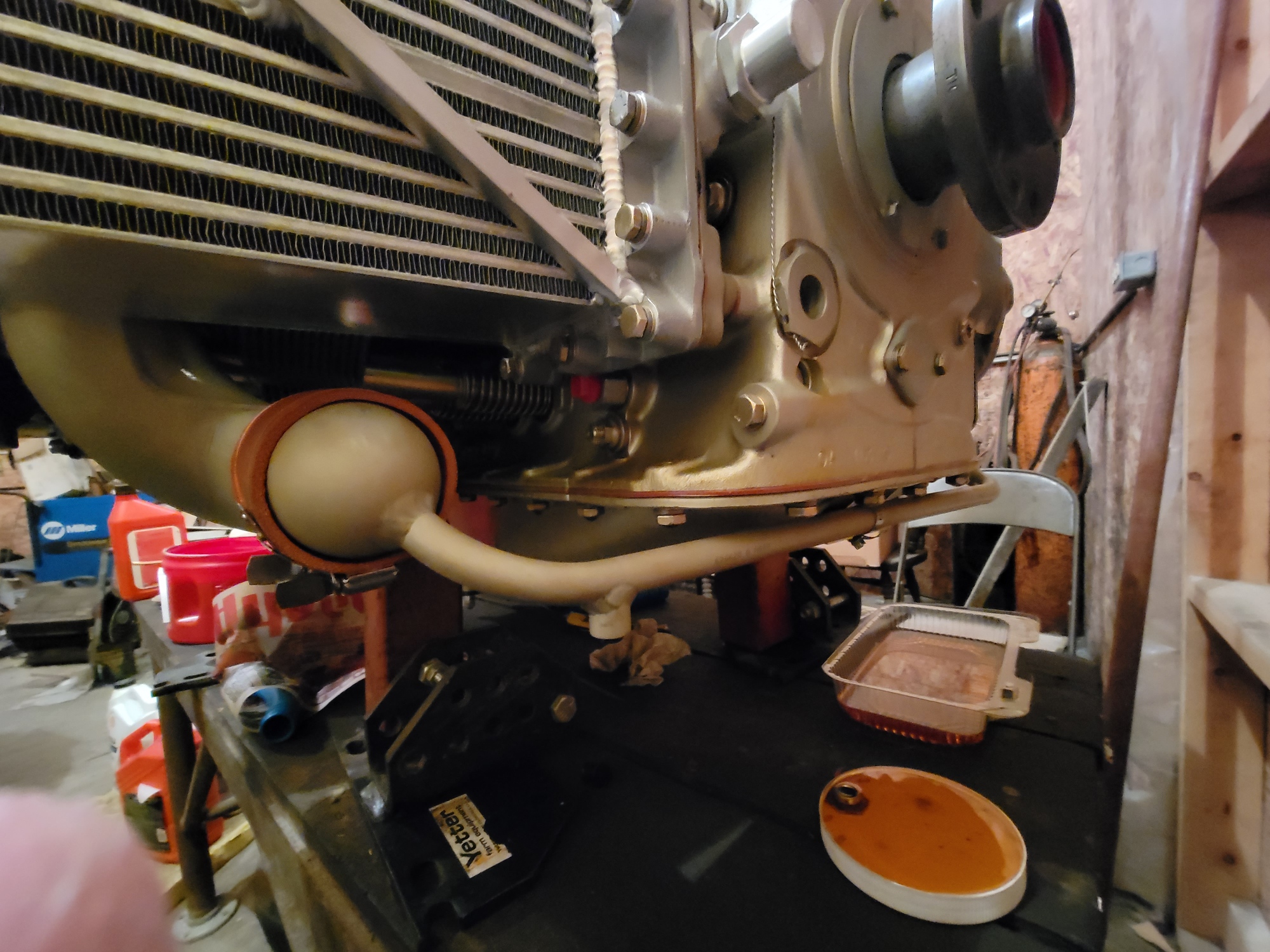

FWIW, the 470/520 has 3 sizes of crossover tubes. The smallest one helps the most with carb ice. This is especially important on the bigger pponk and O-520.
Posts: 2358
Re: Don't get iced...
This is what Central Cylinder put on the 470U that they converted to Pponk for me. It is even smaller than the one that came on the 470U on the Cessna 180K and the smallest I've ever seen.

Seriously... what makes the small crossover tube better? I would think that a larger diameter tube takes longer to get clogged... or is it a pressure/temperature thing that I probably learned in class and forgot right after the test?
