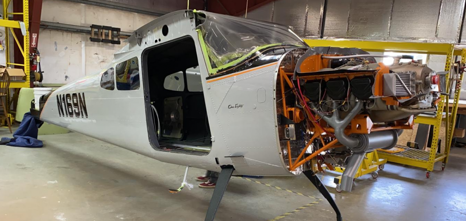

Fuselage came out of the paint booth today, wings are done. cowling and control services (repaired and refurbished) are done and ready to be painted. Wiring is close to being done.
heavy duty “J” steps from Atlee Dodge (reinforced using an inner tube of 4130N)
I had RAMI make all my antennas in black (2 com, ELT, GPS, marker beacon, transponder)

That is going to be the nicest 180 out there!!!

I swear to god corefile, if you ever, i mean EVER, drive a uhaul truck anywhere close to that damn airplane, you will not be forgiven. That is so nice.

Yeah... what a f'n nightmare. I was cleaning my hangar up the other day and there is still the bottle of whisky my mechanic brought to me while we were catching all the leaking fuel out of the smashed up wings. For sure no heavy equipment with my driving is going to be allowed near this plane - and thanks I think its looking pretty nice as well, but that said - its not going to be a hangar queen either - lots of camping and mexico dirt strips in the future.
