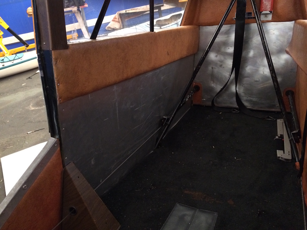

Cosmetics vs utility. Are you carrying a mountain bike in the back, propane tanks, firewood, chainsaw? Flying in mountain turbulence? ACA's interiors are a dated concept that aligned well with then state-of-the-art '56 Chevy. Would you have stretched sheets of vinyl on the inside of your pickup truck box to protect the outside skin?

If I wasn't a redneck hillbilly (thought that was an oxymoron until I watched Ozarks), I would have gone kydex like Goodyear considered. .016 instead (both sides are done now). And after seeing your craftsmanship I'm gonna pull the carpet next.
