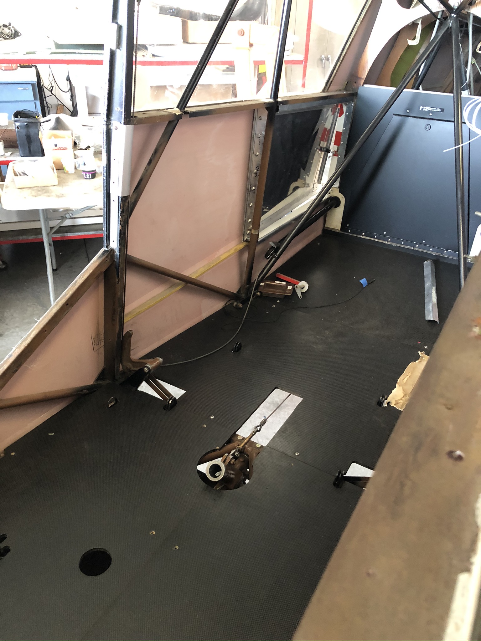

I've been thinking about trying to strip some weight out of this thing, make up a bit of the weight of the bushwheels. Pulled out the front carpet piece (probably 60% of total) and weighed it to get an idea. It was 4lb 6oz. That leads me to believe that it and the rear carpet combined would save me 7 - 7.5lbs. Every other tandem tailwheel I fly has wood floors so not losing much except shit will roll to the back when on the ground. I like carpet in cessna's to keep dirt and such from going into the belly but with the metal belley on this, that is irrelevant. Would likely sew up a boot for the front stick.
Not many people strip these things out but would love to see pics of interior mods if anyone has them. Might pull out the side panesl and see what they weigh as well. My goal is to remove nothing permanately. Have it where I could bolt it all back in if I later decided I wanted it nice. Open to suggestions.
4lb 6oz:
Posts: 1532

This is what it looks like stripped out

Re: Scouting
Carbon fiber floor boards would save you a few lbs as well. And a few lbs out the wallet. Win win!
Re: Scouting
Talked to ACA a few days ago. Carbon saves 8lbs for $1200. I decided to save 7lbs for $20. Today I pulled all the carpet and spent $20 on supplies to put thicker varnish on the floorboards. Going well so far, 2 coats on today. Will do a third tomorrow morning then start bolting stuff on. Was going to do metal heel plates but instead of trying to figure out what needs protecting, I'm going to let it naturally wear out a bit to inform me where to put them. Planned to pull all the wood out to varnish but decided it wasn't worth it and did it in place.
Also I took off the gear leg steps the previous owner had welded up. Don't do anything for me since my fuel caps can't be reached from there, and I can stand on the top of the gear leg or my 31's anyway, didn't see the point. That saved 2lbs and I sold them for $120.
So today my net work is +$100 and -9lbs. Not bad!
Front carpet...4lb 8oz
Rear carpet...2lb 8oz
Gearleg steps... 2lb 1oz
Posts: 1532
Re: Scouting
Your floor is in great shape. It will look really good with the varnish. I think you can use the carpet as a template for the heel plates.

Re: Scouting
Goodyear wrote:Your floor is in great shape. It will look really good with the varnish. I think you can use the carpet as a template for the heel plates.
What interior are you going with, in terms of side panels?
Posts: 1532
