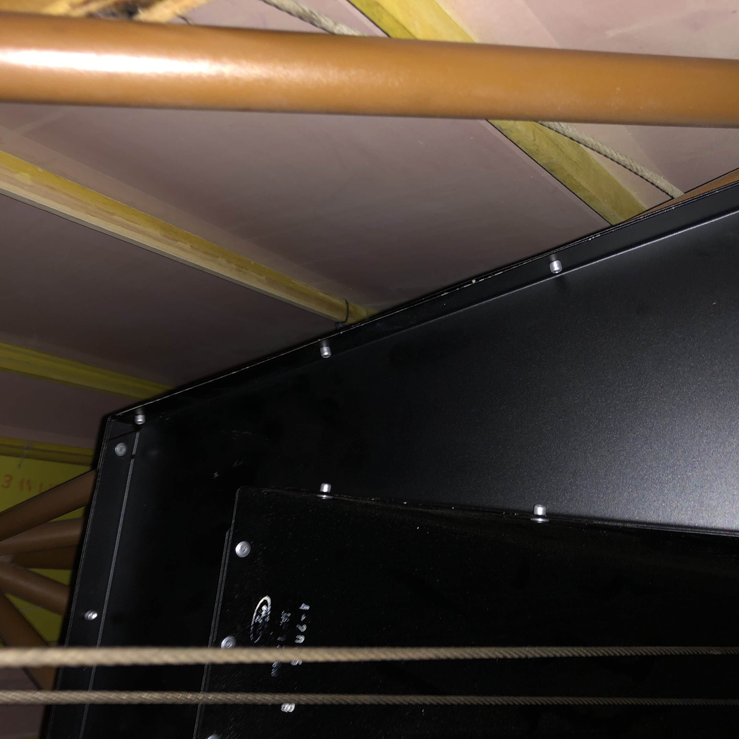

Mine (as soon as I can get it here) only has the rear baggage door not the extended baggage, any photos or details of the size and how hard the factory extended baggage retrofit would be appreciated.
I expect to do a lot of solo camping trips so most of the time it won’t be an issue. But it would be nice to be able to get longarms or fishing rods in the rear and out harms way if I’m two up.

Mine is a field approved one that is approximately the same door dimensions as factory, but 48" deep.
Bad image, but if you look for it, you can see where the compartment is relative to the airframe components:

This is the extended baggage from ACA. The picture above is the size of the inside door which opens down.
