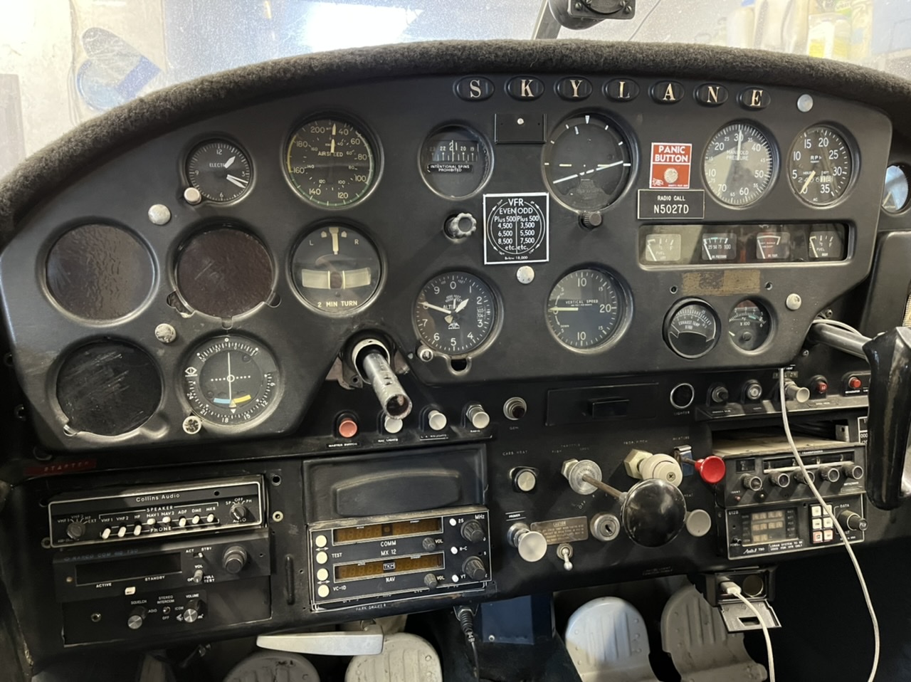

I will stick with the standard avionics. I do want to change out the DG and attitude indicator as the DG is the super old style that I have yet to see one work and the seller said the attitude indicator was bad.

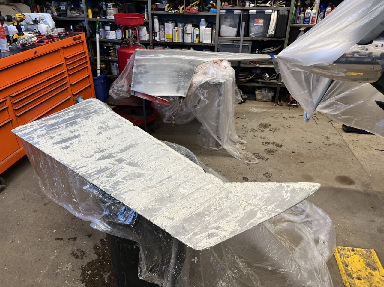

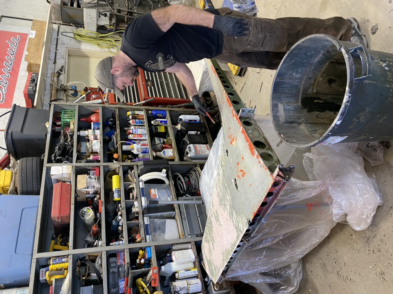

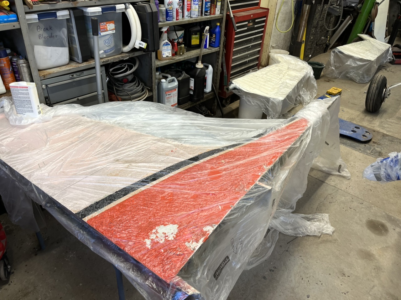

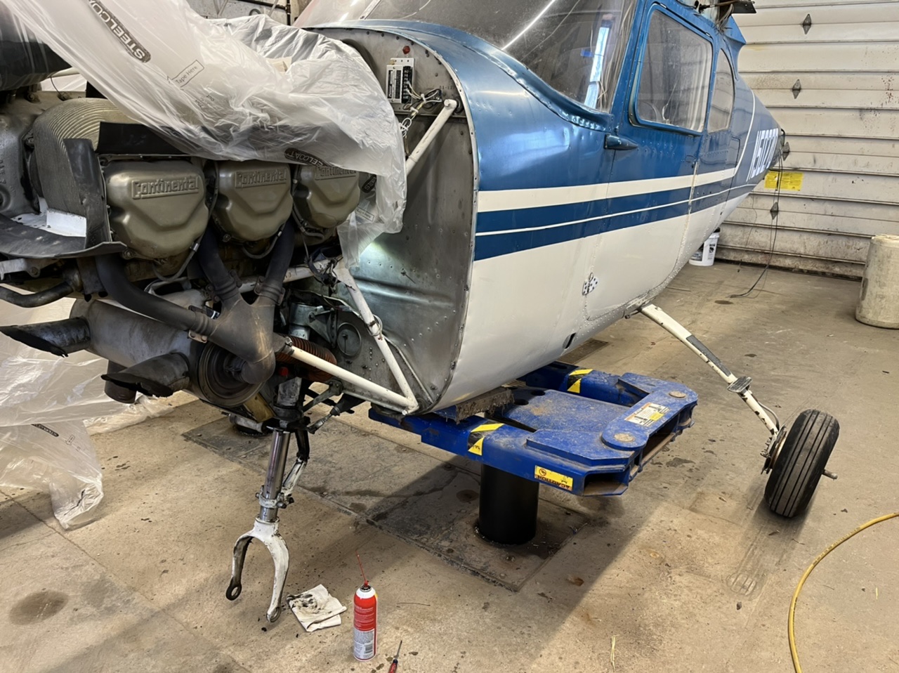

Dad and I made some good progress today. Tail group is off.
Stripping the replacement vertical and elevators.

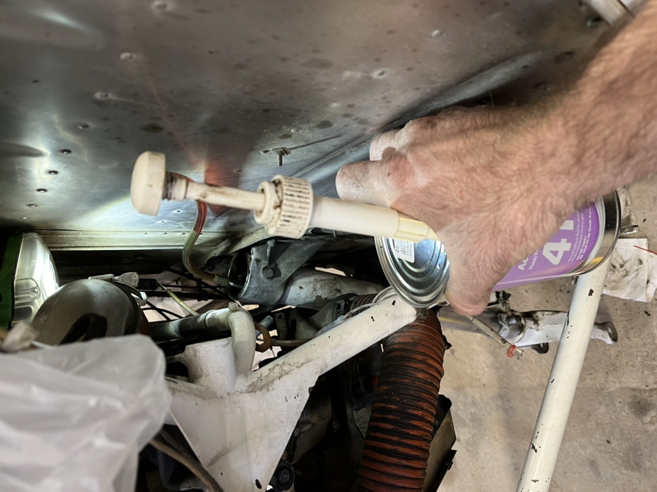

Boat lower unit pump worked perfect for filling the strut
Replaced front tire and tube. Strut now stays up
Scary looking rear mounts on the stabilator. Glad I’m already having my spare fixed up for this bird

I plan to sell the plane after 50-100 hrs. So the potential new buyer would probably cry if it did not have those instruments. I have made a couple panels, I may rebuild this panel and organize the instruments a bit better.
Also, I think people get fussy if the plane came from the factory with said instruments ~ they need to stay. Optional equipment can go away I believe

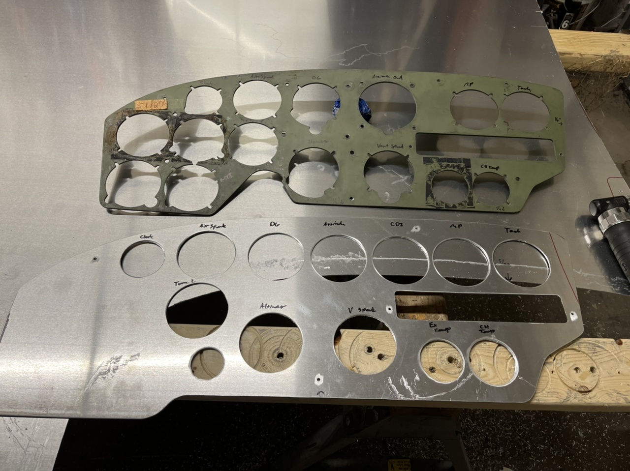

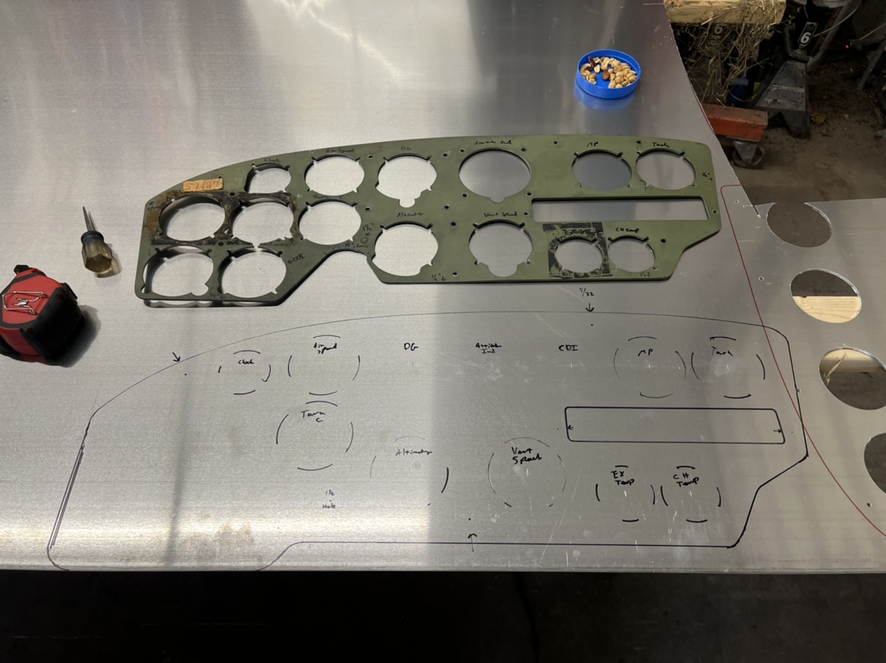

Made progress today, vertical is about ready. Elevators are getting close.
New panel is roughed out. All instruments remain. I just organized them.
Upside down.
