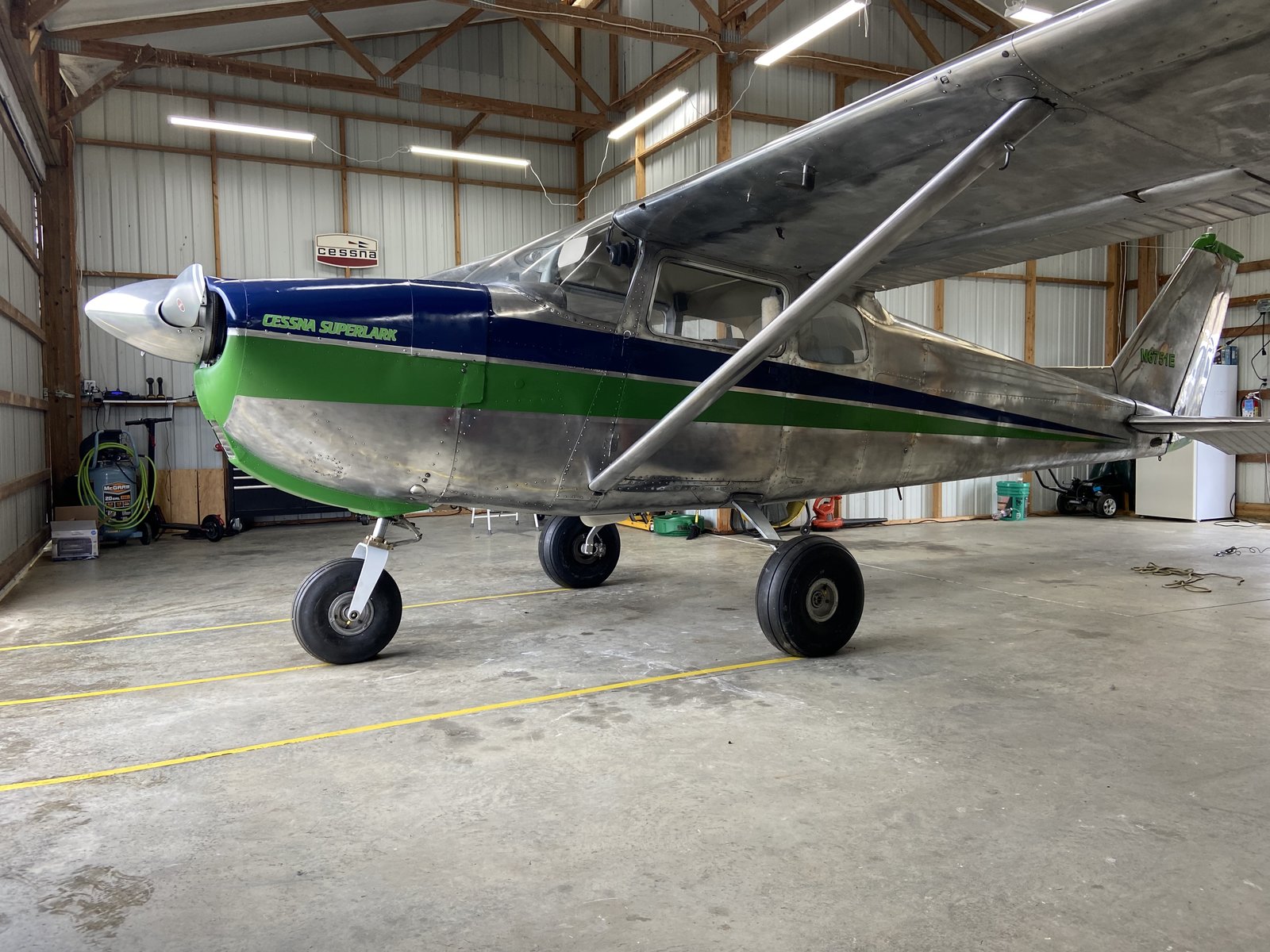

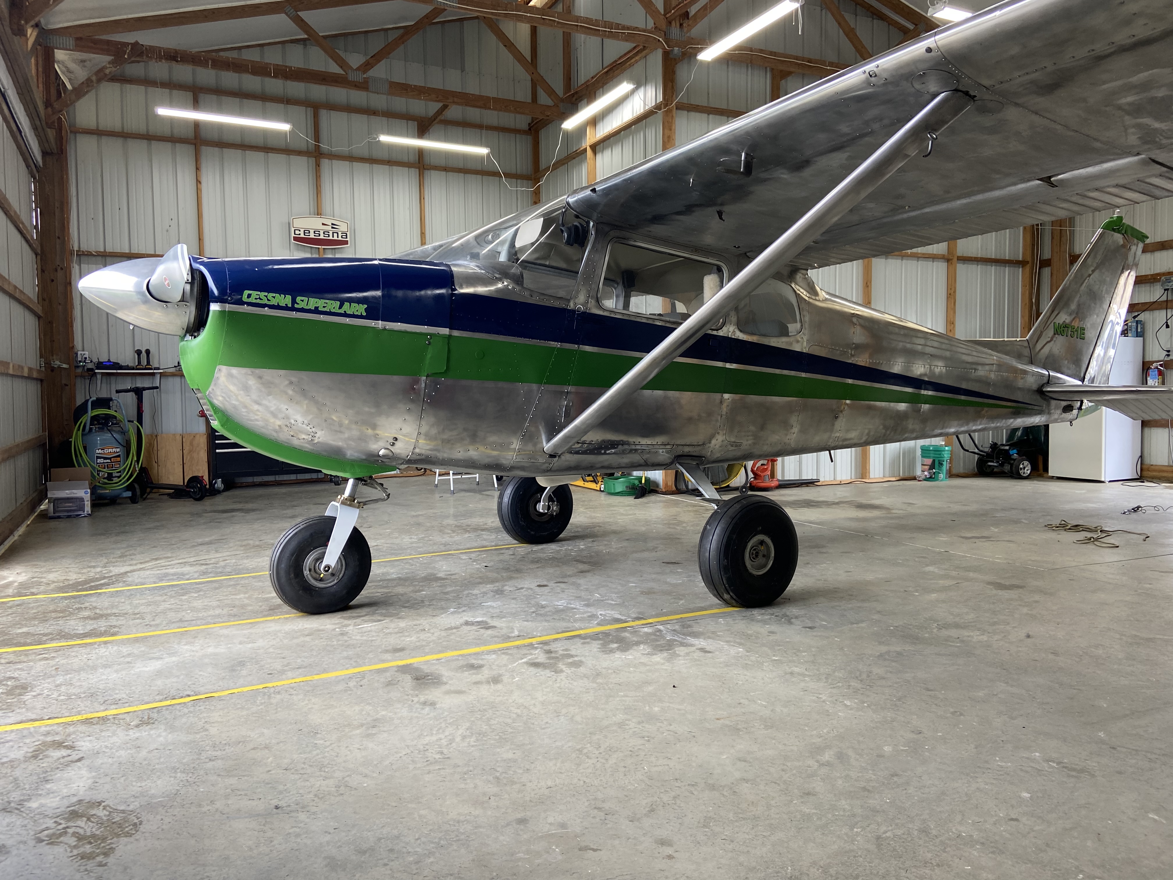

I have a Cessna 175 and just recently installed the Airglas fork. I went with 700x6 tire on the nose with 850x6 mains.
I’m not doing any real off airport stuff yet, but on rougher grass strips it has performed well. That’s the only combo I’ve tried so far, so I have nothing to compare it to though. I may try the 600x6 on the nose and see if it makes any difference speed wise which I doubt it does.

Here’s a photo

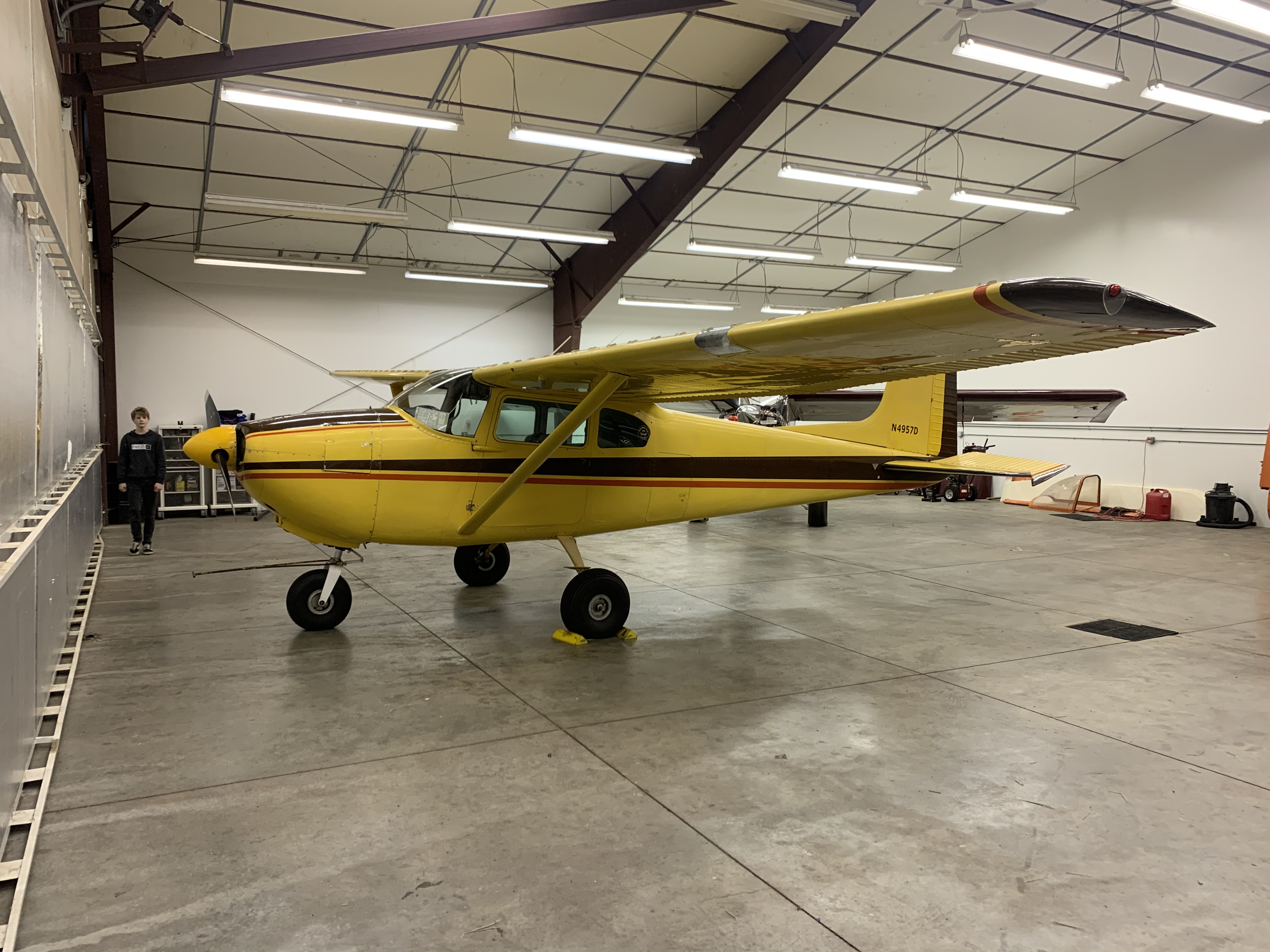

This is a student's 75 P model with the mod recently done. 8.5s on the mains and 8 on the nose. The Airglass fork is really well made and durable. Not a cheap mod though - I was surprised at the total cost - but this also included 2 Goodyear 8.5 tires plus about 20-25 hours labor for the install. Worth it if you are taking your 182 into some rough strips. I am not sure what the difference in prop clearance is now - but enough to worry a lot less and it looks great.

Nice looking machine, is that at Keyway?

Nice looking airplane Halestorm and yes - this is Keyway on a beautiful day and Jay is a great guy.
