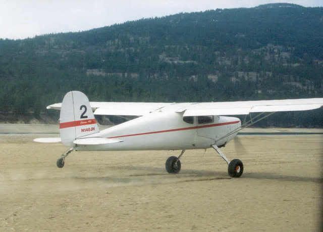

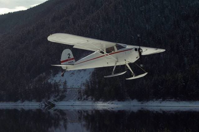

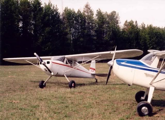

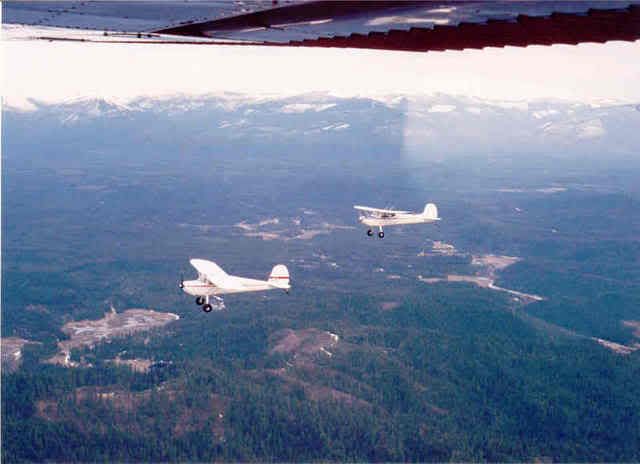

Re: An affordable high mountain airplane?
hotrod150 wrote:There was a pretty good article about this very thing in the C120/140 Club newsletter some years ago. The author was looking for an airplane suitable for mountain flying and camping, but like a lot of us was on a fairly tight budget. After some soul-searching and airplane hunting, he ended up with a C140 with a 125hp O-290D engine upgrade. It already had some good mods (c150 seats, Cleveland w&b, Scott t/w), so all he had to do was strip some stuff out to lighten it up then repitch the prop flatter and add a VG kit, 850's, and a lightweight starter & alternator. He ended up with an airplane that met his needs pretty well for minimal cost.
I believe I know the plane you are talking about, my dad and I got to meet the owner about 9 years ago out in Idaho. It's got the 135hp O-290D2 and my dad's 120 has the 125hp O-290D. Both of them are surprisingly good performers. I would have ended up with the 120 if I didn't have the need to carry more stuff. I got about 20 minutes in the left seat of that 140 and the VG's do make a noticable difference in the slow speed ability, the flaps might of had a little effect too as I was just used to the 120 with a clean wing. Both planes will cruise at 125-130mph on less than 7gph and climb performance is pretty impressive for a small Cessna.
robw56 wrote:...I believe I know the plane you are talking about, my dad and I got to meet the owner about 9 years ago out in Idaho. It's got the 135hp O-290D2 and my dad's 120 has the 125hp O-290D. Both of them are surprisingly good performers. ..................
Yup, N140JH, that's the one. A few years after I read that article, I met his son-in-law Kelly who at that time owned a lightened-up fat-tired C170B. He helped me get a field approval for a C185 jump seat in the back of my old 170.
Rob, I think you've posted that last photo of your dad's airplane before. Where is that-- on the Columbia somewhere? Looks like a cool spot.
