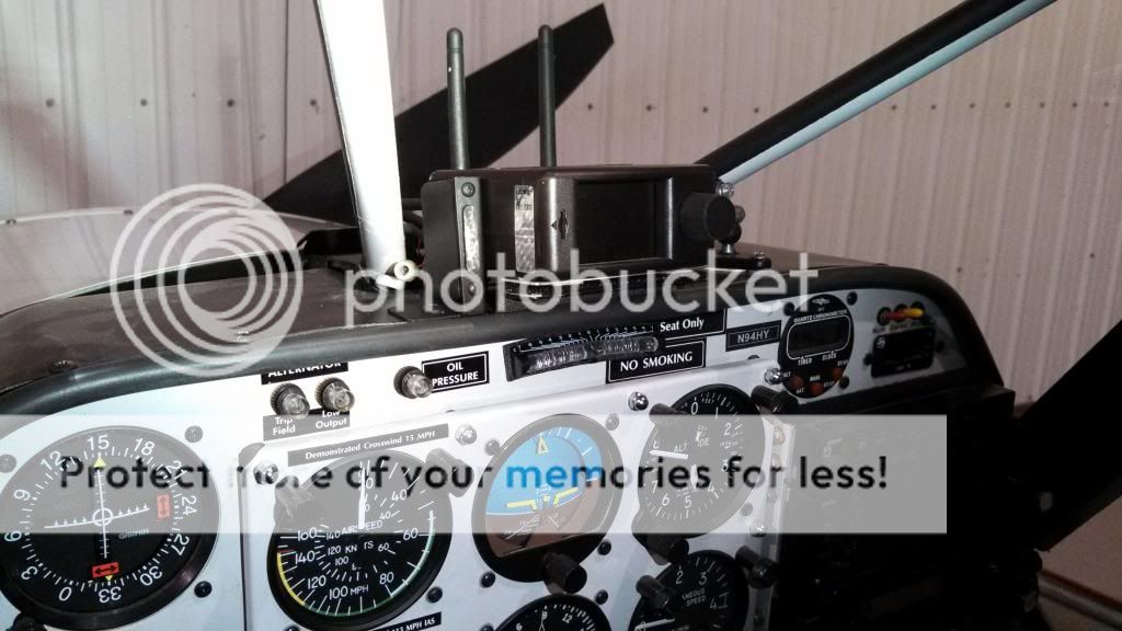

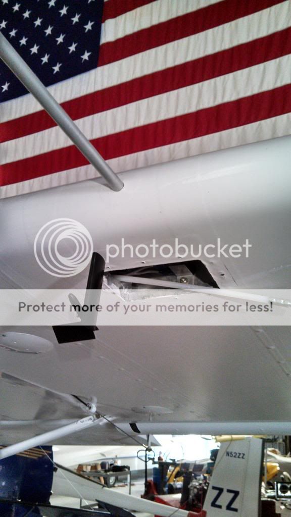

Here's where I installed the CYA probe on my Husky:
The display is just to the left of the PowerFlarm (PCAS, ADS-B in, and glider anti-collision) at the center of glareshield.
I've flown with it twice now. Works amazingly well. Display increments precisely with no jittering. LEDs are bright and easy to see in peripheral vision (haven't tested auto-dimming night time feature yet).
