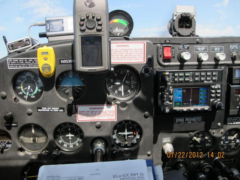

The first time I saw a Lift Reserve Indicator, I had the same reaction--why? After all, I had a good ASI and a stall warner, and I'm a pretty good seat-of-the-pants pilot.
Then I had a long conversation with Mark Korin, the owner of Alpha Systems, who make an updated version of the LRI while at OSH. A couple months later, I made a bone-head take off from Marble, and although I survived my own stupidity (only because I'm an exceptionally skilled pilot, of course :)), I thought it would never have happened had I had an AOA in the airplane. I decided to get the Alpha Systems mechanical version, but with the heated probe.
My indicator is mounted on the top of the panel, where it's easy to see with peripheral vision--I don't stare at it. There's no connection to audio, although that would be helpful in many cases, I suppose--that's available with Alpha's electronic versions. Here's a pic of my panel before I replaced the compass with a SIRS compass: Image
Since I often fly with varying weights, I've found it very useful for being able to land much slower with light loads vs. "book" speeds with full loads. Often we think that the difference won't be all that noticeable in a 4 seater GA airplane, but it is. It also takes all of the guess work out of pitching up at very high density altitudes, such as making a bonehead over-rotated noon take off from Marble. Consequently, I've become a bit of a proselyte for AOA indicators--several posts on this forum and on others.

Man that's a lot of clutter :D what's your office desk look like :shock:
