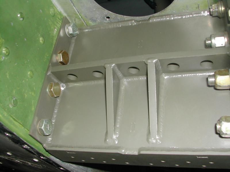

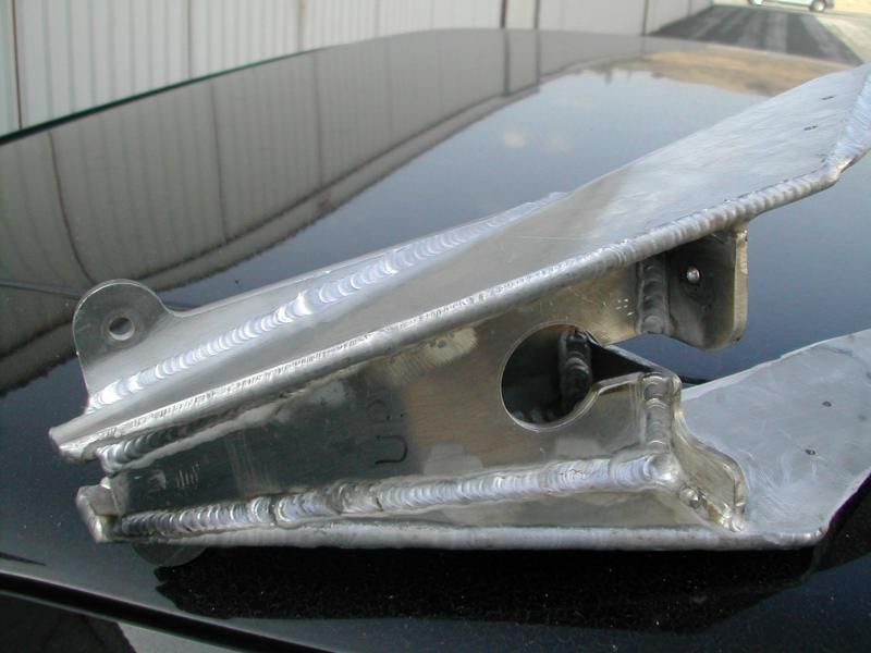

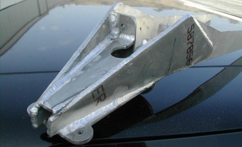

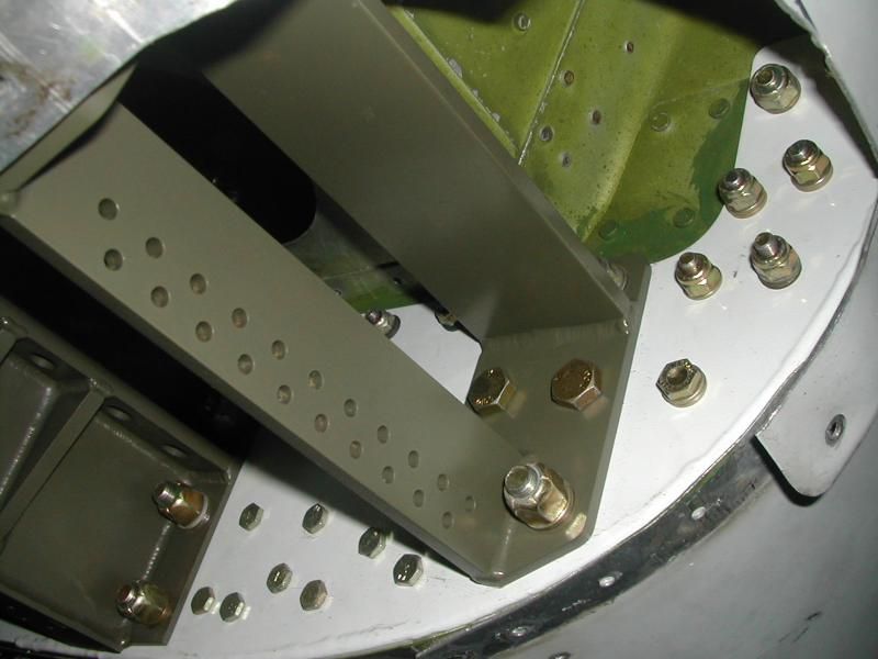

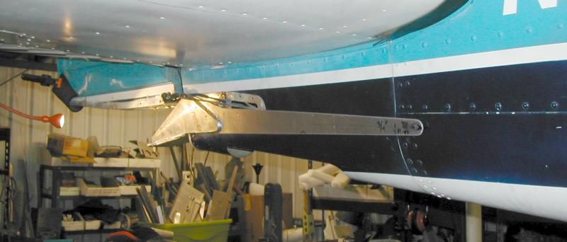

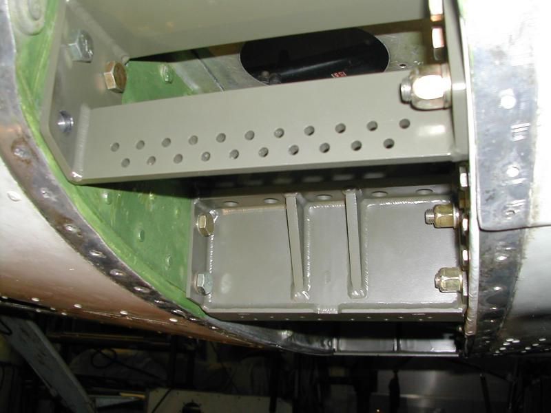

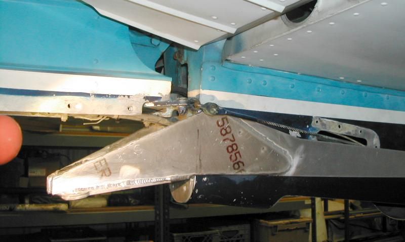

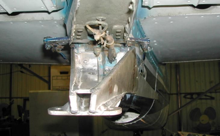

For those of you interested in the progress on the Fravel SportHawk/TundraHawk 172/175 tailwheel conversion, here are a few photos. I promised I'd post when there was something significant to show. I never figured out how to embed photos in a post, so I put them on photobucket and pasted the links. The forum admin is welcome to wave a magic wand and embed these photos in this post at his discretion.
These photos show the brand new prototype welded aluminum fuselage reinforcement doubler/tripler assembly and integral tailwheel spring mount bracket, just completed today. This will replace the old 170/L-19 "alligator bracket", and/or the rectangular strap doubler and riveted (Cessna part) mounting deck of the later Fravel (and Bolen) conversions. I'm sure you will agree this unitized and thickened assembly is stronger, tougher, and even prettier. After two re-designs and making it out of two thicknesses of metal, this complex part weighed in at only 2 lb. 8 oz., while still having over 1/4 inch of wall thickness at the locations of maximum shear and fastener load!
Also shown are the inboard and outboard main landing gear brackets installed on the test aircraft, as well as the integral bulkhead reinforcement and structural skin flange. Note that I have left room on the inboard bracket shear wall for the owner to install the PPONK reinforcement block at their discretion.
Comments, questions, discussion, etc. are welcome. No, I do not know when I can sell you a kit.

Bill, tail mod. looks good and simple. Great workmanship.
macktruckfarm offline
Posts: 139
Location: Longmont, CO
Re: Announcement re: Fravel 172 Tailwheel Conversion STC
Those look like hunky weldments...wow! Looking great...

Looking good, Bill!
