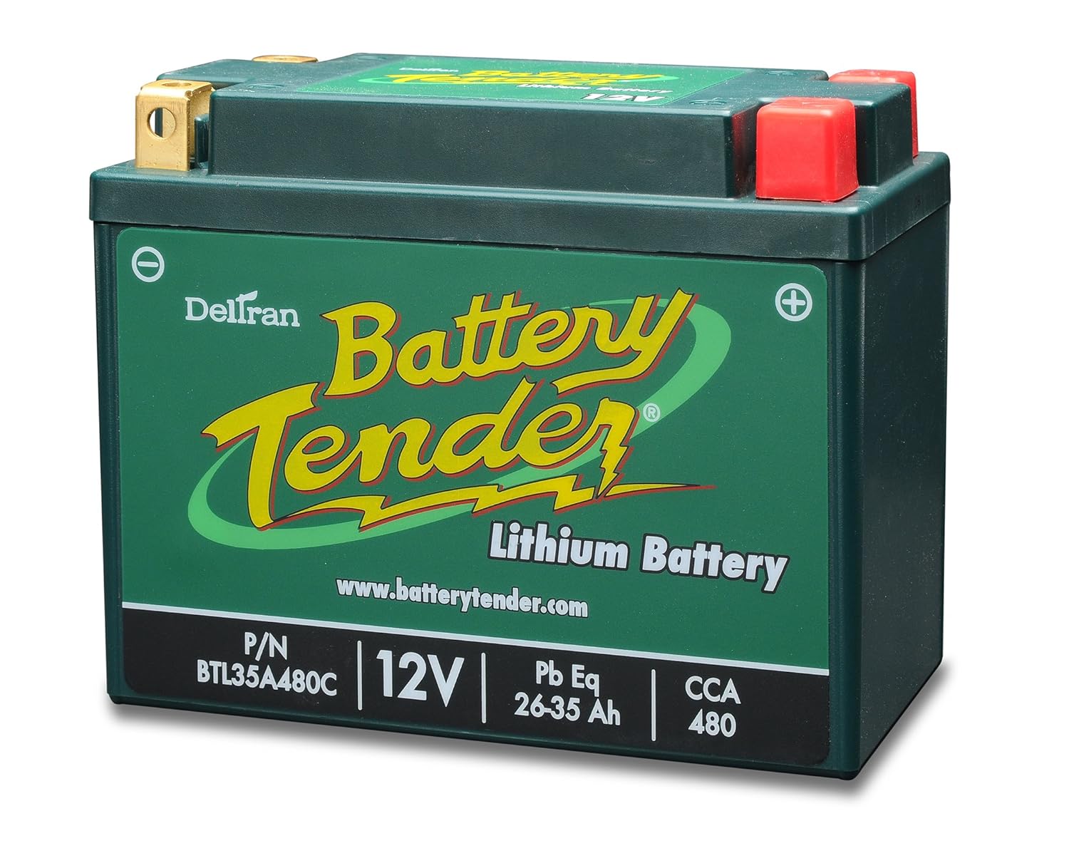

I'm expecting this in the UPS truck in a couple of days, going to give it a whirl and see what happens?
M6RV6 offline
Re: Best Battery
That looks interesting. A 3.75 pound battery would be perfect in my Avid! Post up a report on it when you get it installed.

Re: Best Battery
Wow yes 11.5 lbs lighter than the SBS J-16, But its only rated 480 amps cranking vs 680 for the SBS
