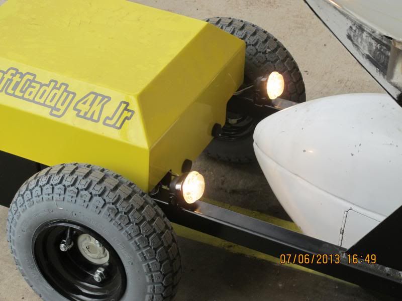

I have an electric tow tug made by these folks: http://www.lindbergh.com/aircraft-tug/index.html. While it's for a tricycle gear, it wouldn't take much for them to custom make one for a tail dragger. Mine is the 4K Jr. They modified it a little to fit properly over the wheel pant, and then I did a little modifying myself, chamfering the connection tubes and adding headlights:
Lindbergh was really easy to work with, and this is a quality product. The nice thing about electric vs. gas is that it's very quiet, and superbly easy to control. The slope into my hangar is pretty steep, and it has no problem pushing the airplane in, even fully loaded with camping supplies. There's a drainage channel in front of the doors, which is deep enough that if the mains are in it, I can't get the airplane to move either way by myself; my tug has no problem pulling or pushing the airplane out of the channel.
This particular model doesn't steer very well, so if that's a consideration, the next model up, the 4K, would be better. For my purposes, though, the limited steering capability isn't a big deal at all.

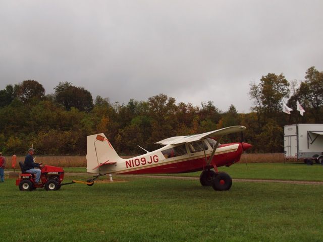

My CFI had a tug that he made which would strap to the mains on the C-170 and the he would hook it up to the zero turn and push it into the hanger no problem.
