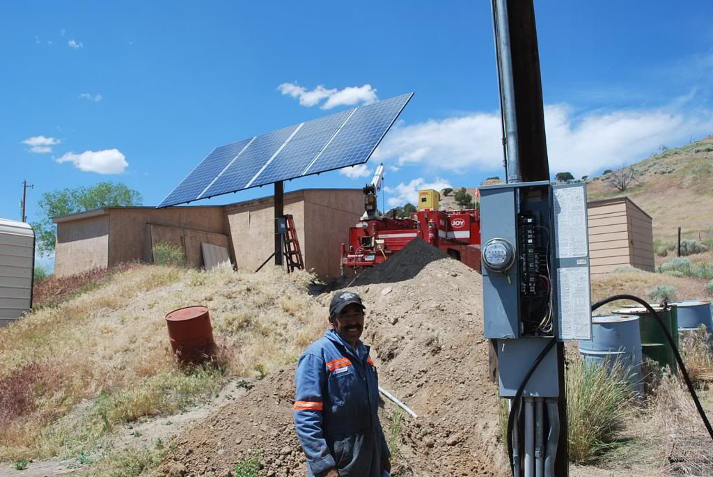

As expected, driving to Elko after flying there a few days before really sucked, especially hauling a wide and somewhat fragile load, this 10' wide by 20 long solar array. A good picture of Mr. Big Bore, Hal, right after we first took his 3 KW solar grid tie system for a test run =D> Image
