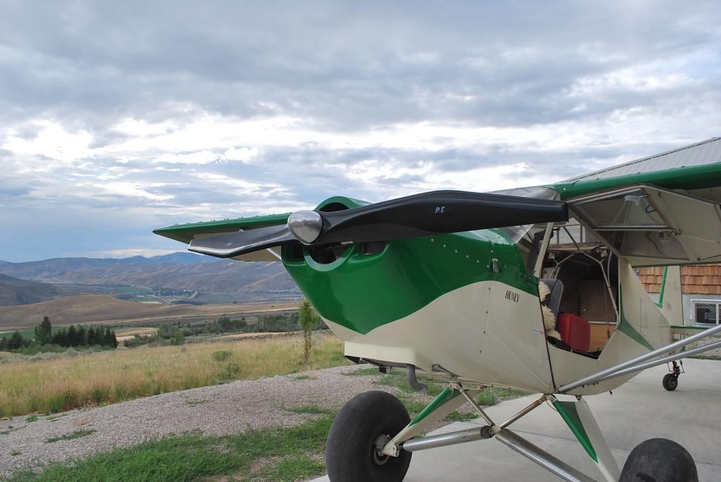

My first Catto prop arrived and I flew with it for a couple hours, and took it off. Sounds bad but I was told to expect it to be a protoype and that might happen. It climbed a bit better, cruised slower and went over redline at WOT. Sounded great though and taxied (uphill) on much less throttle. After I gave Craig the inflight performance numbers, he told me to hang it on the wall and he'll send another more fine tuned one out when he gets back from Oshkosh. He seems to enjoy the challenge of fine tuning a prop/engine/airframe combo, telling me he now knew exactly what changes to make in the design, and seem eager to get back on it :D The man loves his work! It's all black magic to me.
So back on with the Kiev it was for the last 20 some hours, until yesterday, when my new Prince 78" prop arrived. Off with the Kiev and I ran up the P-tipped monster (it's kind of sinister looking, a real bad ass looking black carbon blade, looks like something Batman would fly with) last night but no flight yet due to WX. It also sound great, and different from the Catto, idle down to 1200 (where my throttle stops are) was smooth, that's pretty huge for a Rotax, so good engine AND prop.
The Kiev is still the light weight champ: 7 lbs. 15 oz Catto 8 lbs. 2 oz. Prince 9 lb 12 oz. But, remember the Catto and Prince are sweeping about 25% more area, so in effect they are very close to the Kiev depending on how you work the numbers.ImageImageImage

I flew with the Prince for 2.8 hrs today, and wow, it is nice! The sound......, it's very different, much lower pitched and overall quieter then even the quiet Kiev. This was verified by another S-7 pilot I flew over at various throttle settings, and by taking my headset off. I guess this is in part due to the P tips, whatever it is I really like it.
I did my usual, fired it up in front of the hangar, put the parking brake lightly on to hold it back while idling,then put the headset on and the other numerous things we do to get ready. Then I gave it a little throttle to taxi uphill to my turnaround and do a final pre flight check. Like the Catto it took little throttle to ascend this grade. Then I noticed the parking brake was still on #-o That told me that at full throttle it would probably have enough thrust to get me airborne, to say the least. :roll:
My WOT top speed was 107, real good for a fat tired Roberts gear mod equipped S-7, with the Kiev it was 102. ROC at 9'000' was 700' fpm, solid and sustained. Lower down, 5 to 6, it was 900 to 1100. Again, better then the Kiev or the Warp, or the first Catto. Smooth too. 65 mph was 2.2 gph fuel burn and a bit over 4K rpm, and super quiet, a great sightseeing mode.
BUT, I was only able to get 5000 static runup, and even at 107 mph it was only 5620. I need an additional 200 rpm on both ends to be within the best operating range of the 912, and I confirmed this with Hal and others. So close, very close, and though I was loath to let it slip through my fingers, I took it off and sent it back to Lonnie so he can shave a bit off the tips (or however he does it) to let it rev up that last 200 rpm. It should be a monster prop then =D> I put a note in the box, a followup to my earlier email, stating the request for more rpm, along with a demand that he not change the sound it makes, that is perfect 8)
