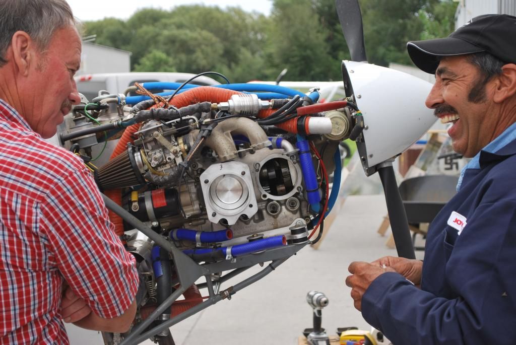

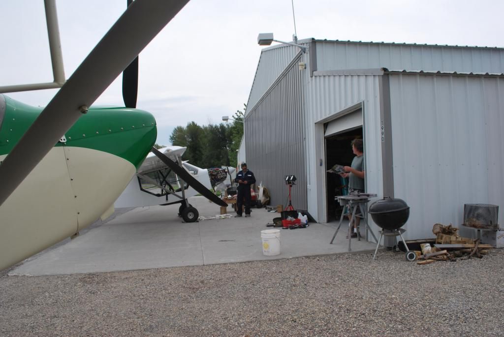

Hal flew up from Elko today, to do another installation on another S-7, in Blackfoot, about 30 miles from my place. I had just flown into a rancher's place about 50 miles away, (straight line, almost a 2 hour drive due to mountain ranges being the way) to talk about a solar system for his place, landing in a gravel pit across the road. 2 hours later (mission accomplished, sold!) I blasted off and stopped by to see how things were going.Image
He was already half done, and by now I'm sure it is flying. This 7 had the 80 HP Rotax, and the performance difference will be huge. He went with the same setup I have, (1484, low comp pistons) and I assured him that at our field elevation REGULAR mo gas is all we need and in fact all I now use. E10? Bring it on.... I've been using it also, when "on the road". I'm expecting a flyby tomorrow AM as Hal heads back to Elko 8) ImageImage We had 3 S-7's parked outside, and two more in the hangar still under construction :shock: Image

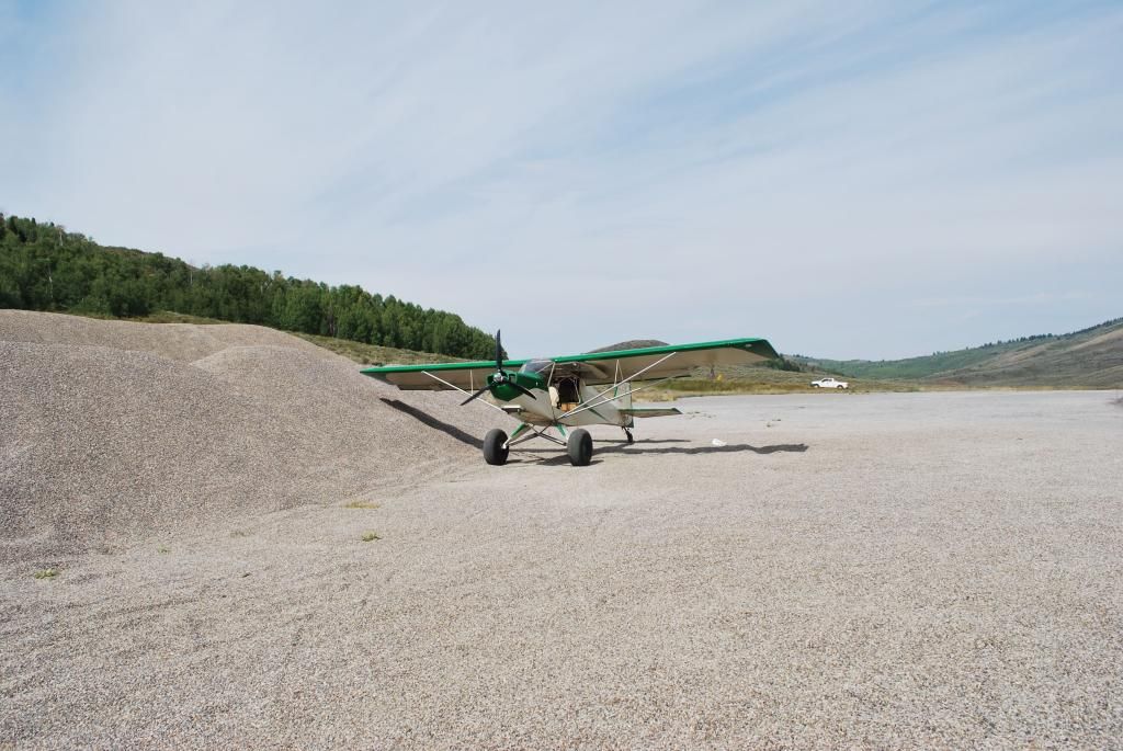

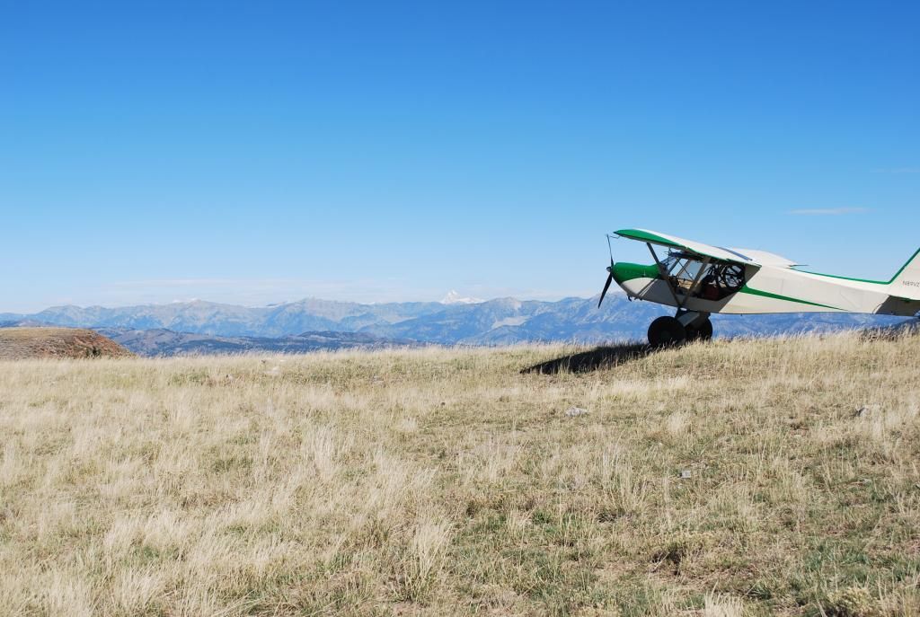

I had a takeoff out of Alpine Wy. yesterday, (about 6K) and held it pretty much full throttle, knowing I was going to eyeball a nearby 8400' ridge for an LZ. I rarely use full throttle, and when I do I very soon throttle back, I'm happy with a 3 or 400 fpm climb and the resultant much lower fuel burn. But this time I let 'er rip.....damn, I was over 8K before making it all the way across the lake, and it just seems to want to keep climbing very strong even at the higher elevations, and effortlessly. And that is with the little 70" Kiev =D>
Landed the ridge BTW, another site where if I step back to get more of it in, I step down, and soon the perspective is all screwed up, this picture doesn't do justice to the site, though it does have a nice background. Image
