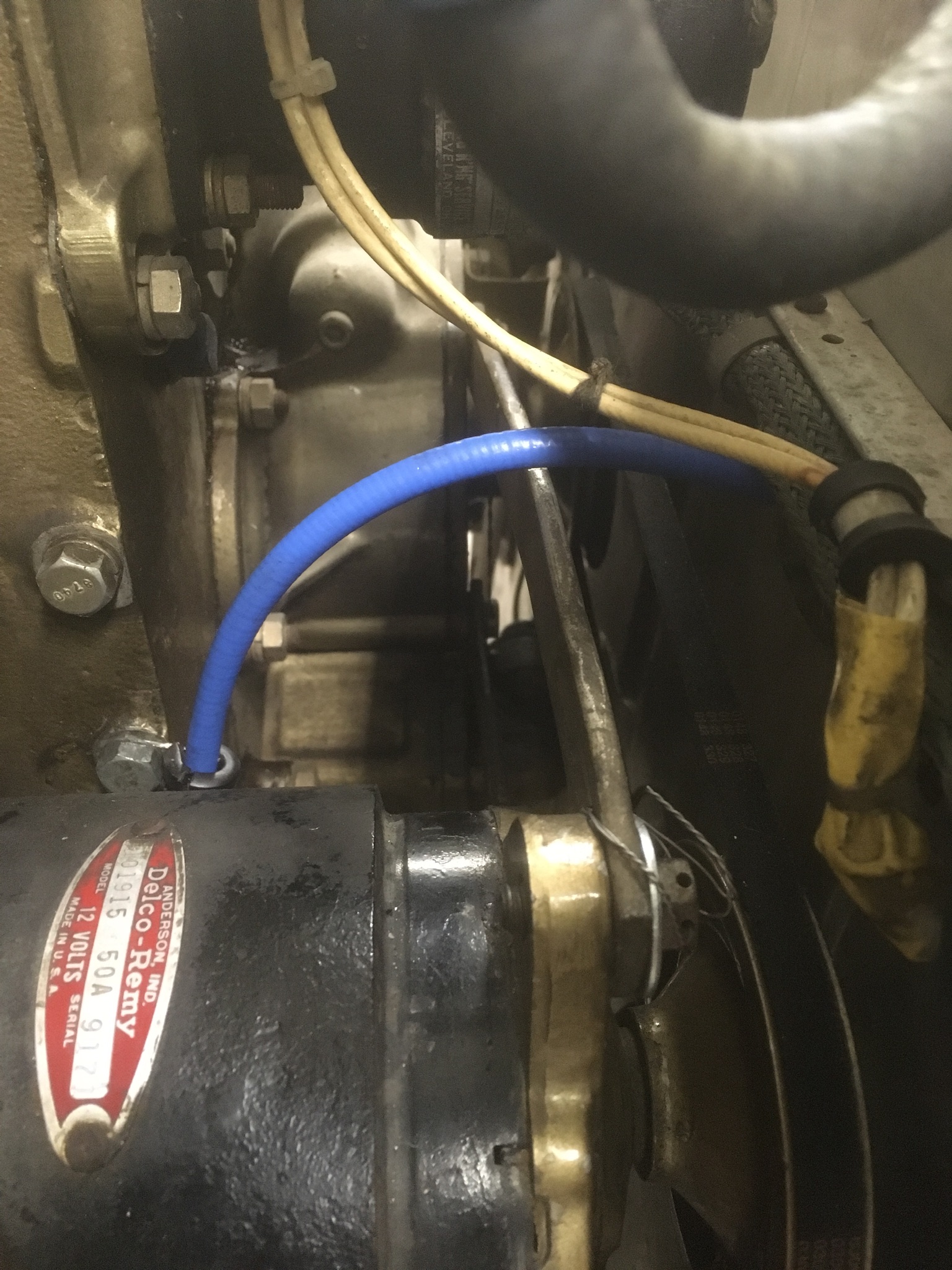

BirdyinBOI wrote:..I found a couple pics of where my old throttle cable came through the firewall and down to the carb. My memory was incorrect in that I thought it turned up and went up alongside the vacuum pump and then made a loop back down. Not correct. It just exited the firewall and went over the tensioning arm of the gen and through a clamp on the side of the case. Since there’s no loop over/near the vacuum pump the cable I have from McFarlane (42”) may be long enough. This look familiar to you?.....
Here's mine, looks about like yours.
Coming up a little out of the firewall helps to keep the radius larger for the turn down toward the carb.

Thanks hotrod. Looks pretty bare in there with no vacuum system! My goal...

Well, got the throttle cable in. A tighter loop than I imagined but it came out the perfect length. The prop cable, now that’s another story. I’m still baffled over the correct routing. I need to find another ‘57 or ‘58 and crawl under the panel to see.

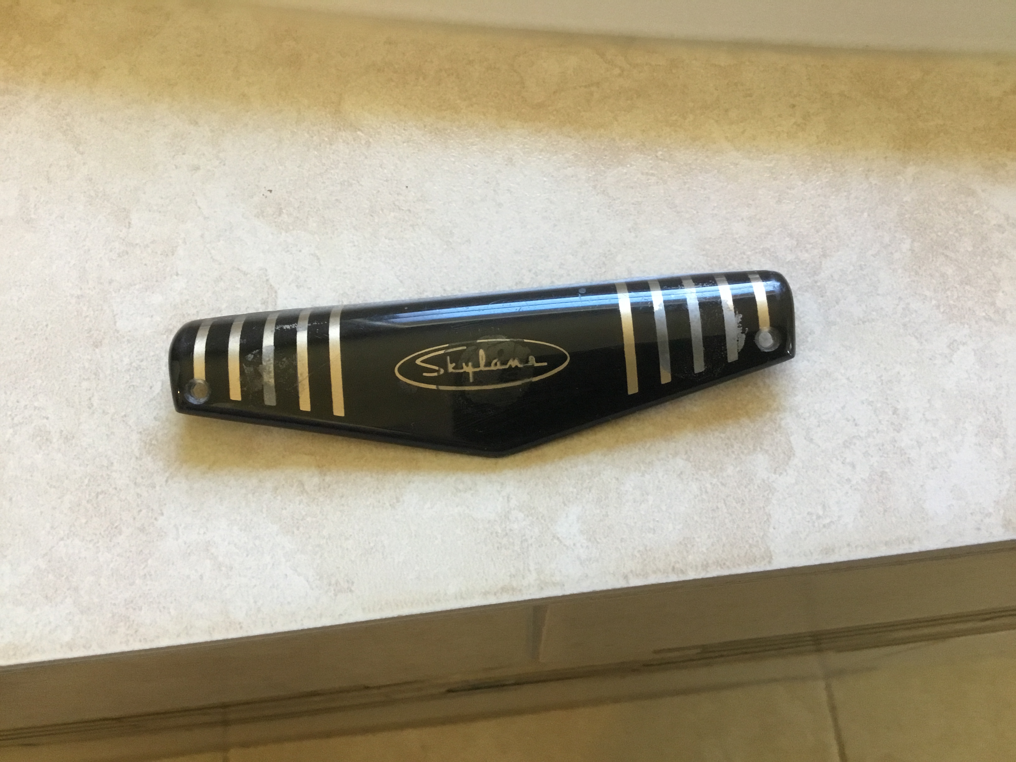

Yoke Emblems...
Anyone got one or two of these they would be willing to part with?

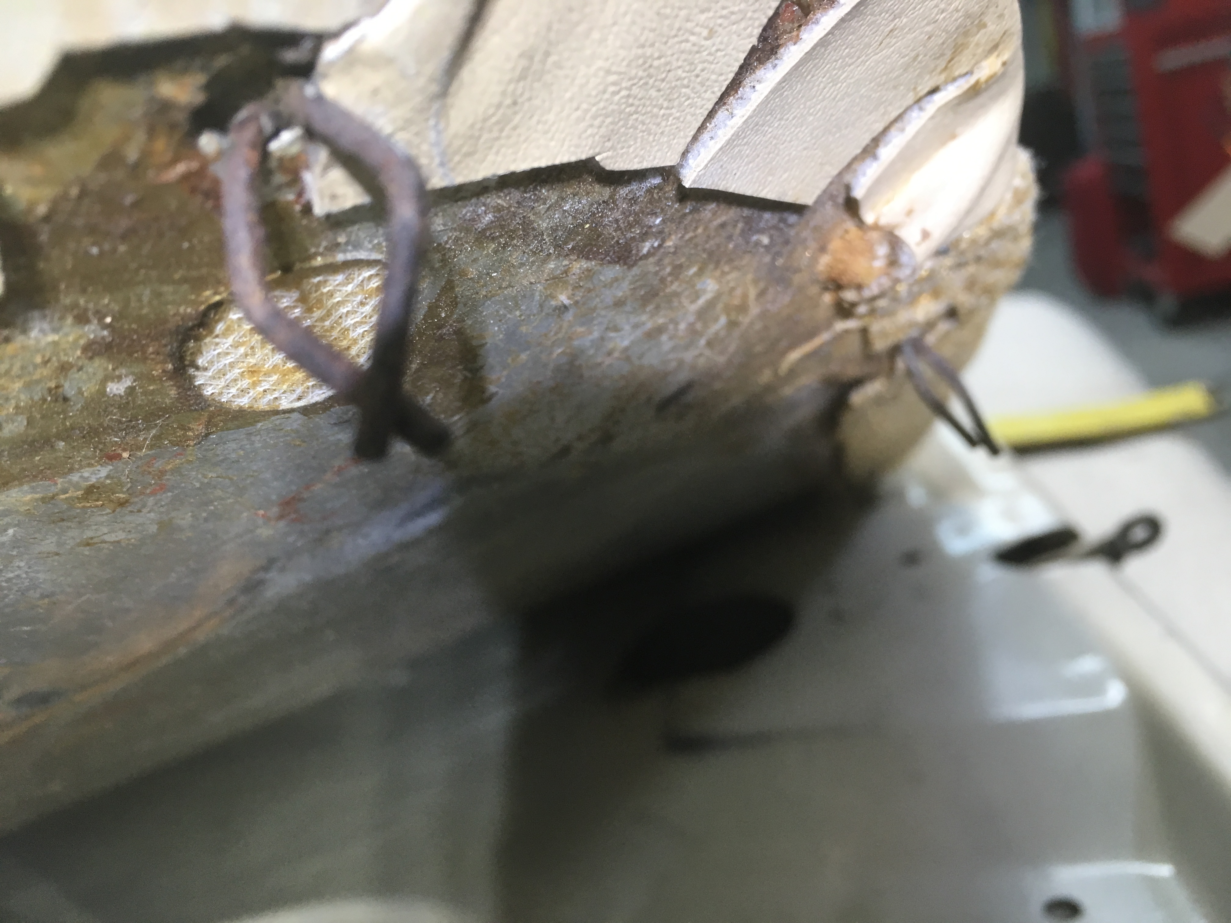

Anyone know where to get the wire door panel clips that hold our door panels on?

Look here, they have a selection. I had a devil of a time finding them initially.

Search 1967 or so "Ford" door panel clips on Ebay, Amazon, etc. Also, local NAPA has a big "book" with actual clips attached to the pages for comparison. IIRC, they offer them also.

B and B aircraft supplies. I bought a couple of small bags full for cheap. Probably paid less than $5.00/20+ which is probably less than you will pay for one through a Cessna dealer.
They were the wrong color but I just pushed them all through a piece of cardboard and sprayed them white with a rattle can.

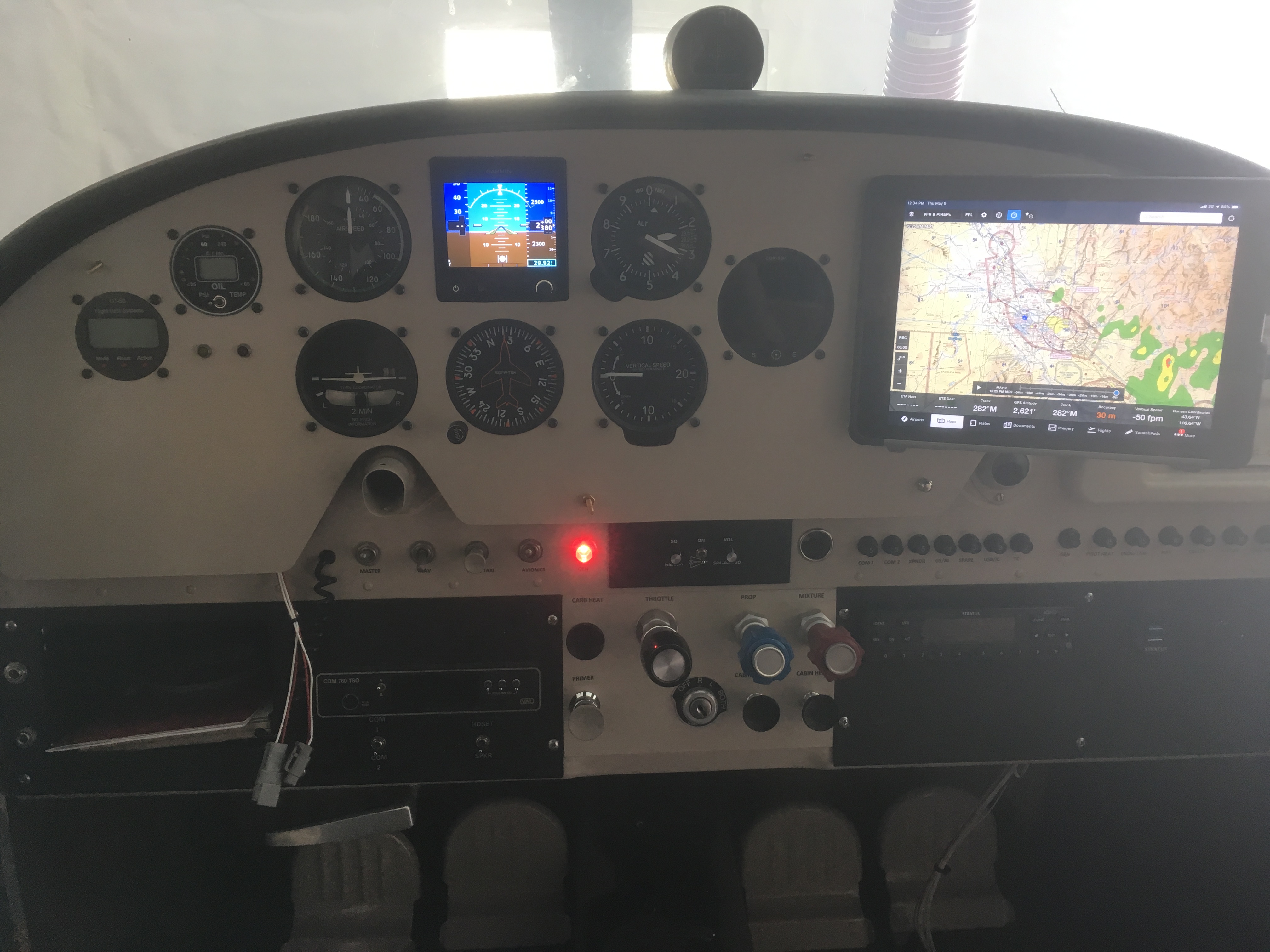

Almost finished. 5 months. (Yea, I’m slow) CGR is next to iPad.

Looks good. When I was looking at your previous templates I was going to suggest making sure you can get a second G5 under the first. Originally the DG looked a little too close to the yoke. Looks like you made it work though.

I think a second G5 would fit fine. The real obstacle is the panel brace that starts above the yoke hole and goes up to the firewall. That's the reason everything is set to the right and to allow for the 6-pack.

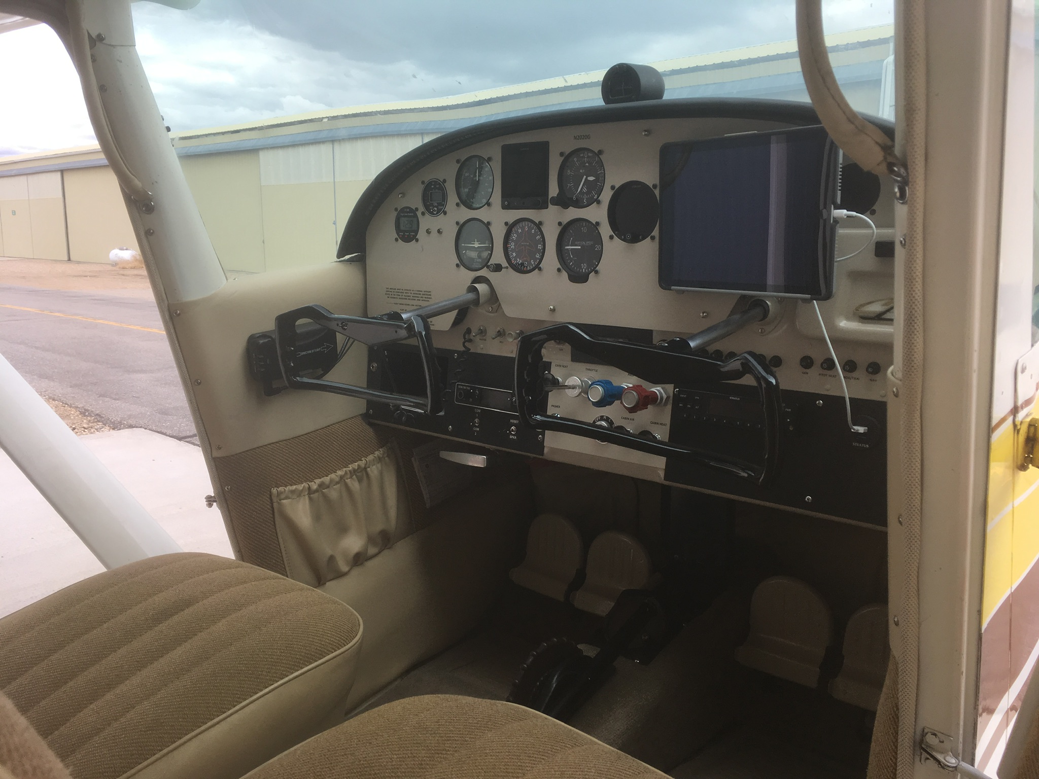

FINALLY FINISHED! Well, what started out as a “modest” instrument upgrade and panel rebuild turned into a 6 month project that finally saw 20G airborne once again last Friday for an instrument check and ADS-B certification flight. I’m really happy with the results but I would be remiss if I didn’t give credit where credit is most certainly due.
