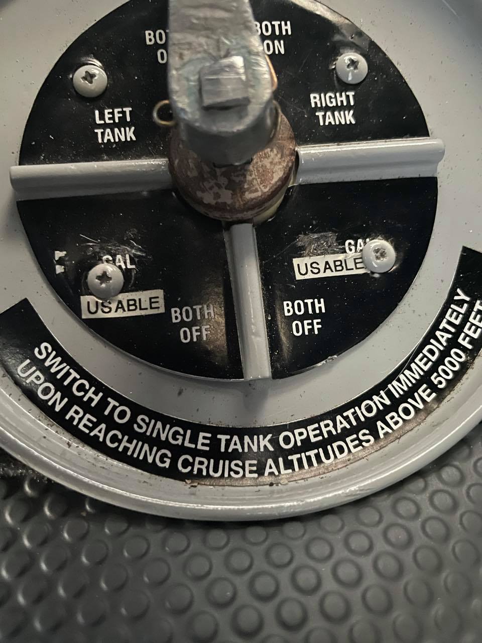

Why is the 170B equipped with an electric fuel pump and not just gravity fed like the 182?
Also why the need to switch tanks at cruise above 5,000ft?

Re: Cessna 170B fuel system.
I have never seen that "Switch to single tank" before in a 170, converted or not. No mention of it in the Delair STC.
https://rgl.faa.gov/Regulatory_and_Guid ... enDocument
This AD is specific to 172s, but I've heard people say the 170 fuel system is identical. I had a T-41B with the same placard, so they may have expanded the scope of the AD with some other action.
jcadwell wrote:https://rgl.faa.gov/Regulatory_and_Guidance_Library/rgAD.nsf/AOCADSearch/2C7B32477D2A88A286256A340063355D?OpenDocument
First, that is a Service Letter, NOT an Airworthiness Directive. Service Letters are "suggestions" under Part 91 operations. Mandatory if you're operating under Part 135.
Also, it doesn't apply to the 170, though, as noted above, the fuel systems are pretty similar. That said, please read the Service Letter completely.....they tried to duplicate the "condition" and couldn't do so without actually injecting additional air into the tanks!!! Good grief.
Back then, Cessna was being sued right and left, often because of their fuel tank design, which can make it difficult to get all the water out of a fuel tank. That caused a number of accidents, and resulted in the new 172s having something like 16 sump drains in the fuel system.....
Anyway, I sure wouldn't attach that placard to an airplane other than the 172.
More to the point, fuel quantities, which have been scratched off of that selector, are required placards. I realize that was done because bigger tanks have been added. Nevertheless, accurate placards are required.

Even more to the point it looks like someone has been beating on that selector and shaft with a freek'in ballpeen hammer, yikes.
