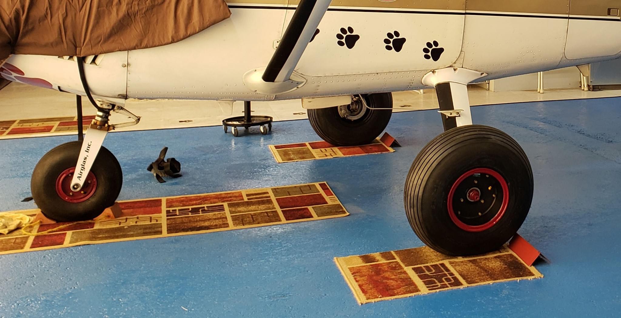

Here’s mine if it helps. 6.00 tire on a heavy duty nose fork. I don’t know what pressure the fork is at. This is with an AirPlains IO-550 conversion.
