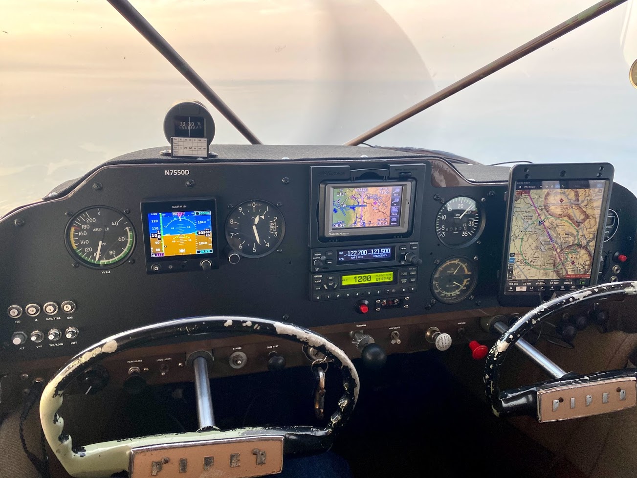

I avoided doing a flush mount so there's not a big hole in my panel that only works with my current tablet. A RAM ball or alternative makes upgrades much easier. I ended up going with a Pivot case (https://flyboys.com/products/pivot-mini-5th-gen) and the Pivot AMPS plate mount (https://flyboys.com/products/high-defle ... -ppk-1-kit). AMPS hole pattern is an industry standard, so if you want to change mount in the future, that's easy too. Not a 182, but here's my setup over the copilot yoke. No issues with glare, easy to use/view, and looks much cleaner than my old yoke mount.

kevbot wrote:I avoided doing a flush mount so there's not a big hole in my panel that only works with my current tablet. A RAM ball or alternative makes upgrades much easier. I ended up going with a Pivot case (https://flyboys.com/products/pivot-mini-5th-gen) and the Pivot AMPS plate mount (https://flyboys.com/products/high-defle ... -ppk-1-kit). AMPS hole pattern is an industry standard, so if you want to change mount in the future, that's easy too. Not a 182, but here's my setup over the copilot yoke. No issues with glare, easy to use/view, and looks much cleaner than my old yoke mount.
Approximately how far does this setup stand off the panel ?

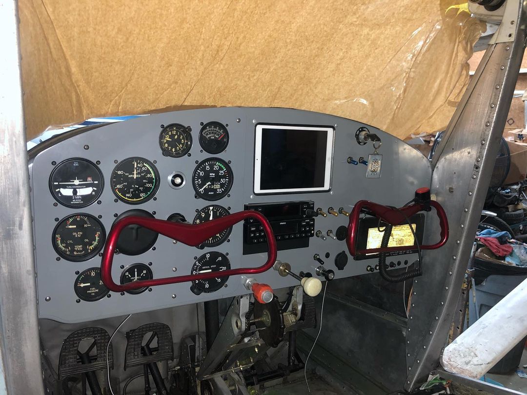

I cant help you on putting it on the copilot side but on my 150 I mounted it in the center with the guardian mount. I would think you would have plenty of room to do the same? Depending on what you do with the radios at least. Reaching over to change anything one the ipad or even looking over to the copilot's side would be irritating to me. I had a lot of mockup time with a piece of poster board and carboard cutouts the same size as my radios to see where everything fit best. And of course I ended up getting new radios so my radio hole is bigger then it should be now.
