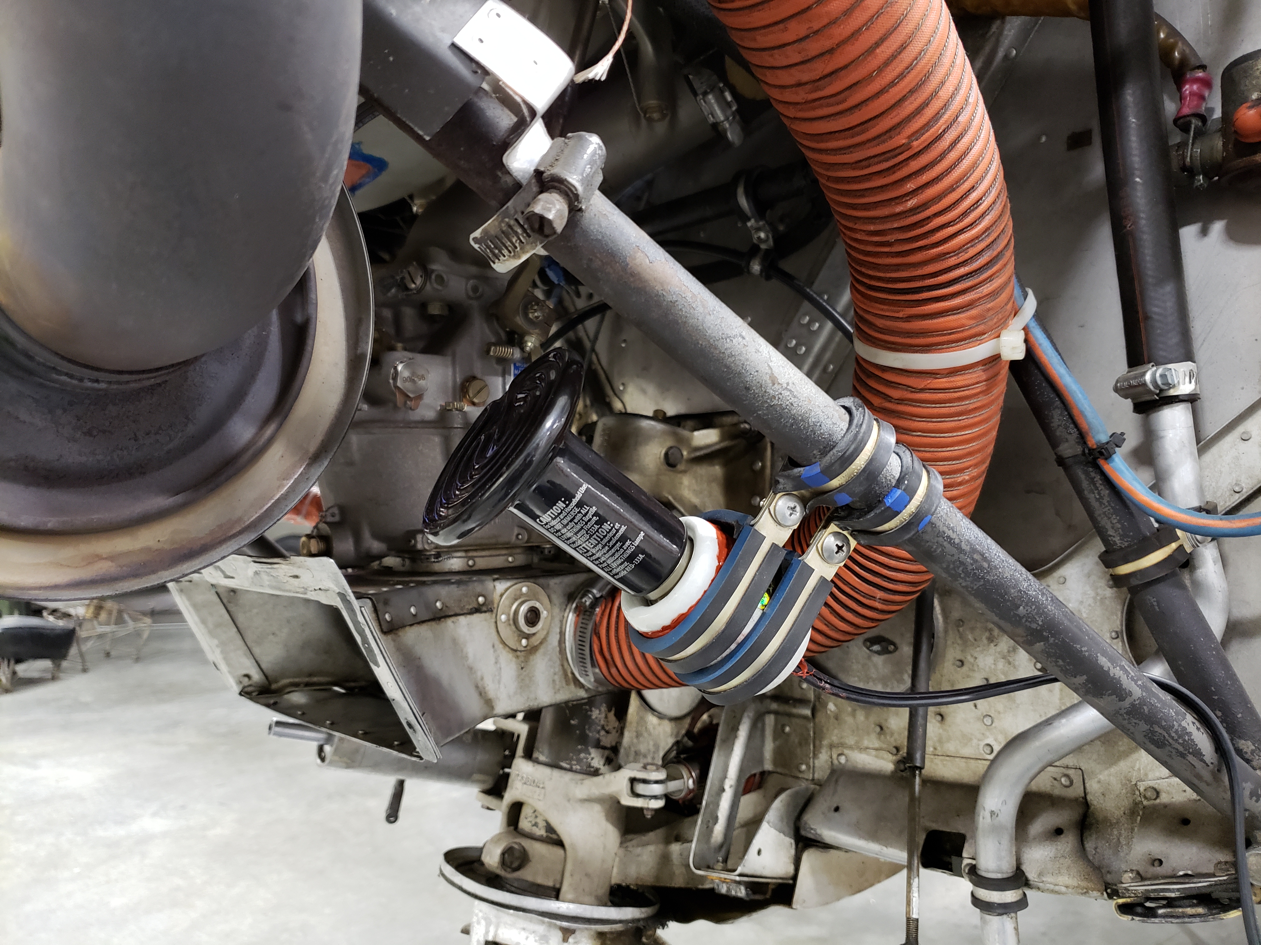

I'm just gonna leave this here. Been using them for years now. 150w infrared reptile heat lamps (one on both sides) and a 250w oil pan heater. Gets everything from 0 to 40F in 3 hours with a blanket on, 60F in 4 hours, maintains 80F plugged in overnight. I haven't tested it in severe cold yet. The bulbs are $28 at a pet store and advertised to last 20,000hrs.
*Edit* I get the temp data from my engine monitor. EGTs and CHTs are usually within a few degrees as the engine heats up. The bulbs are aimed at the collector on either side of the muffler.

Reptile heaters, that's clever, but the zip ties on your engine mount are freaking me out. Especially the extension cord. That one is high risk to cut through and short some mains power right next to your engine mount.

akschu wrote:Reptile heaters, that's clever, but the zip ties on your engine mount are freaking me out. Especially the extension cord. That one is high risk to cut through and short some mains power right next to your engine mount.
Hmm, I'll have a look at those the next time I've got the cowling off. The extension cord was installed as you see in the picture by an A&P and has been there for 15 years. My AIH drop lamp sockets don't have super heavy duty cords, but I also have them zip-tied in similar fashion. What's the best method?

born2flyak wrote:I'm just gonna leave this here. Been using them for years now. 150w infrared reptile heat lamps (one on both sides) and a 250w oil pan heater. Gets everything from 0 to 40F in 3 hours with a blanket on, 60F in 4 hours, maintains 80F plugged in overnight. I haven't tested it in severe cold yet. The bulbs are $28 at a pet store and advertised to last 20,000hrs.
Pretty cool solution. Thanks for sharing. Sounds like you’ve used down to 0F which is about as cold as I’d ever need.

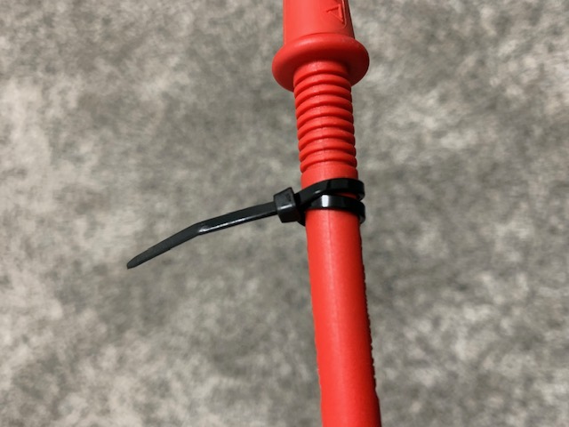

You could even use the doubled zip tie method to relieve the sharp part around the head. Like this:
The problem is that the zip tie in a high vibration environment could cut through that extension cord (or the mount itself for that matter) and then you could have an electrical fire under your cowl.
All that said, you might go 100 years and never have a problem, LOTS of people do, but when it comes to high voltage electrical wiring against critical high vibration stuff, I'd want a little more margin. Your call.

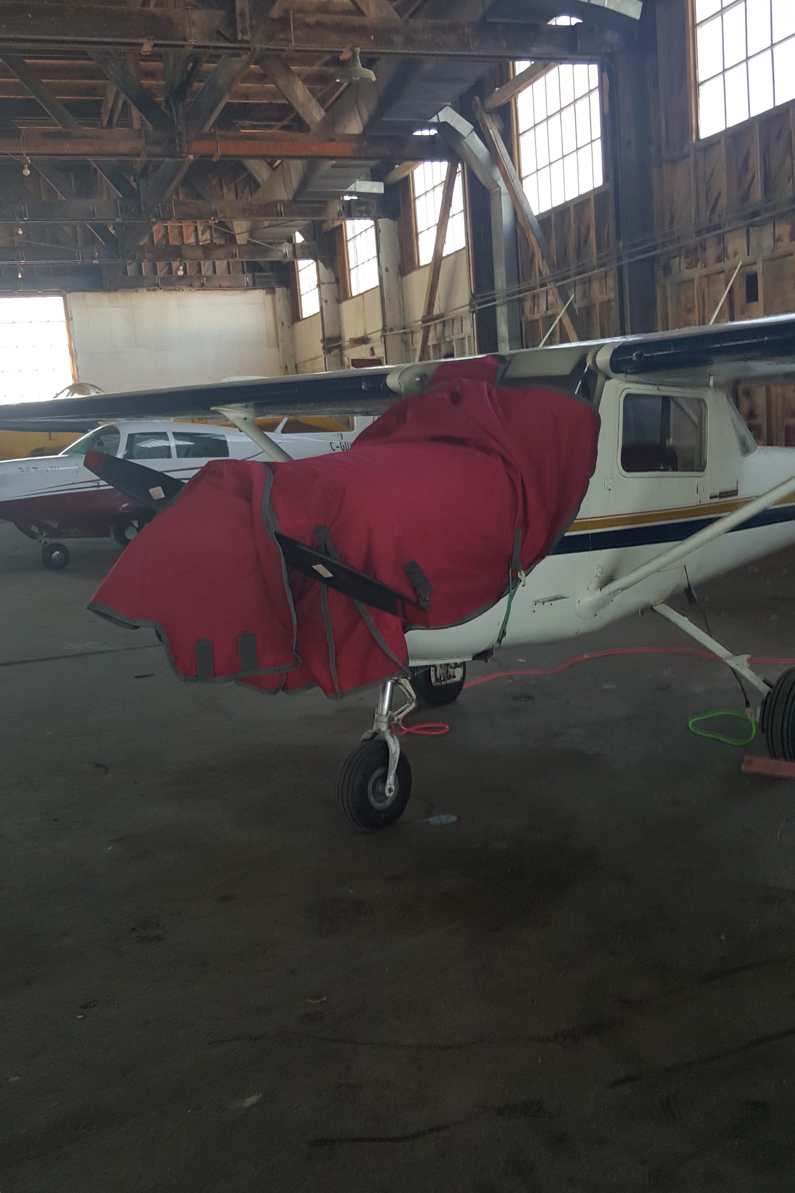

However, I think your right. A Turbo Reiff and a cell switch is probably the right answer. That’s not going to happen this year. We sewed up an engine blanket and with two 100W bulbs on overnight the CHTs and oil are in the 60s the next morning. We’ll get through the winter with what we’ve got.

If you have a daughter with horses borrow one of these blankets from her, she will never think to look in your hanger for it and remember to remove it before you open hanger door if you want to keep it. This horse blanket along with that milk house heater would get engine toasty warm in one hour on high in minus 20 weather.
