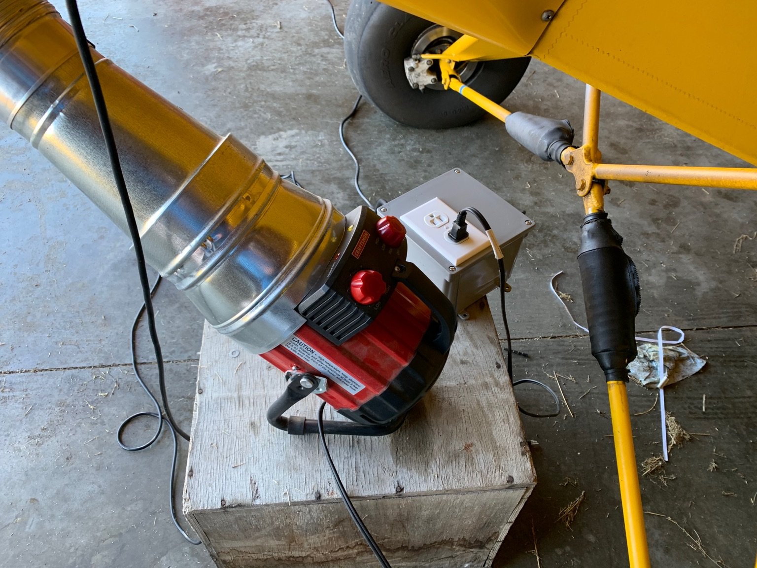

I made my own system. It is a ceramic space heater from Home Depot with a reducer duct I modified with pop rivets and a piece of metal dryer hose. I put it on a timer so it isn't on continuously, but fires up each morning at about 7:00 in case I want to go flying at 10:00. It works fine, but this isn't the coldest place on the continent. The heater has lots of different settings if you want to choose one that would allow you to leave it on continuously.

Flyhound wrote:I made my own system. It is a ceramic space heater from Home Depot with a reducer duct I modified with pop rivets and a piece of metal dryer hose. I put it on a timer so it isn't on continuously, but fires up each morning at about 7:00 in case I want to go flying at 10:00. It works fine, but this isn't the coldest place on the continent. The heater has lots of different settings if you want to choose one that would allow you to leave it on continuously.
I had a similar setup for my 182. I actually had another one for the cabin area. Worked great.

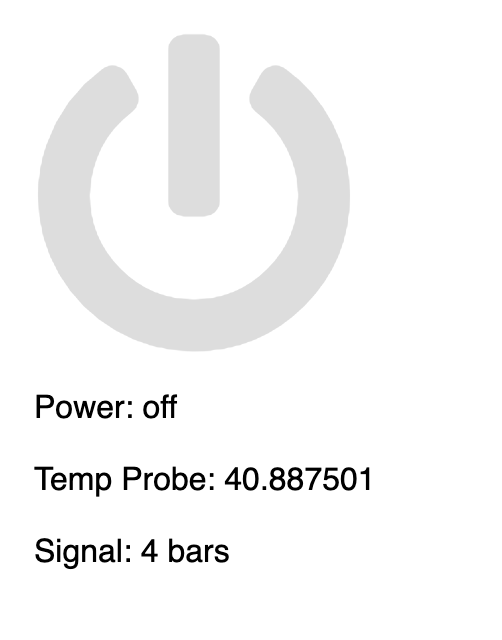

I recently just built a cell backed switchbox and gave it to my bud that has a small ceramic heater:
It's just like any other commercially available switch box where you use and app/website to turn it off and of, except one notable exception. I also include a temp probe that you run up into the cowl. It's the wire you see going vertical over the duct. This gives you the ability to see that the heater is working and it also gives you an idea of what your under cowl temps are before you head to the field.
Screen Shot 2020-01-03 at 4.28.16 PM.png (31.67 KiB) Viewed 1849 times
Looks like his engine is 40.887501 degrees F and the power is off.
So far it's working nicely for us. Perhaps I should add a feature to turn off the switch if we don't see it heating up in the first 10 seconds.

Way cool schu! I’ll take one. It comes with an app, right?[emoji6]

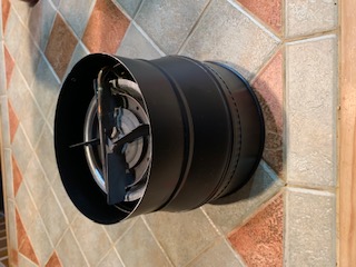

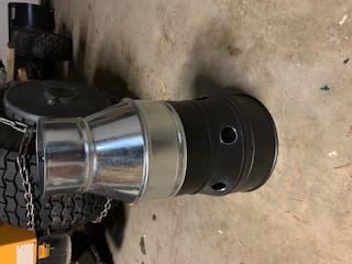

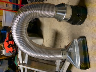

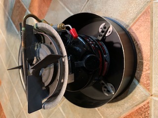

I was grappling with two aspects of heating, in the hanger and on the road. The hanger component has been resolved with a lightweight, propane fueled heater. I have determined that with proper time management I can complete the required pre-heating whilst performing the other per-flight duties, thankfully time is my own and I'm not rushed to depart at all.
So now for the "on the road" requirements, my "inner" McGyer was sparked by an earlier poster on the subject and a recent visit with a very creative local aviation AME. I now have a very lightweight, compact, travelling preheater or better called a "heat maintainer" that utilizes a single burner, dual fuel, camp stove, some simple duct component and a well fitted engine cover. As an added bonus I can warm up a bowl of soup of hot chocolate while I'm wait for SAR should the need arise

This has been a very informative and formative topic for me, thank you BCP's.
