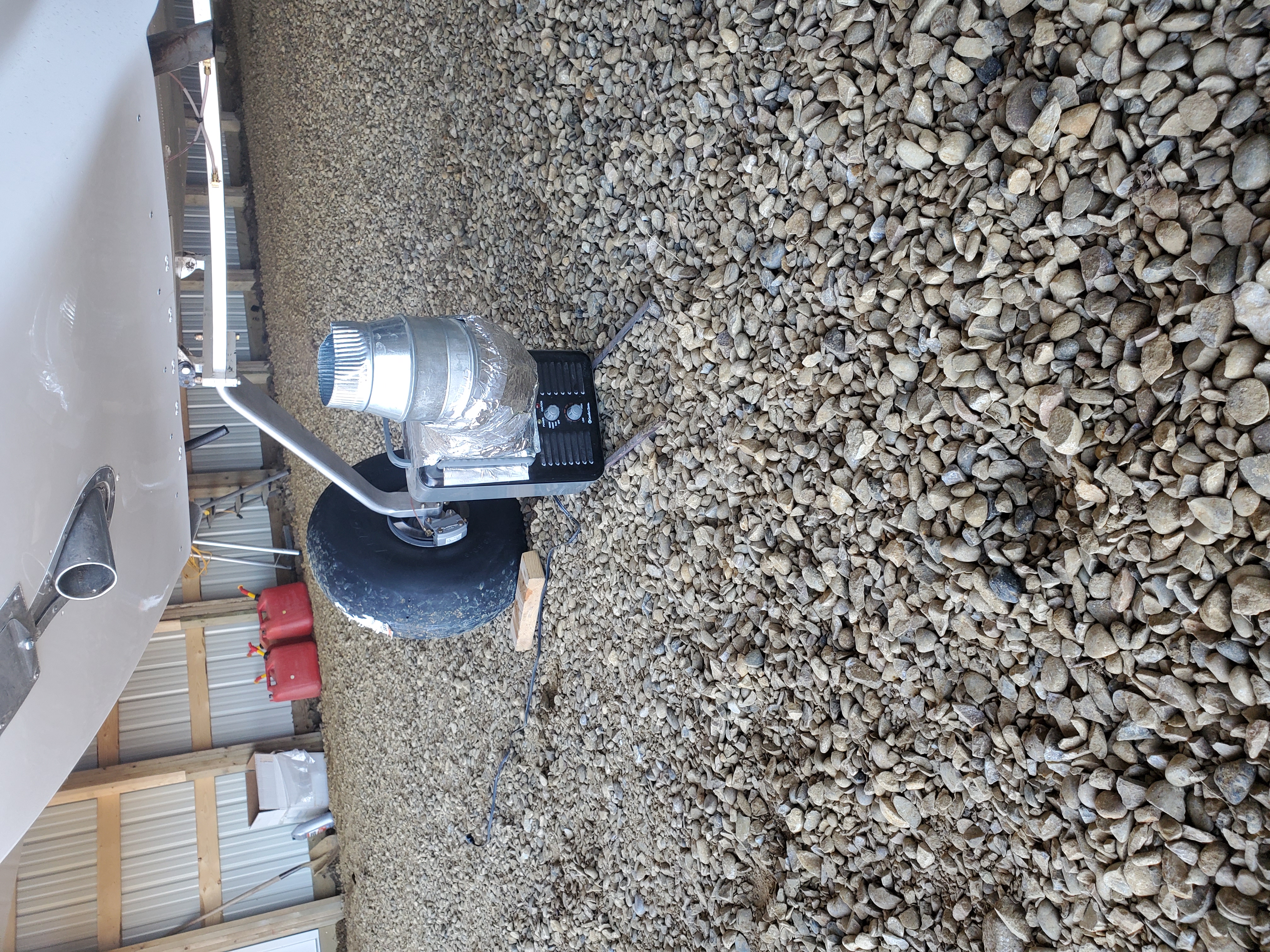

Re: Forced Air Engine Pre-heaters
This is a milk house heater it keeps engine warm. I will add extension on it to reach new plane.
